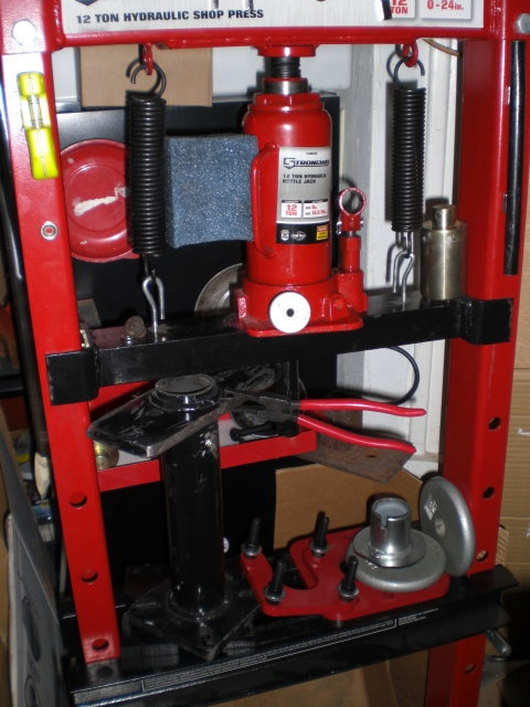

    Looks like your just run it til it dies....anyways......so
    Might get away just changing the inner seal.....might last for 10 or 20k...
    if that lock ring isnt scored or damaged.......wont know til you get in there...
    That would be easy and doable.....not ideal.....
    cost u $10 for that seal and mybe same for that oring....
    Take u about an hour.......

    That could buy some time until you find someone to do it all...
    or acquire the tools..........takes about $300 worth of goodies to do the whole thing....
    As far as his missing stud.....you have to knock one out to use that timing ring removal thing.....
    way freakin better than old way......

    Man usually wouldn't crap out....but this is a pia job....
    and I dont even have the abs......thats an extra trip to the press....for each side....
    coming and going.....each way.....
    And if you u press any step back in too far.....pia and slow going.......

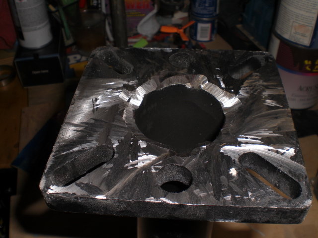

    Now for the bad news .......timmy says toyota changed the seal lips......
    and if you dont use his 'mr coffee' fix ......they will start leaking again.....
    much sooner this time......
    .....watch the vids ......his got three just on this subject.....
    sure glad I watch him before I did mine......dont want to go back.....what a bitch......
    Cant ever sell that tool.....it'll curse me....and need it again......

    Maybe they're confused.......only the seal and that giant o-ring gets compromised...
    If your bearings are good.....I'd be tempted to just replace the seal and o-ring.....
    take u less than an hour and $20 ea side to find out.....
    Big question is did this have time to flush the grease out of the $100 bearing......catch it early enough....
    to pull the bearing shield off to find out you'd have to spit whole thing to get that ring out of the way.....
    If you ask a shop mechanic to flip that ring on your word.....they'll probably lie to you and say .....'sure buddy, whatever you say'.....
    and then walk away thinking 'Not on your life'......
    So that is a DIY or a good buddy you know.....
    Worst senario with just doing seals is it should buy you 10 or 20K to figure out your options.....
    I dont trust mechanics, most of the good ones are gone, left with crossthreading idiots....
    Flipping that ring without thinking it through may be a bad deal....
    I stuck those rings in those seals and let them set for a week.....
    last 24 stuck in freezer.......uber careful seating axle back in....
    Took every precaution to make sure I didnt have to go back.....
    a year watching and gathering all the tools so no hickups.....
    Even had a third seal on hand......just in case.....insurance....
    Took about 2 months to build up the nerve to do it even after had all the right stuff...
    thats when I found the timmy video warning about 4-runners having to go back in 20K to redo em again.....same seal.....same axle.....
    Unfortunately the $100 tool I bought to do this didn't fit without stripping something......had to take mr. angle grinder and give it a talking to.......an hour delay....
    ........all my remaining tools.....are extremely nervous...
