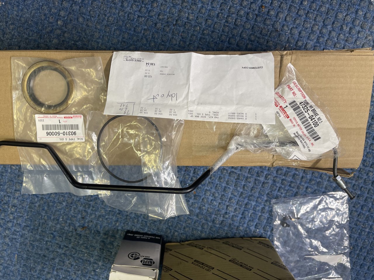

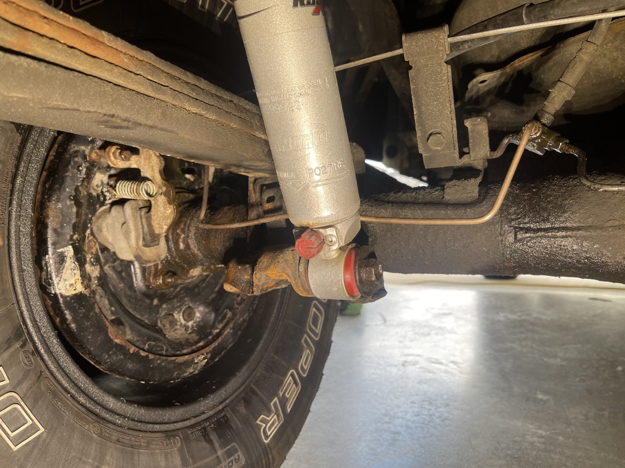

    So I got into mine, brake line was rusty/ wanted to strip. Drivers side- Toyota doesnt make it anymore. Passenger side yes:
    seal and oring are less than $10
    Had to make my own brake line :
    other part maybe to have is a brake cylinder NAPA 37841.
    Brake bleeder/shoe kit
    and some new bolts for the brake cylinder 90080-11148 .84 each. All in case bolts break or strip on my 2001….
    ended up taking to local Toyota, $350.
    They say if the wheel bearing isnt making noise, run it. Seal replacement is 1yr unlimited miles if it leaks. I let them do it while I sat and watched a movie. Couple hours and didn’t need all the parts
    Area51Runner and justdad25 like this.
