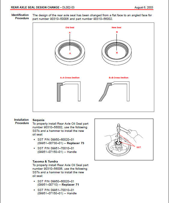

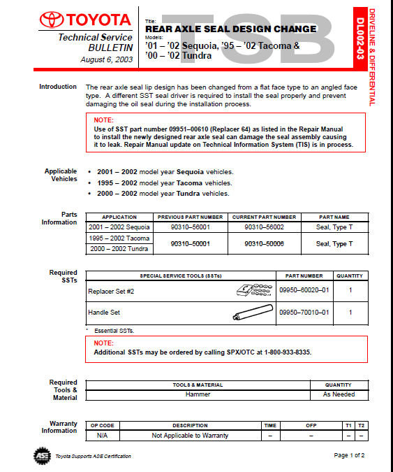

    There was an improved seal for the Taco rear some time around 02. Your 04 should have it from the factory. They do wear out and can fail/leak for other several other reasons such as a plugged diff breather, bad bearing or bent axle.
    The only TSB I know of regarding the new seal is more about the installation.
    Here it be. It is poorly worded, the years/models affected are off, the drawings of the seals are not even close and the little drawing of the "installation" is of an outer seal not the subject inner seal (dated 03).

    That installation TSB is the exact conformation I was looking for. My truck has 115k on it. I know the seal is bad, as there is diff oil all over the inside of the brake drum and running down the back of the wheel. I've been sure to keep the differential oil topped off. It's on the shortlist for repair. The brakes feel like chit when I stop. thanks for the info.
