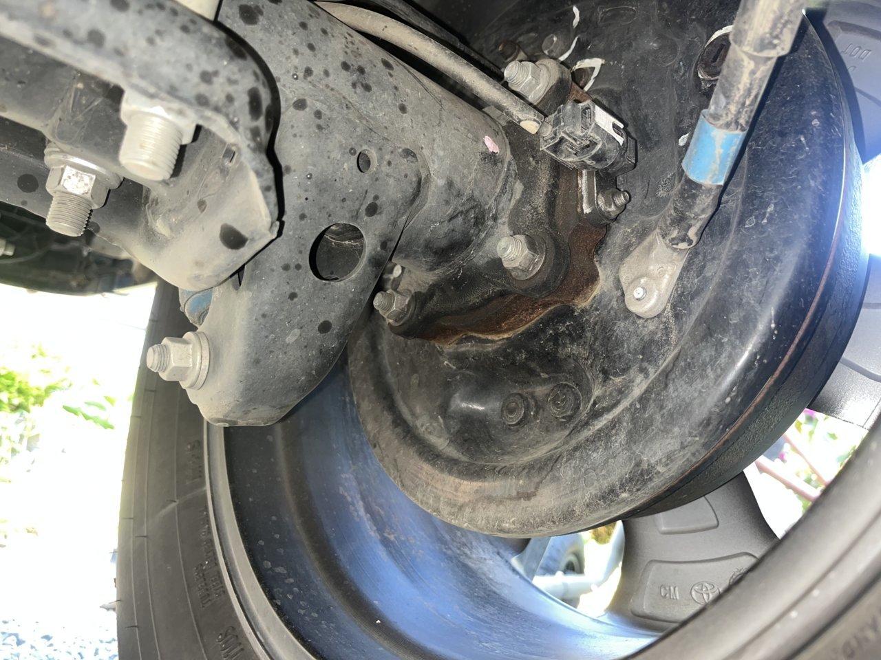

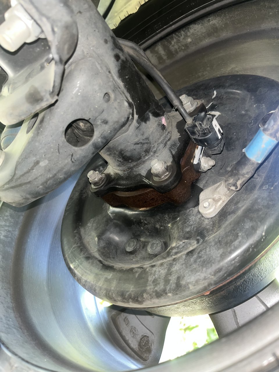

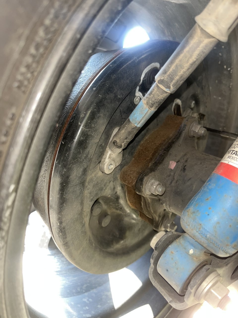

    Hey Tacoma junkies!
    Background: I took my Tacoma in for the rear diff seal about 3 mo ago and when they did the work they didn’t replace the rear axle seals. They started to seep on both sides immediately. Got the warranty work for that and now the drivers side is seeping again about two months later.
    Q: Is this a common issue with anyone else on this forum? There are some attached photos of the drivers(seeping) and passenger(no seepage). I’m wondering if it’s the techs doing the work.. Or did I just get a crappy finished rear diff and hub assembly from the MFG? No matter how many seals you throw at it there might be damage or warped metal contact surfaces.

    Is the axle vent clogged or pinched off or anything? Usually this is the reason axle seals go. Pressure builds in the axle blowing the seals out. I've been victim to this a couple of times. Toyota's little check valve on the axle housing is effective...but only if it never gets dirty or damaged.

    I checked the valve and it’s moving freely. They said they checked it for function and it was working also. I do live down a 300ft long gravel road so I wonder if the dust is getting trapped. I drive slow enough where it doesn’t kick up dust most the time. My roommate also has a 2016 and they don’t have any issues. All my other driving is on road.

    They most likely nicked the seal when they were putting the shaft back in the axle housing. Hard to tell when you are doing it so it was most likely an honest mistake. Just take it in for your appt and let them fix the issue.

    Seal they replaced was rear diff pinion seal I assume. That seepage is really very minor and may stop but try the stuff below. Bad is running down the backing plate on the wheel and spraying/flinging all over ha ha.
    On gen2 should be same as your gen3 there is an O-ring between the axle tube and 4 mounting bolts/nuts and they don't always tighten them on the lowers too well. One has the shock mount in the way so use a box end wrench and see if its tight. Even a few drops of gear oil that drip down looks like alot so spray it all down with brake cleaner and then see.

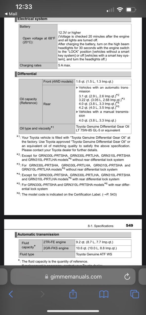

    Did you pull the upper rear diff fill plug and see if any gear oil came out indicating it was over filled? Or wait for the dealer again and tell them to change that breather vent too. All the auto parts stores sell them and many of us change them out for a 2 way breather remoted up in the taillight or bed to avoid clogging and a hot rear sucking water in stream crossings.
    As for the lemon law do not hold your breath on that approach - they can out last and out BS you for alonggggg time. As for the national Toyota assistance # do not waste your time they are clueless and take forever to do nothing.

    Right this was extra work that had to be performed from the rear diff third member gasket seeping issue. I was reading somewhere online in a service manual that it is recommended to replace the rear axle seals when doing any sort of work that requires removal of the axles from the third member. Is this Toyotas way of getting around the books by sliding them out only 3”? My guess is yes.
    And Trust me I do not want to do the lemon law because this truck is my favorite so far with the manual 6 speed. I have it tuned perfectly right now as well and I have pretty much babied this thing with fluid changes.
    You definitely have a point about the overfilling part. Blowing the seals or allowing the fluid to push past from the pressure increase and clogged vent. Are all the differential housings the same size across all the trim levels? Toyota uses different fill capacities based on the equipment. They should just come up with one fill level and design it around that and save people hassle.
    My friends off road has the same rear diff housing as mine. Except his has the electronic control since it’s an off road. Other than that the only real difference is the different third member gear ratio. I don’t understand why Toyota even uses different fluid amounts Since they’re the same housing. If the dealer filled to the line and that’s the case then it’s overfilled. But if they added the correct amount and it filled to the top and started to drip then that’s fine. I think the manuals call close to max fill on these. They need to do something about this breather valve then if it keeps popping up. Here’s a screen shot of the fluid levels based on equipment. 3.8l for the manual. Which is just below the max fill. If they filled it to the top, which is probably the 4.0l then it’s overfilled by 0.2liters. They wouldn’t make a differential that holds more past the fill plug.

    I had a repeat leak at the left rear that took me a couple tries to figure it out. At the outer end of the axle just inboard of the bearing there is a few spacers stacked up. One is the tone ring for the abs sensor, a spacer and a sleeve that the lip of the seal rides on. On mine the lip of the seal was resting right in between the spacer and sleeve where they meet, down in a small channel. I found it by painting blue silicone caliper grease on the spacer, installing the axle and then removing it to see how far the seal rubbed the grease off. So I had 2 choices, I could reposition the sleeves and spacers or I could reposition the seal. I didn't want to push the abs ring around so I opted to reposition the seal. Got another seal and tapped it in with my installer tool, stopping a fair distance short of the old one. Still plenty pushed in so it wouldn't pop out, but not fully buried down in the axle tube. Checked again with caliper grease and the lip was now fully on the sleeve, not in the groove. No more leak since
    But realistically, if they had the axles out they should have replaced the seals. They may have knicked one putting the axles back in. And yes check the vent
