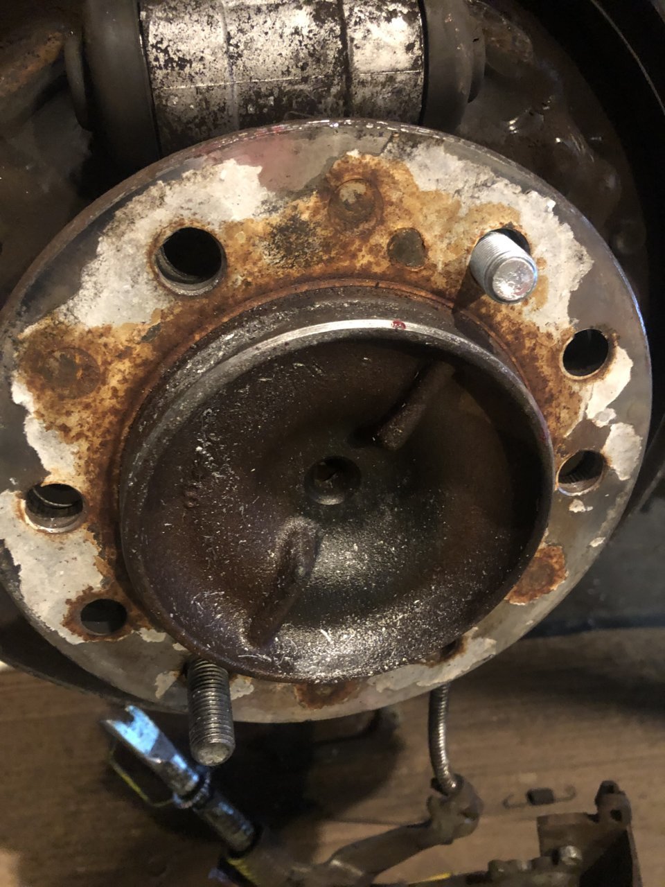

    I stripped out the rear lug nut bolts awhile back. From what I understand the only good way to fix it is to replace the axel shaft.
    Aside from getting the wheel bearing pressed in how hard it is it do? I have a pretty good parts list but I am not sure if it is the type job to do in my garage.
    On a scale of 1-10 how bad does it suck?
    I have replaced UCA, front wheel bearings, added 6112's coil overs and several other items as well. Just not sure I can do the rear axel shaft.
    Thanks.

    I could be mistaken, probably am since I'm not looking at it right now, but can't you bang or press out the wheel studs and press in new ones, maybe with a c-clamp? pulling out each rear axle is easy, it's taking the drum brakes apart and putting back together is the time killer.

    The studs hammer out from the hub flange easy enough. It may be tricky finding a spot with enough clearance to fully remove the stud and install a new one.
    Pulling the axle shaft away from the bearing is a big job, needing a bazooka-sized press tool and a hydraulic press:

    From what I understand because I stripped out the holes that the lug nut stubs go in I have to replace the whole thing because it is all one piece.

    But did you try new studs already? If not, try that first. You’re already committed to dump a bunch money in to it.

    Check if you have enough room to replace the wheel stud:
    Remove the brake drum
    Hammer out the stud
    Rotate the wheel hub as needed to find a spot for the stud to come out.
    If you have room, new stud can be pulled through with an open-ended lugnut, flat side toward the hub flange.
    Replacement wheel studs are cheap, like $1 each: https://www.rockauto.com/en/moreinfo.php?pk=1060129&cc=3441741&pt=7680&jsn=4

    I did..I fucked up bad. So it needs to be replaced or I just keep riding on 5 lugs.

    The holes are stripped out.

    not will be cheaper to tack weld the new studs on the back of the hub if you’re bearings are good.

    You're talented :laugh: Usually the hub flange is heat treated harder than the wheel studs.
    Go to your nearest auto parts store and look through their fasteners catalog. Can probably find studs with larger knurl diameter.

    That might not be a bad way to go. The bearing seems good, but it is the original and the truck has about 192K on it.

    the problem is that the axle shaft doesn’t contain the bearing anyway so you’d have to buy a whole new axle shaft then press on a new bearing. That's going to cost close to $500. Tack welding the studs on will be a $5 solution that should get you to at least where you’re ready to replace the bearing and then asses whether you want to purchase a new axle shaft or not.

    What do you mean by stipped out? The studs press in.

    I can only assume he means that the hole has been enlarged to a point that the splines on the studs no longer hold tight?
