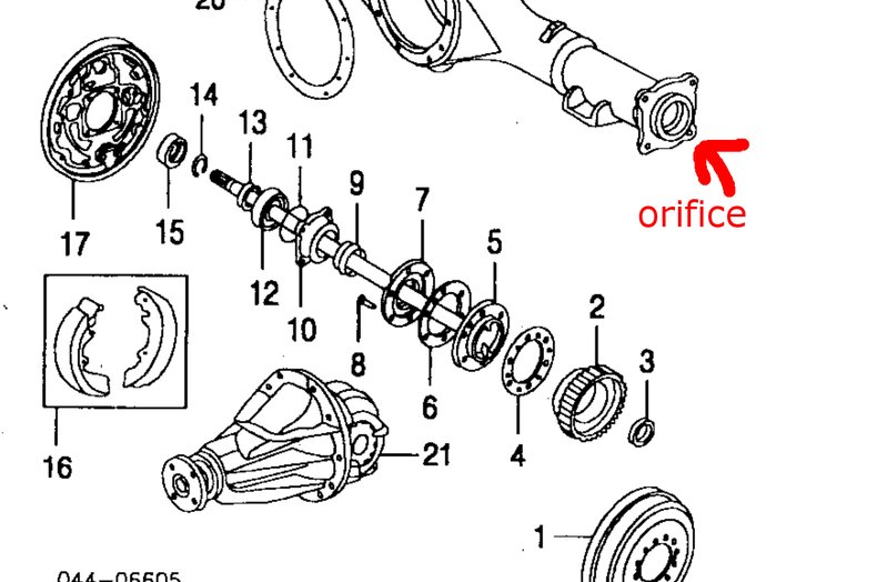

    Anywho, OP, something is damaged, youre right. upload the video of the wobble to youtube and paste the link here. best way to go about it. the main problem im having is that there are only 2 points where the axle comes in contact with anything else on the diff. thats either at the thirdmember, or at the axle housing's "orifice" (see attached photo). so unless something got a little squished and when you bolt in the axle through the bearing housing (#10) forcing it to slightly bow inside (which would be difficult to comprehend cause the axle would snap in no time) there is nothing wrong with your rear diff.

    and no matter what way I look at it. there cant be anything wrong with your axle or diff or anything else. tell me again, what are you seeing wobble? cause that impact could have bent the flange, but that would have gone away with the new axle. it also could have very easily bent your rim if you are seeing your rim wobble any bit while it's on..
    for reference
