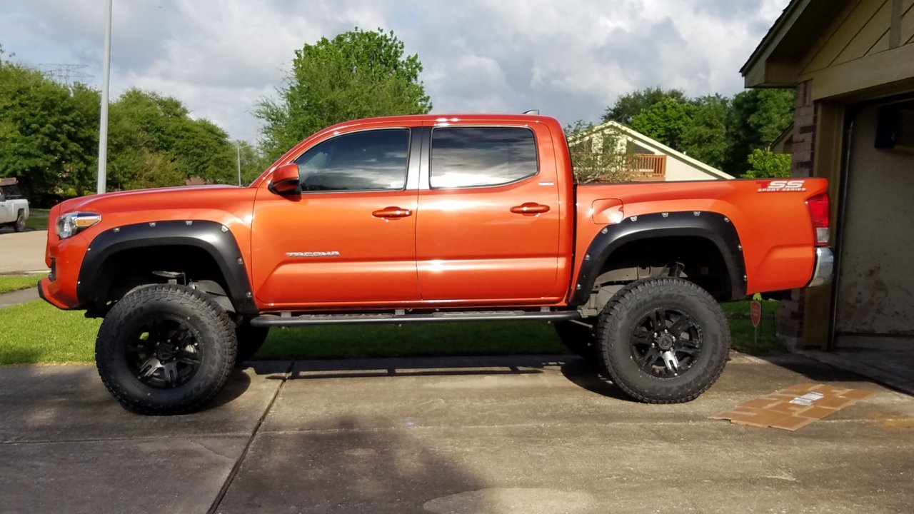

    Glad I found this thread... As you can see from my lift, I'm having to go with 4* shims. If the centering bolt head does NOT sit down far enough to postiviely engage the block, does anyone make a "longer-headed" centering bolt?
