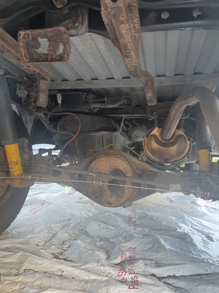

    Gentleman and women,

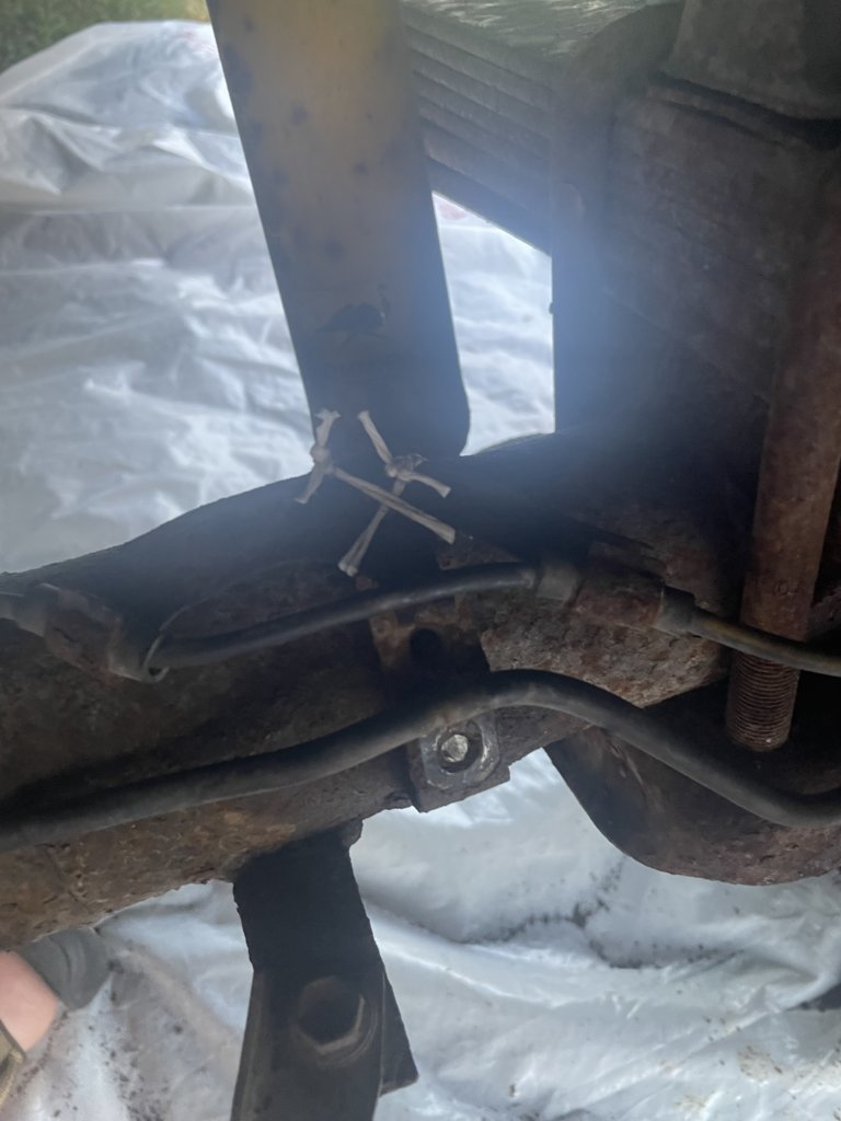

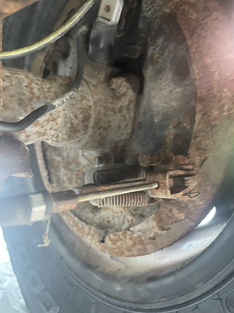

    I’m attaching many pictures of today’s wrenching woes.

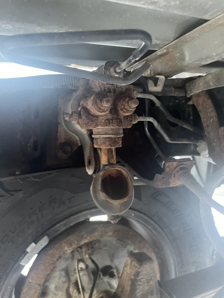

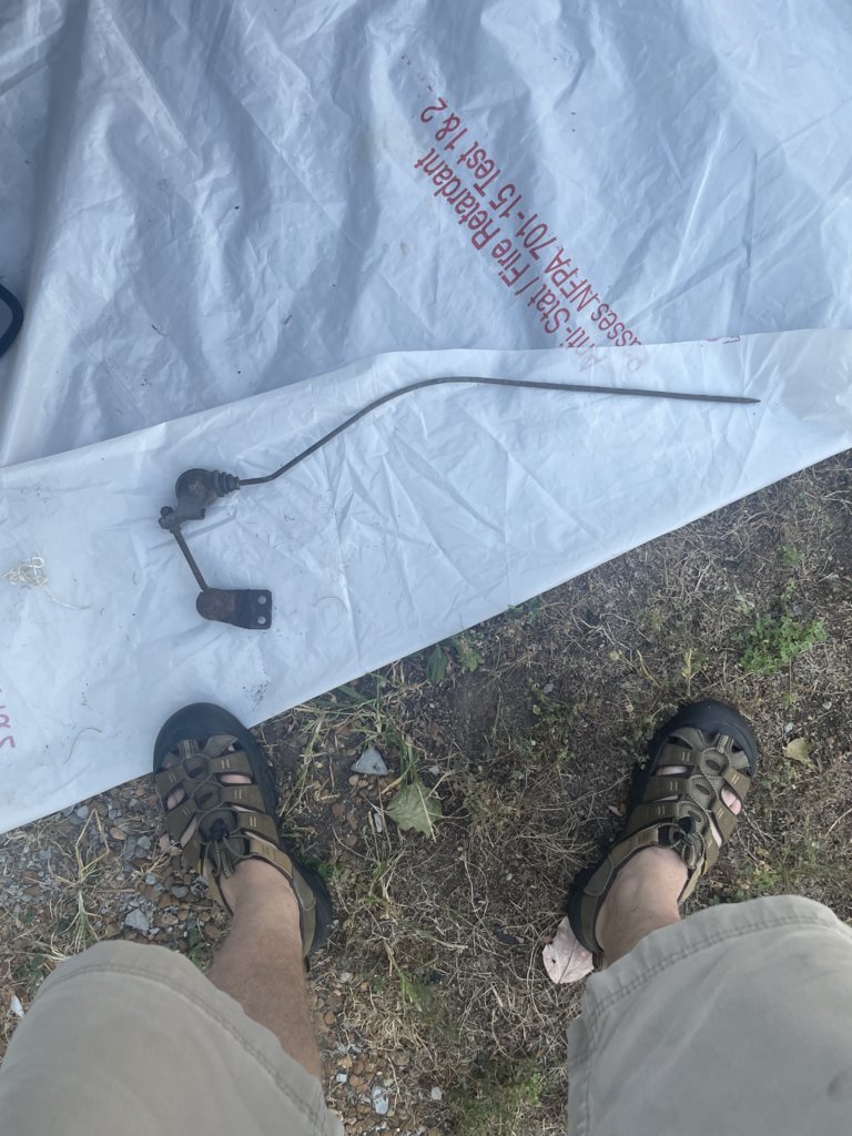

    LSPV rod was rotted in two so I had to take it off, no problem. But I remembered I have a preflared brake line for rear passenger line that runs along axle and so, I pb’d the bolts and started trying to prep that line for replacement..three snapped bolt heads later (the ones with the little line clamps, one that holds the abs sensor wire onto axle housing, and one that is for the LSPV rod on LSPV side) I’m wondering with the level of rust on this axle, if I would be better off buying a whole new one to slap on.
    I have much love for this truck, and if you search my previous threads, I’ve already put more money into the taco than it cost to buy. It has had a new frame swap in 2018, and many many other parts replaced or upgraded over the ten years I’ve had it.

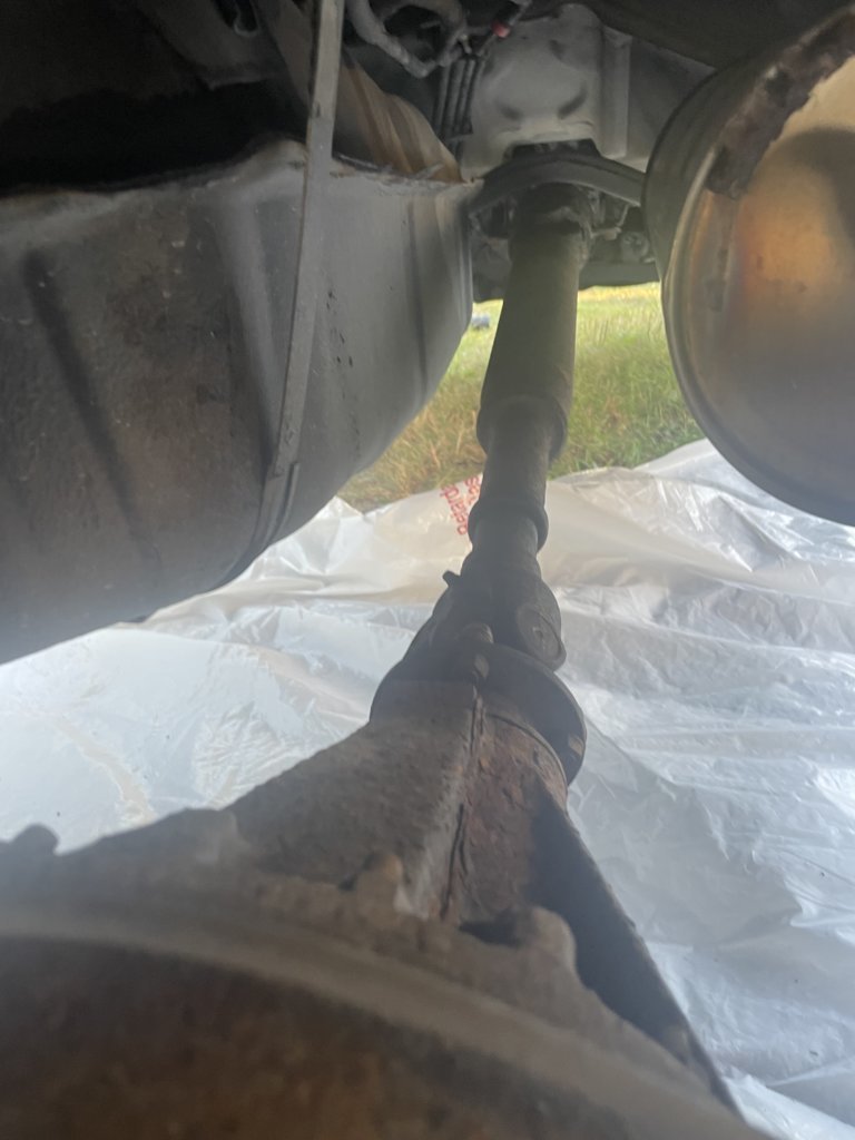

    I need advice on weather I should buy a new axle and take better care of undercarriage going forward, or if I should stay the course. I truly don’t know the best course of action here, because the axle functions fine, it’s just the components attached to it refuse to come off without snapping off.
    I look forward to any and all opinions you folks are willing to offer up. Money is an object, but surely even a new rear end will be cheaper than offloading it and buying something else. I’m slightly above average in terms of mechanics, if you guys could help me with options and rough guesstimates on prices for those options, I sure would appreciate it. Truck runs great…I temporarily secured the abs bracket with wax coated twine, as you’ll see in the pics. Thanks everyone.

    I see you have replaced the frame already so that much is done. As far the axle assembly no question I would find a good clean used one and swap it and all attached components.

    Depending is the condition of the frame, might be best to drive it until its no longer road legal. If the frame is good, you can buy a complete axle for maybe 800-1k and swap it out.

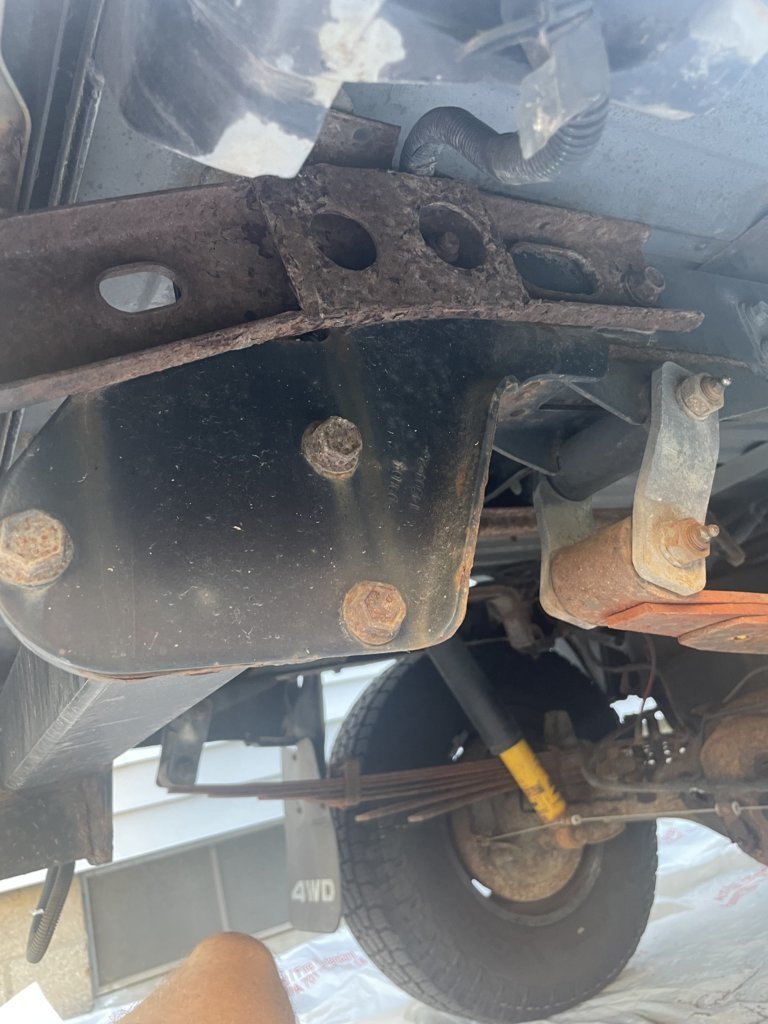

    the frame is good, some rust because I neglected to have it coated when they did the frame swap in 2018. Big mistake.

    You should replace what you can and get the frame treated. Still not too late if you planned on keeping it for another 100k miles

    If you have been letting salt eat on the new frame unfortunately it might be time too part it out. How much rot does the body have?

    I'd 1) cobble together what you need to keep it going 2) Waxoyl that nice frame so it stays nice. Two products, one inside the frame and one outside. Do the bed underside as well, basically everything except trans, etc. and exhuast. I'd clean up whatever rusty bits need cleaning up, but I wouldn't bother with rear diff. Then 3) be looking for a new rear diff. Look closely at your rear backing plates for the brakes and see if they are corroded badly. IF they are, shop for a diff with all the hubs and brakes and everything intact. Then you don't need to pull axels and hubs to replace the backing plates. Surely there is a set up in a no-rust state waiting for you...
    This all of course assumes you want to keep the truck for a while. GL~

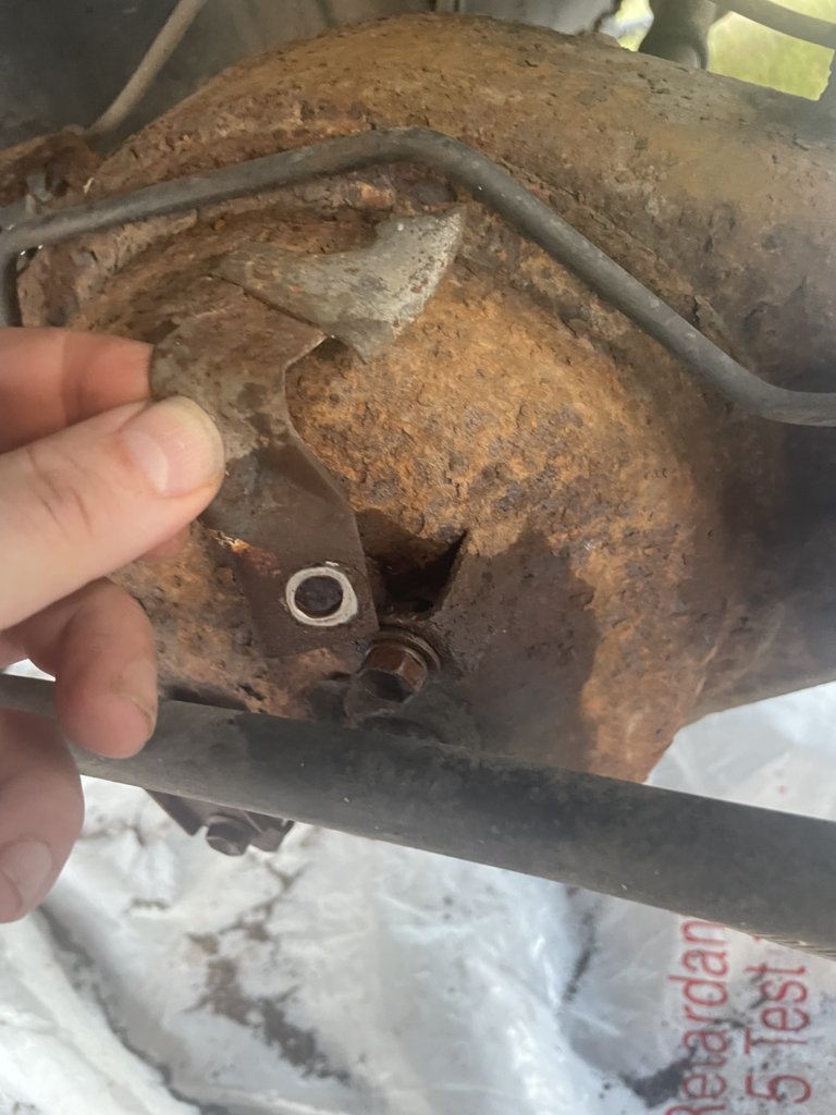

    The pic of me holding up a broken bracket. Can anyone id that for me and tell me what it holds up? It was broken so i removed it. It attached with a single bolt on the rear of the diff/axle housing.

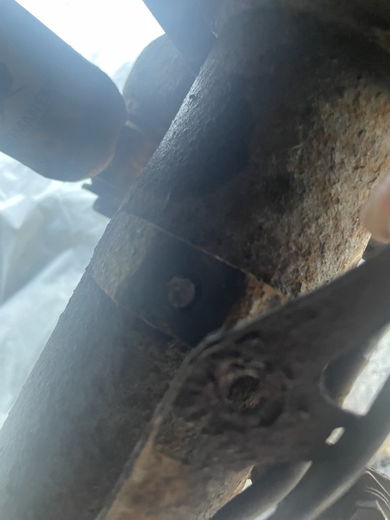

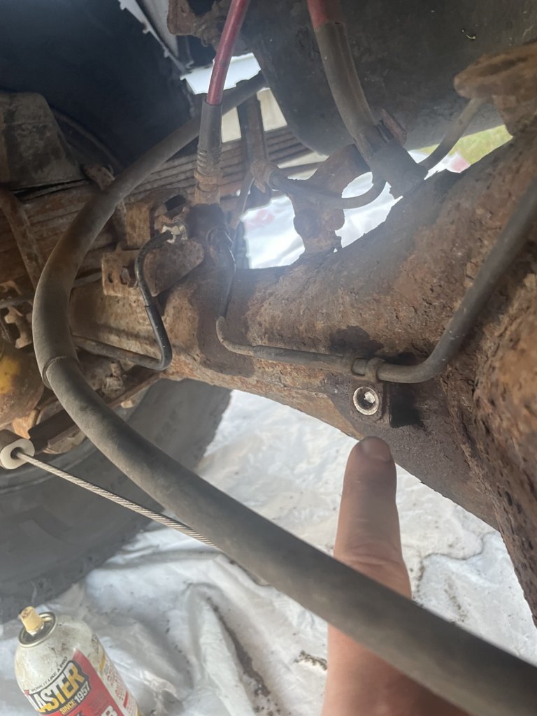

    IMO
    Yeah axle rusty
    But heavy steel
    Unless (as bpfender stated) components coming off bc of rust (backing plates)
    I would rather grind/primer/rust coat axle
    those snapped bolts can be extracted or heilacoiled if severe enough
    big thing here is the rusted out LSVP
    (Probably wasn’t even working)
    Have you checked your front brake pad wear to the rear drums?
    I did when I got my taco
    Discovered 99% front brake bias
    My LSPV failed, all stopping the truck came from front brakes
    Good news bc you mentioned budget….
    You can do a LSPV delete for $85
    my taco stops like never before!!!
    Lemme find my thread
    One post on mine says even simpler/cheaper way
    Others chose to place the $40 manual rear proportion valve under hood(looks nicer but costs more $$ bc of brake hard lines)
    renots[OP] likes this.

    Been a while controlcar, remember talking to you on the fone! Lol. That’s dedication. Yes even though I ordered a new lspv I’ll probably delete it. Send more info on the snafuud bolts fix, need all the help I can get.
    I think step one is build a f’n garage so this stops rusting into oblivion.

    I guarantee I have 100% front brake bias. I have 250k and never needed shoes on the drums.

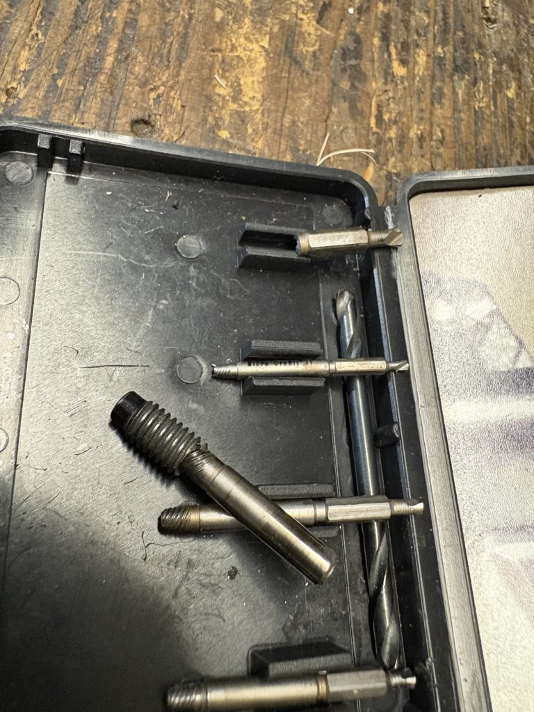

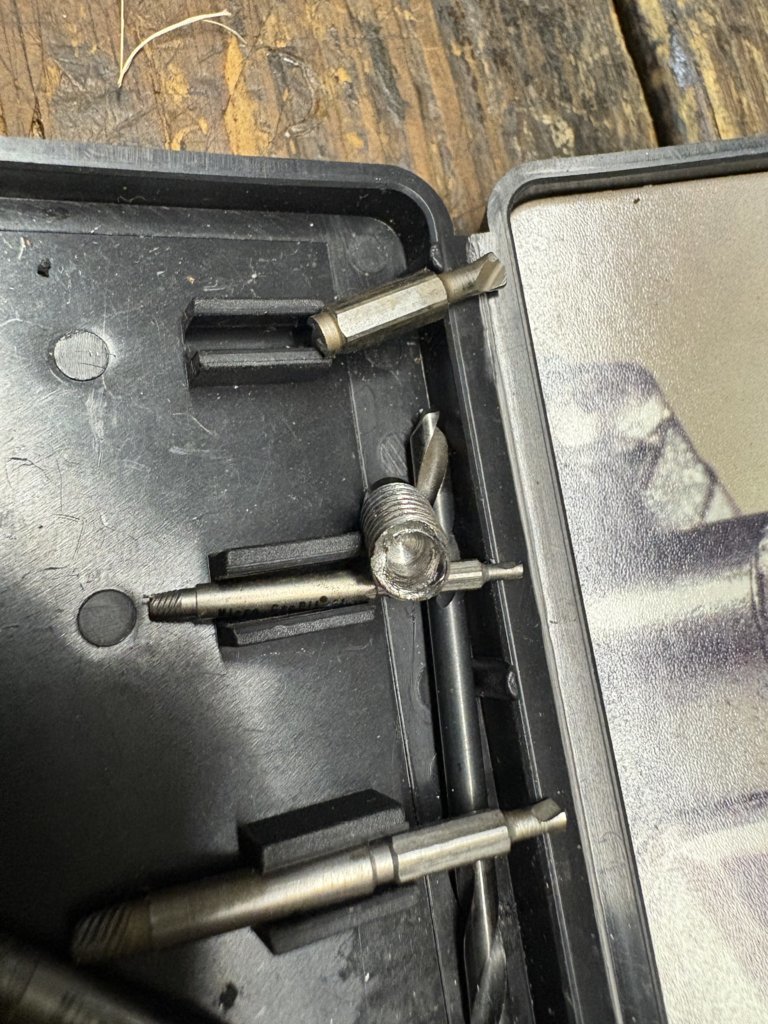

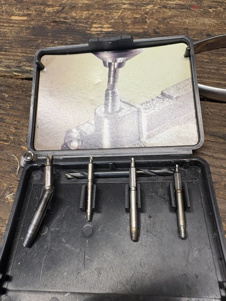

    Craftsman
    Drill bit one end
    Opo end has a reverse thread screw

    I kept that snapped valve cover bolt for keep sake
    If that extraction didn’t work, would have to pull out engine and buy new Subaru head
    my shit was aluminum could not heat
    Your axle……heat is your friend
    Like plumbers torch to heat your steel axle before/after you drill snapped bolt
    Also, pretty sure few of those snapped bolts are part of the LSPV assembly
    If you delete, don’t have to worry about
