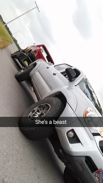

    Yoke for driveshaft will be different, You have 6 lug nuts chevy probably 5. If it is that chevy your towing in pic the chevy rear end doesn't have wheel speed sensors. Sounds like headache, but if you have time and money what the hey

    This is a six lug out of a race truck from up north Memphis I picked up for around 200 bucks its not in that truck I'm pulling. I bought it for that truck but the one it has is so well built I'm not gonna even touch it.
