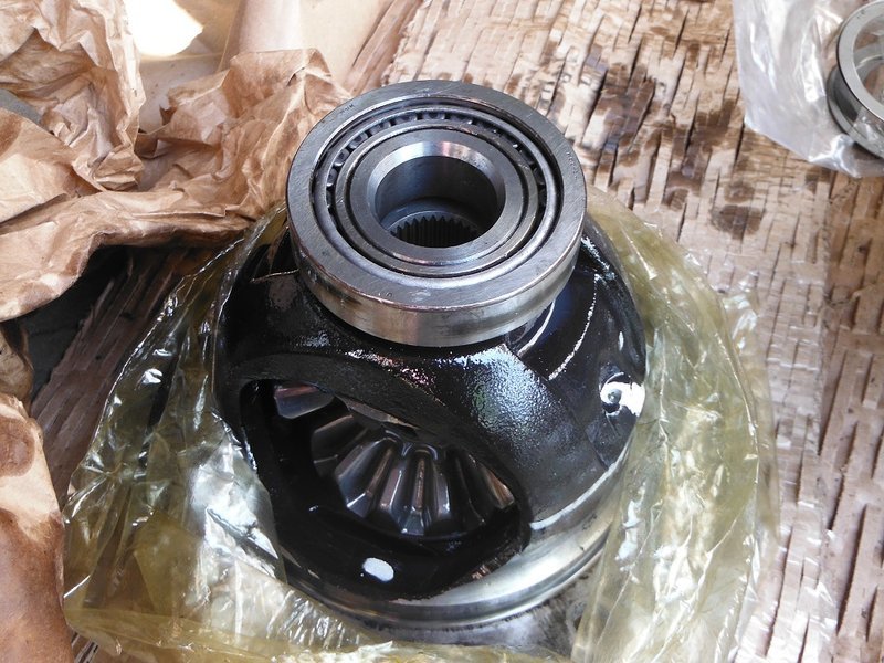

    These pictures are of a 10.5" Toyota differential, but the design differences are similar for the 8" axle. With the factory e-locker you also have a stupid piece of vulnerable plastic having from your carrier.
