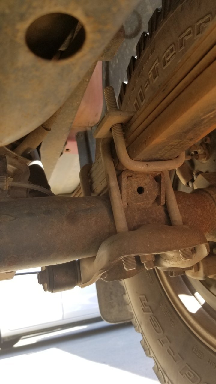

    The axle wrap mod doesn't say it'll eliminate axle wrap. It's just a band-aid fix to help reduce it.
    The farther away from the axle you place the U-bolts, the less you should get axle wrap, but also the shittier your ride will get because you are restricting the movement of the leafs more. Mine (see pic) are about as close to the front of the axle as I could get them. I'm running the original springs (~!20k miles). They've been like that for going on at least a decade now. Definitely reduced the axle wrap, but didn't eliminate it.
    It's really just a sign that your leafs are worn out (although new leafs can do it to). Worn out ones just get worse.
