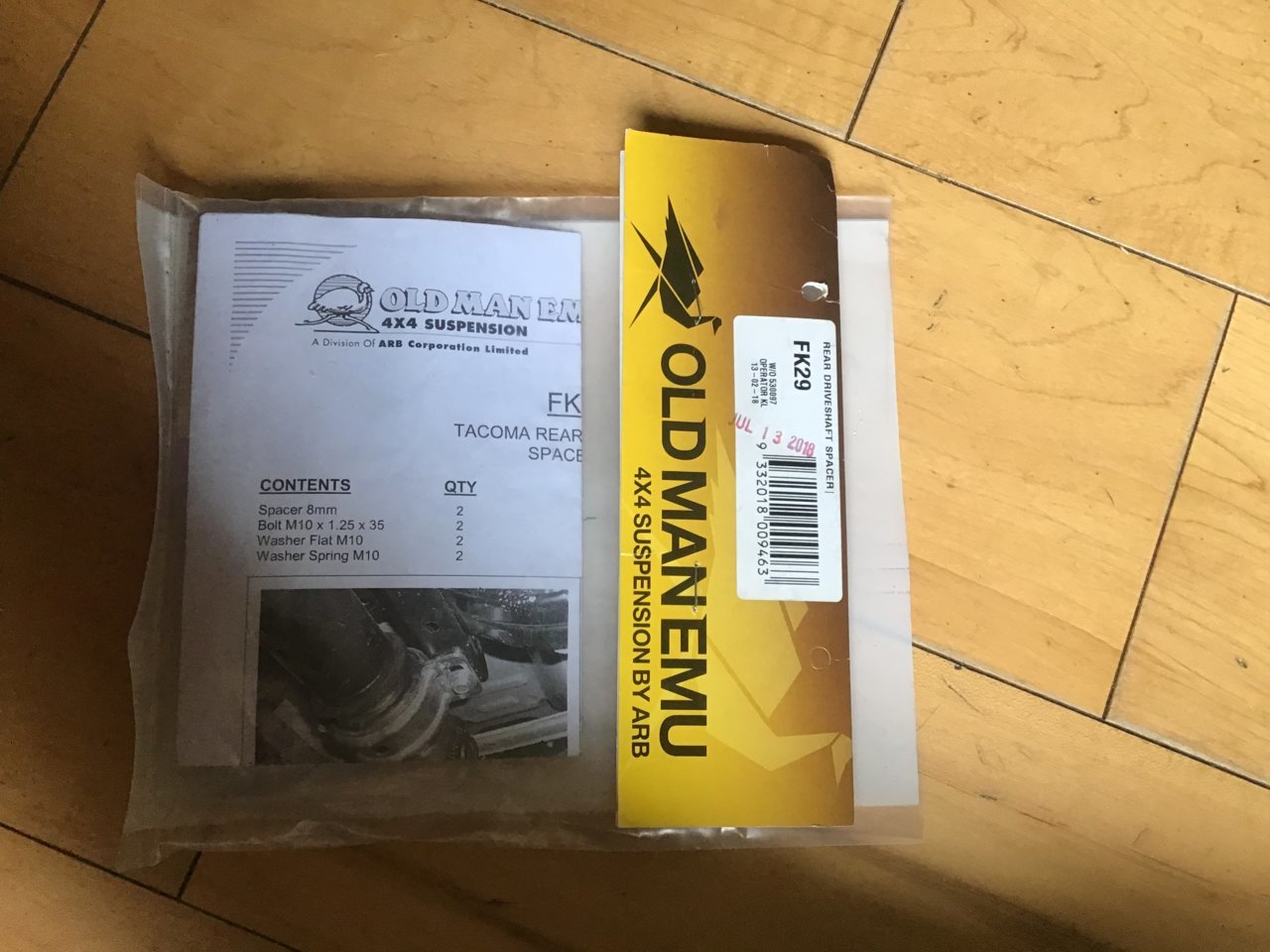

    I've recently installed Dakar's EL095R, thought that cured my "bump" feeling when coming to a stop but it reappeared.
    There is a TSB from Toyota to replace the drive shaft but it's about $600. I also get a slight shudder on accel.
    I have a regular cab, so no carrier bearing. Any thoughts on what to look at? I'm lifted 3" in the front and 2.75" in the rear (according to the specs. from the lift I bought).

    I went with the AAL on my MD Dakar’s and now have the shudder on take off . Also have the thump when slowing then accelerating . Think I will save some money for the Tom Woods one piece drive shaft .
