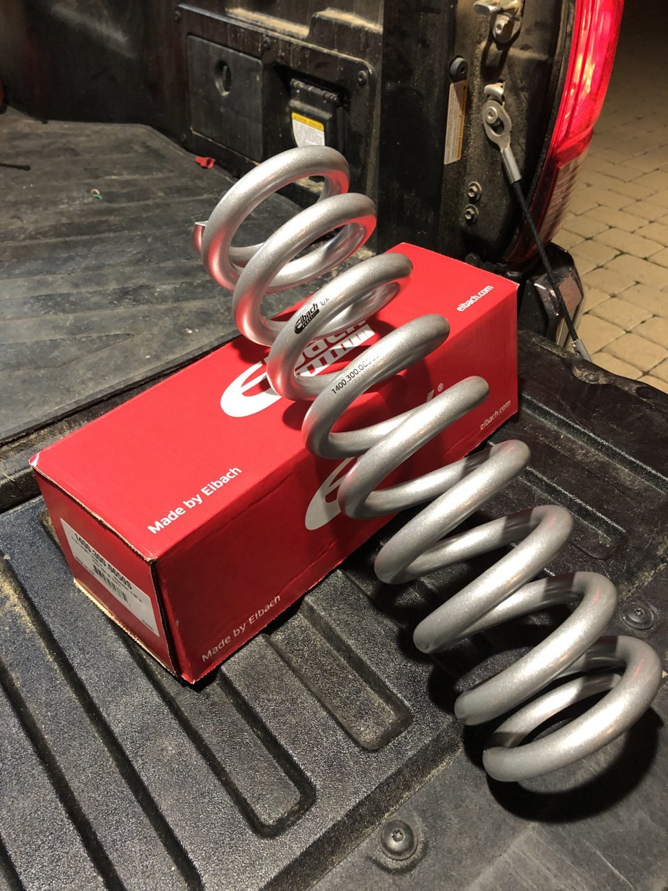

    New 14” 650# coils for the front

    14” 650#’s installed today. So far the ride is nice. Gained a little lift, stiffened up and less preload. Happy with the results

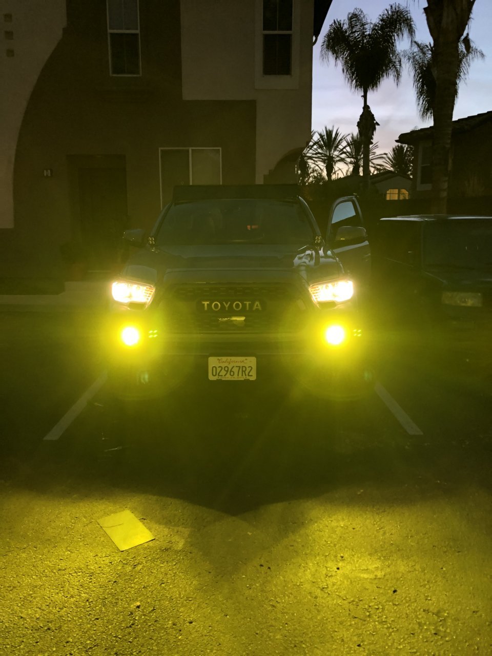

    Baja design squadron sports installed today for fog replacements E29CD9F3-989F-4D3F-9AD9-85D469D88C7A.jpg

    Forgive me for not reading back.. but have you added a bunch of weight to merit a 650lb coil?? I have the 2.5s with the 13” 600lb coil and I’m thinking of switching to a 14” 600lb
  11. Feb 10, 2019 at 6:50 AM
    #51
    AY_ARONTRD
    AY_ARONTRD [OP] Well-Known Member
    Sep 25, 2017
    #231065
    4,074
    Aaron
    Murrieta ,CA
    2019 DCLB Cement OR 4x4
    I originally had the 2.5’s with 13” 600# coils on my 2wd, seemed fine. Once I traded in and swapped parts to my 4wd it just didn’t feel the same. I can tell the weight difference was affecting the front suspension. Just felt way to soft. Had a friend point out my coils were bowed and were starting to rub the shocks. Did some research and found out I needed to swap coils. So I switched out to the 14” 650#’s... so far the ride is nice. A little stiffer,and front end sits a little higher. As for added weight... nothing so far. Just my skids and sliders
    eccracer104 and Hookedup[QUOTED] like this.

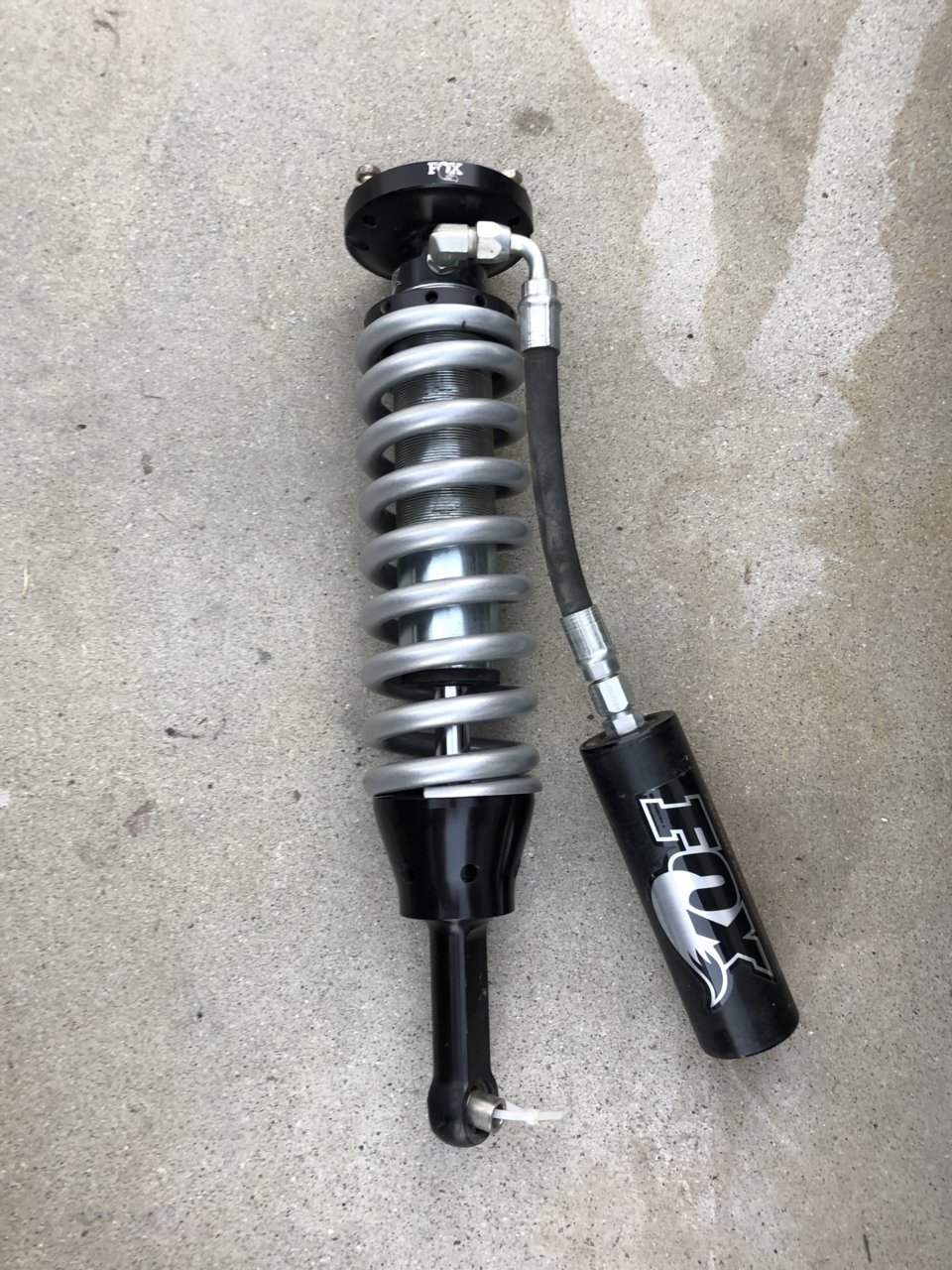

    Okeydokey.. did you happen to measure hub to fender before and after? Or measure the threads? I’m about to put these coilovers on next week. Truck has 200miles on it and I just want this done right

    Sorry but no I didn’t measure anything. I would recommend not adding to much preload in the beginning. Break them in and see how they feel. Take it out wheeling and see how the coils feels.

    Drive characteristics are a lot of the time preference of the driver. @AY_ARONTRD felt like the front was too soft, even with no real additional weight and his coils were bowed from the amount of preload he already had.
    Going to a 14” coil at the same spring weight will allow you to add more preload but won’t net huge drive characteristic differences.

    Cool thanks.. we spoke about this previously @desertjunkie760. I’m still on the fence about it.. i already have the 600lb 14” coils (kings coils) someone gave me. so why not swap em out before i install. Coilovers are DSCD so i can stiffen them up a bit if need be.. thanks for the input. Don’t want to hijack this thread anymore than i have..
