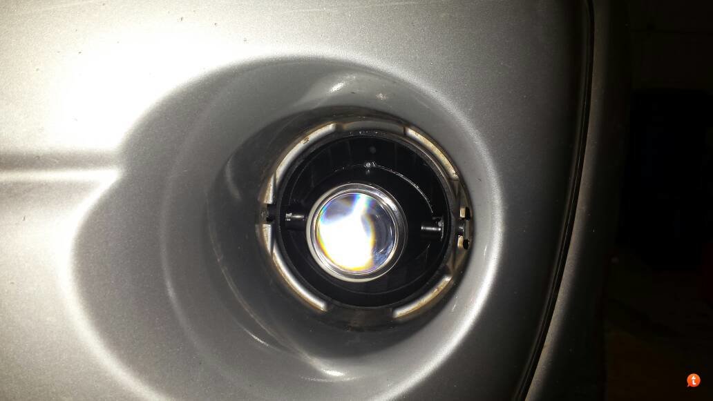

    This is what I have so far with trying to retrofit a projector into my fog light.
    Does anyone have a set of 35 watt ballasts laying around that they don't need?

    You're definitely going to want to put them into some sort of housing. I would use the factory fogs and Retrofit those.

    They are in the factory fog light housing but they stick out past where the lense would be. I'll try to get some better pictures of that. But they are sealed so they don't need to be enclosed

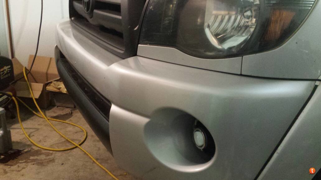

    Here are a couple of other angles.
    I'm not done with it yet

    Those look pretty awesome. I do have 35w ballasts, but I'm selling them with my entire retro package.
    As for the cover, just use some pvc or something that fits and silicon both sides to create a spacer so you have the cover over them... you don't wanna get pissed and chip the glass from a rock.

    This ^ is what I meant. You gonna put the lens of the factory fog back on?

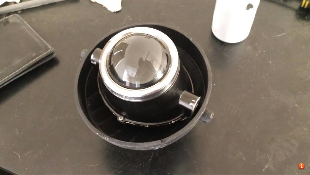

    That is a really good idea. I will probably do that. I was going to cut a hole in the lense then let the projector sick thru it but then the glass on the projector is still exposed. I would also need to drill a hole or two for water to drain out if it wasn't water tight.

    Its just like a projector on a headlight, except even more exposed. It should definitely be behind a lens. Atleast that's what i would do.
