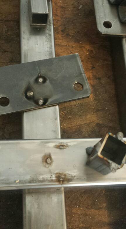

    Cant even tack well.
    Was going to weld today... realized I did not magically learn how from hours of YouTube. Lol. Fml. Need lessons.
    Btw. I have done this before successfully. I think maybe I needed to clean the pieces better from the oil on them.

    Looks like it isn't perpetrating well.
    Turn the heat up a bit

    Its as high as it goes. Lincoln pro140. Something else is causing the lack of penetration. Thats why I was thinking the oil coating.

    That may be it. Sit on it a little longer as well.

    Clean with rubbing alcohol.
    As juanathan said, turn the heat up, stay on it longer, and perhaps increase the wire speed.
    Are you using gas or flux core wire? Is the gas you're using the correct mixture?

    Used the gas before. Solid wire. Its been a long time since ive done this. Few years. Argon co2. Good flow and pressure. Heat at D. Speed at almost 8. Box says 7 but a few other beads last night were ok on some test stock at 8. I think i need to sand the locations down and try again. Not this weekend though.

    Clean and prep before welding. Major must
