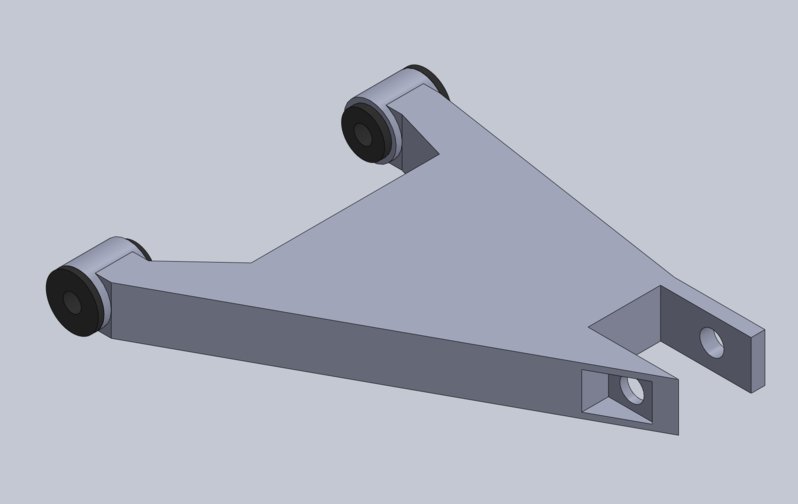

    Delrin Bushings and all

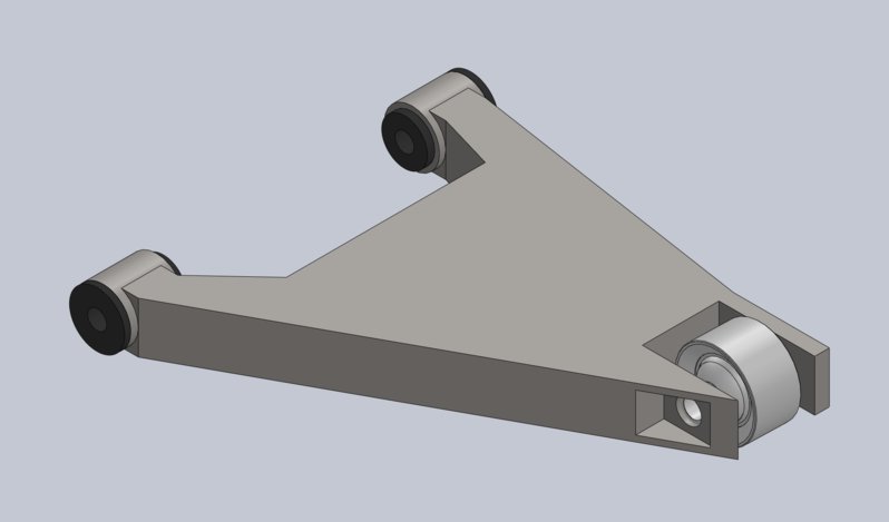

    Cool. Solid/machined arms or fabricated steel? Stock length? If you're going through all the trouble why not put spherical bearings at the frame side? Have you worked out how alignment cam min/max position interacts with steering clearance at the lower spindle mount? Looks tight.
    There was a guy on azfj several years ago who was going to build an aluminum long travel kit as a grad student project at ASU. Last I heard he was looking for volunteers, so I dunno if it actually happened.

    Boxed with internal bracing. Stock length for now. The fabricated upper arms will have heim ends to be adjustable. Ya, from my calculations I should have a couple hairs of clearance, but we'll see
    Also that uniball isn't the correct size haha, forgot to add that.
