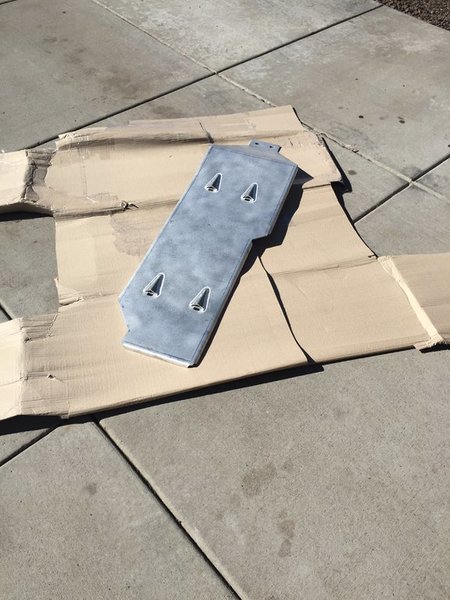

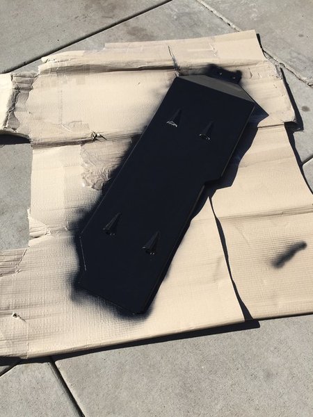

    All of them
    Finally painting these skids so I can hopefully one day out them on image.jpg image.jpg
