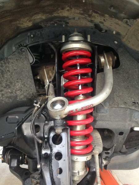

    isolator hat looks a bit wonky?

    Did you happen to put a bushing on the shock then put it into the shock tower?

    pull em back out and double check everything. something doesn't seem right, and you can't confirm that everything was assembled correctly. best to just start fresh in a situation like this

    Well your first step no matter what Is to check it. There is obviously something wrong sorry vise grips on the top of the thread and turning the nut. If not then take it out and check it then start over on that side

    Sounds like a bushing didn't make it into the shock tower below shock top plate. There are two on each side.

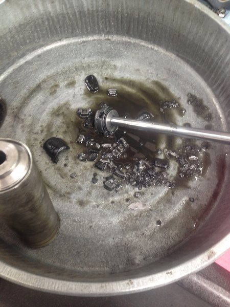

    Could be worse. Last time I thought something was wrong with my truck I found this. image.jpgimage.jpgGood reason to upgrade to the Kings lol.

    Shock shaft isn't actually straight due to the piston disintegrating.

    If it's not knocking/clunking, there shouldn't be any significant issues occurring.
    I thought we had both bushings on both sides. 1 had to be retrieved and placed before stabbing the shocks. You were looking up from underneath, but it was kinda dark.
    I'm not sure what it could be if the bushings are there. Let me know if you want/can bring it by my place.
