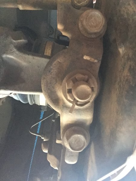

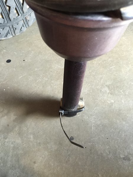

    Then no you dont need to touch it. Loosen lower shock bolt, loosen top shock nuts, remove both lower ball joint knuckle bolts. Drop lower. Pull out shock. Reverse putting new one in.

    To be sure thats the two outside bolts?

    Correct
