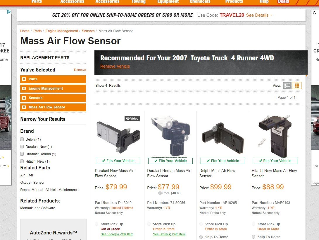

    Can that sensor fail without throwing a code?

    MAF's are notorious for getting wacky without throwing a code, across all makes and models.
    See, if the MAF outright breaks the voltage will read 0, then you will get a CEL. That's not what usually happens though.
    If the MAF is still reporting any voltage there isn't really a good way for the ECU to "authenticate" the results. As such it can think there is much more air coming through the intake then there actually is.
    Syptoms would be running rich as hell, decreased power and low MPG...
    Is your tailpipe all gross and black-sooty, more so than the usual?
    Don't want to sound like a dickhead but often times what people clean when they "clean their MAF" is actually the integrated temp probe on the MAF and not the airflow meter probe itself (at least this is the case with certain makes & models). Can you post a pic of it?
    Tsinajinii, Aw9d[QUOTED] and llibrm like this.

    Looks like this: Screenshot_46.jpg
    I used MAF cleaner, cleaned every part I could get to. Damn near went through a new can of it. I haven't had time to read up on testing it but we are just going to order it one from Toyota. Worth a shot, if it doesn't fix it box it up and keep it for later.
    Nitori[QUOTED] likes this.

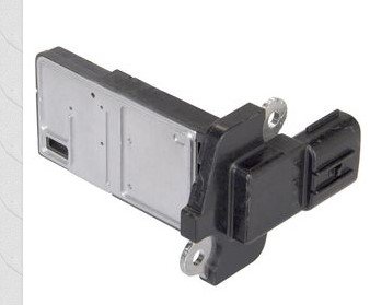

    Gotcha, OK. Yeah give swapping out a new one a try, 'cause it doesn't look like the MAF's I'm used to seeing.
    Like I said, I didn't want to come off as a smartass but a lot of MAF sensors look like this:
    And people see that obvious bulb and clean the piss out of it, but that's the temp probe. The MAF wires are actually inside the body, up a hole:
    They don't look up in there and fail to zap that with some cleaner, and think "well heck, I guess it wasn't the MAF" when it actually was the problem all along.

    She's got the V8 4.7 and it's totally different than what the Tacoma's have. Looks exactly like the one I pictured which was taken from Autozone's site.
