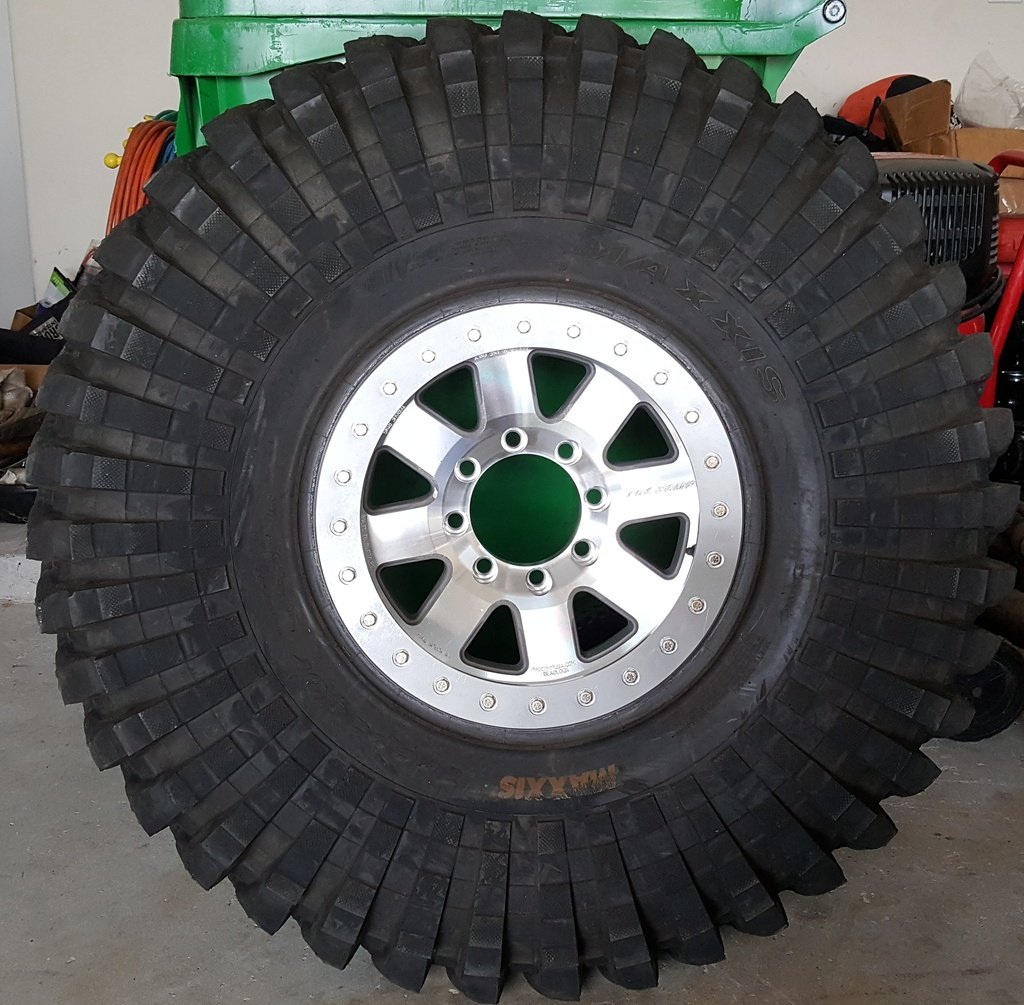

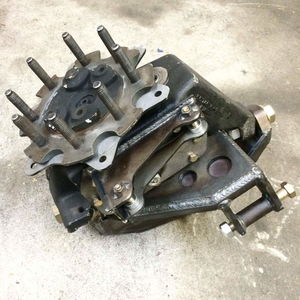

    I used the photobucket-workaround tech we built for TW to restore this guy's thread on here (I'll remove it from here if he requests it)

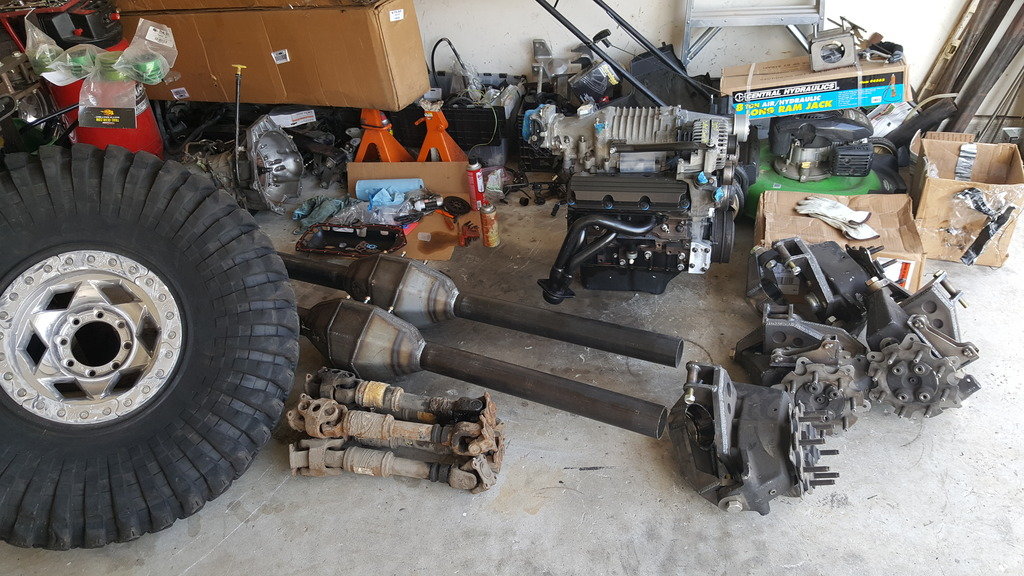

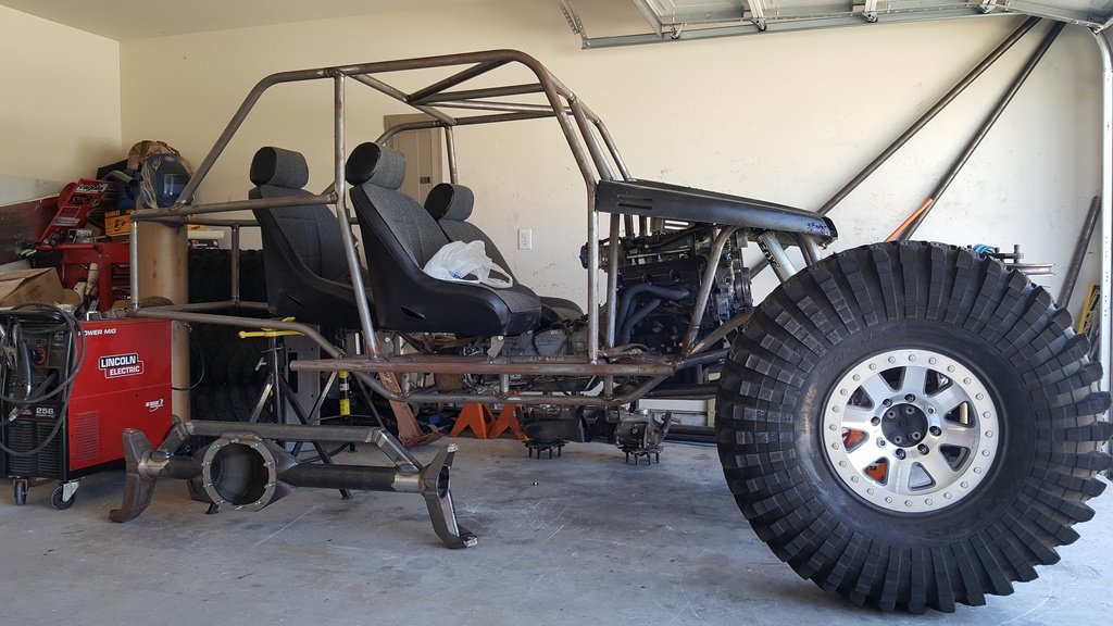

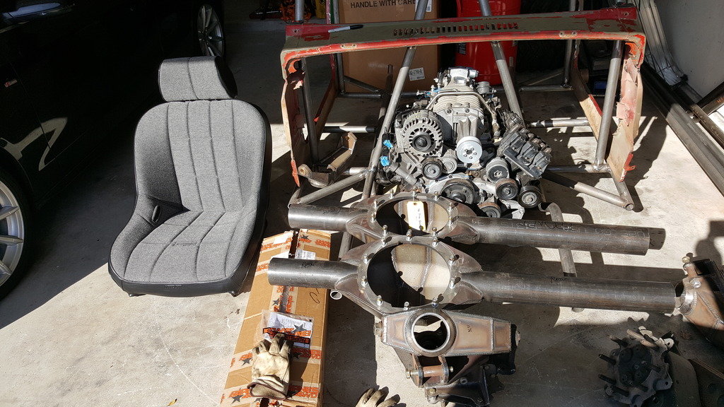

    I guess I've got enough parts gathered, it's time to start a thread for the new buggy. I had a little glitch in custody, so the old Zuk had to be sold to get my son.

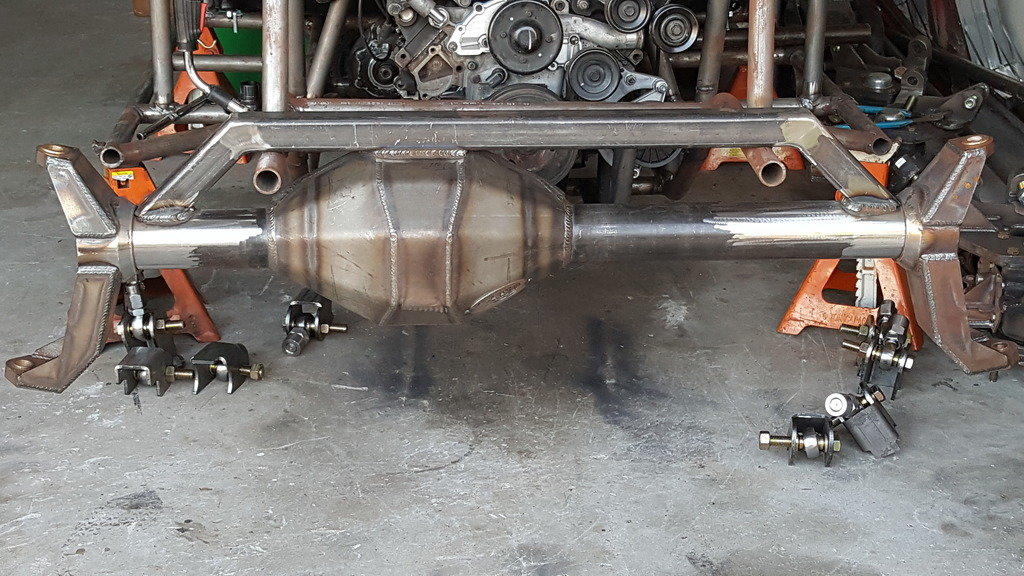

    Had a little left over, so I ordered the best axle parts in rock crawling from Jesse Haines. He shipped me a pair of Trail Gear housings, 14" Spidertrax rotors, RCV outers and 4 Pistons Willwood calipers. I decided to run the same drivetrain as the last buggy with a little more power.
    Parts list includes-
    2004 GTP Series III
    AW4/300
    LP 4.56 Yukon 3rds with Grizzly Lockers
    H1 Portal outers/ Trail Gear housings
    42" Treps on Procomp Vapor IIs
    And a little Zuk sheetmetal
    Wanted a little more backspacing, but didn't have the money for forged so I grabbed these.

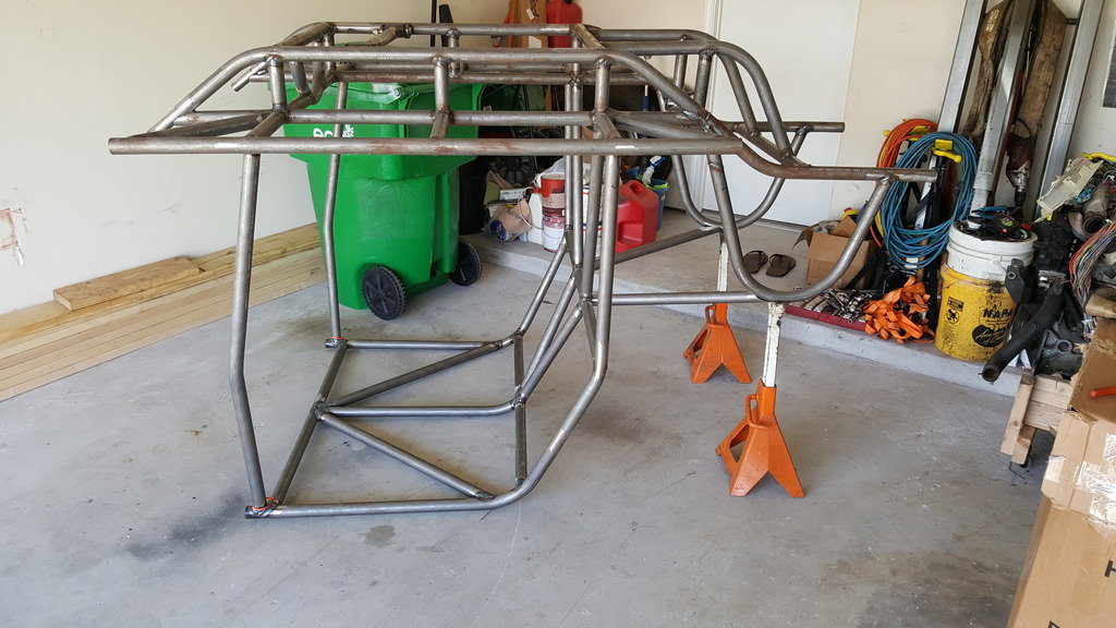

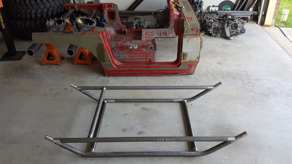

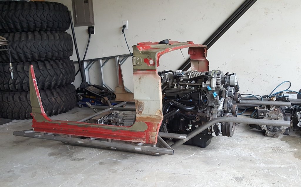

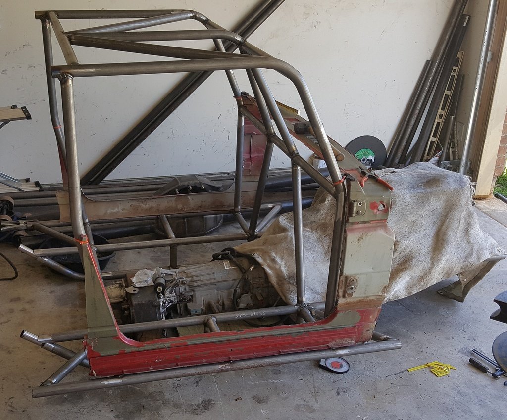

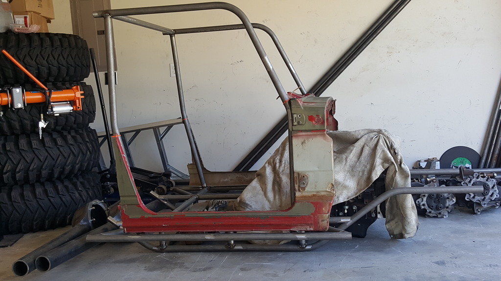

    Sourced a mangled tub for a few bucks

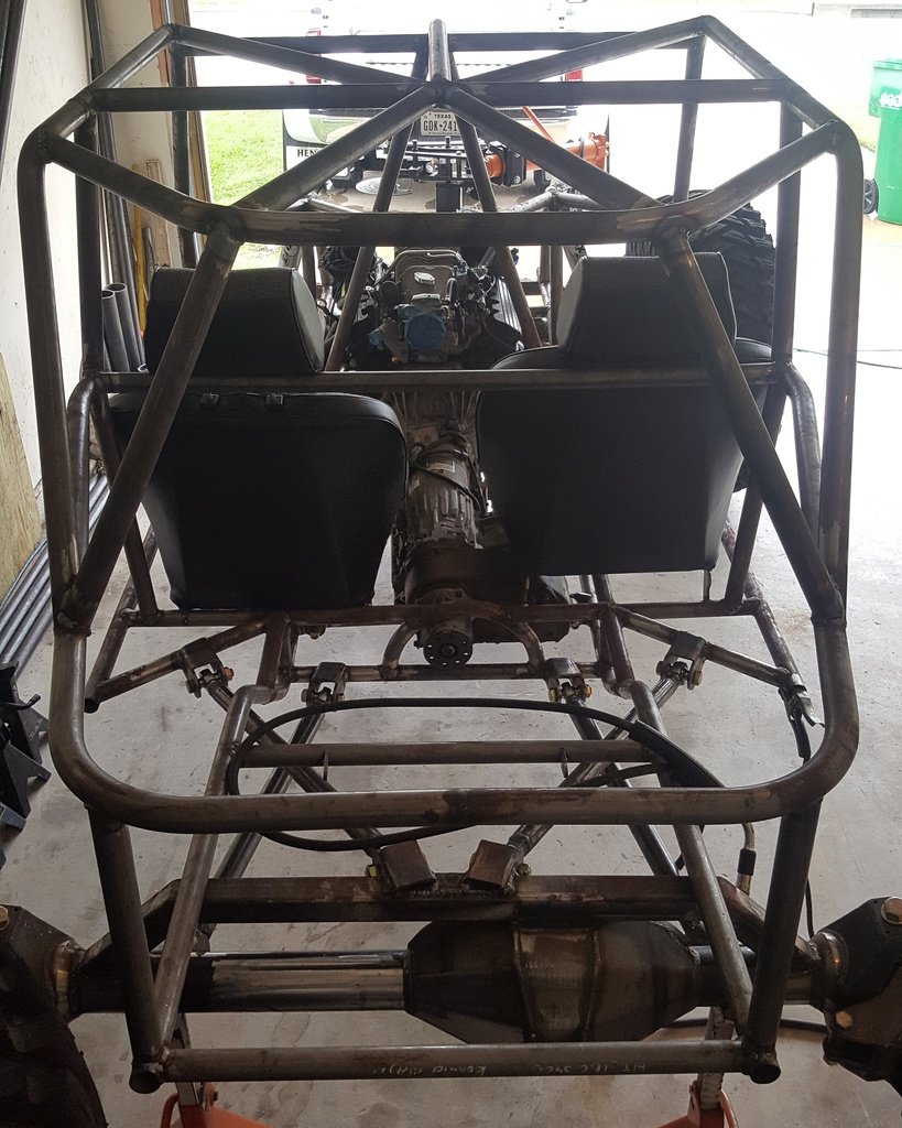

    Started on the subframe

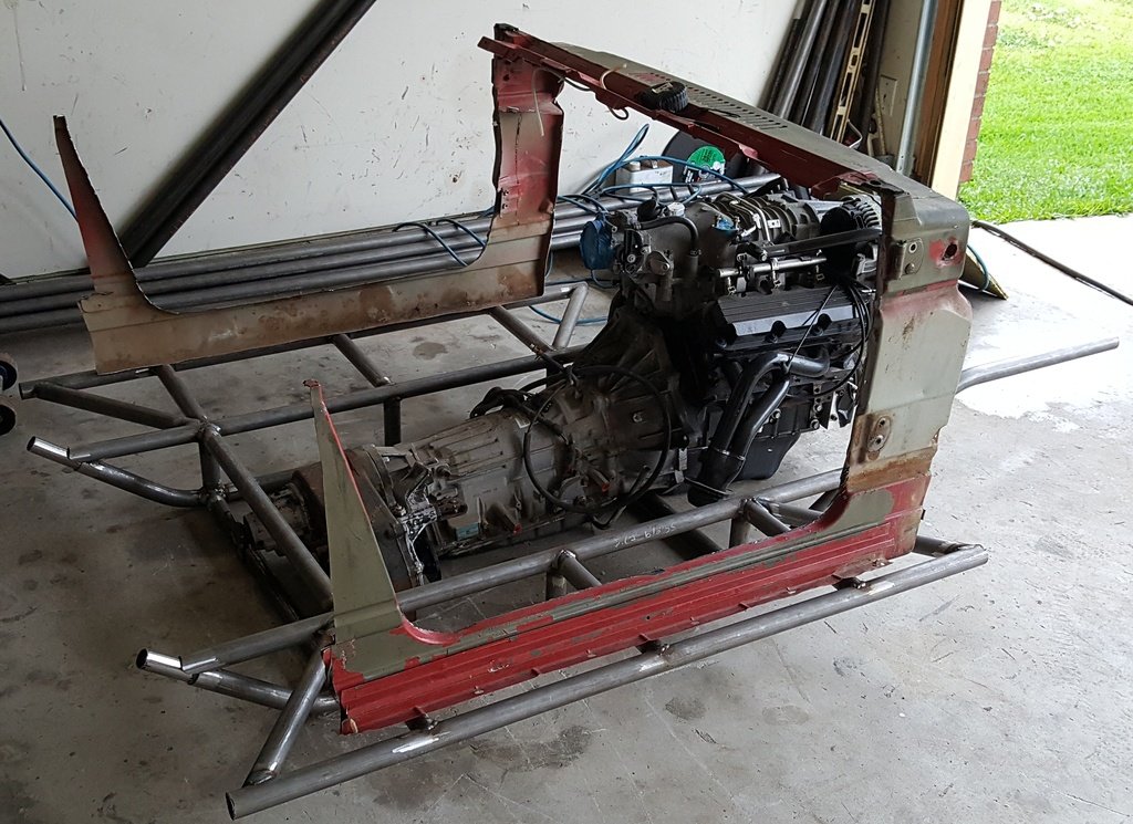

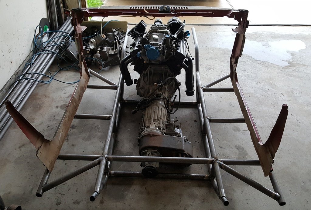

    Set the drivetrain in to start on crossmembers

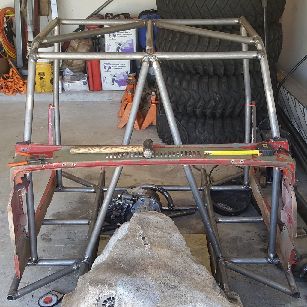

    Hope to start the A pillar tomorrow, and measure the housings to be cut down.
    A couple hours a day...
    Some Yukon goodies came in today. A pair of LP 4.56 3rds stuffed with Grizzly lockers.
    Same motor as the last one, just upgraded blower and cam. They scoot pretty darn good, Jesse put one in his Ultra4 car several years ago.
    My OCD got the best of me and I chopped it 4" biggrin_4f9bea04710693dc216c2b241ffa1bb131ec7498.gif
    I'm wheeling it at EJS, I'm just sandbaging the pics

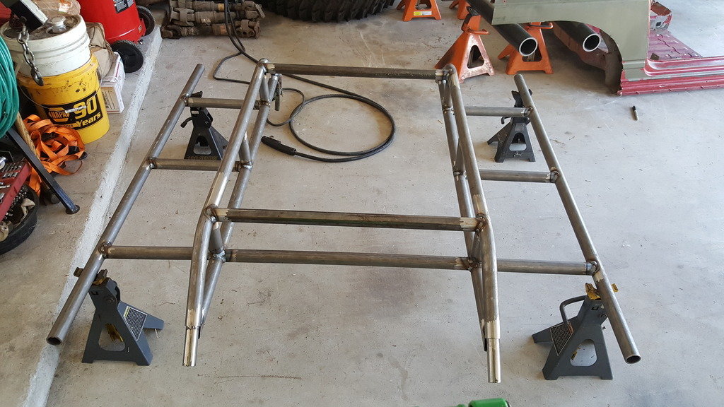

    I got 8 tubes knocked out before taking a lunch break.

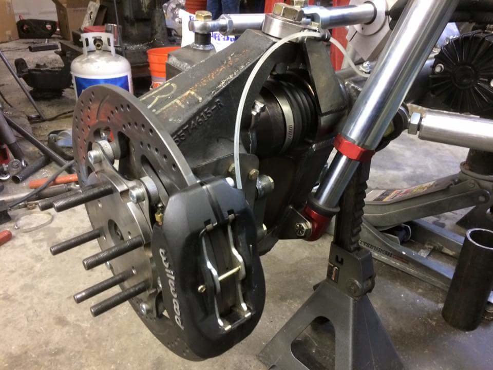

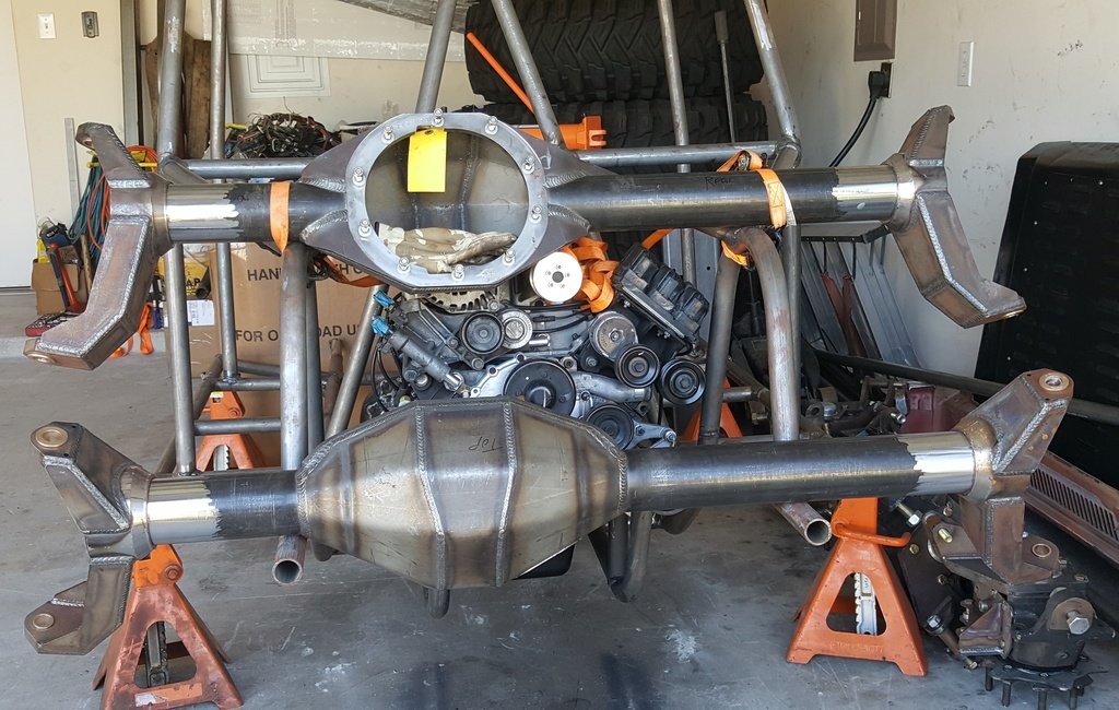

    Got the housings cut down, all of my link/shock mounts, and 3 low backs for the new whip yesterday. Guess I need to make some progress on the Cs.
    If you look at my first set of pics, you can see the caliper bracket that bolts to the portal, and the rotor hat he makes the studs press through to hold on. Then you use the Spidertrax rotors and supplied bolts with some spacers. Here's a pic from one of his builds.
    One more thing knocked off the list. Hope to get the drivetrain mounted this weekend.

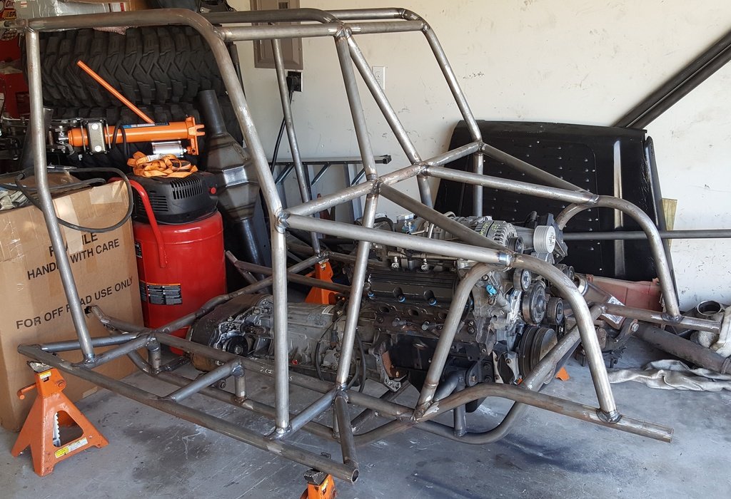

    Did my best Liquid Iron Industries impersonation today with the engine skid/motor mounts, and got the rear crossmember in too.
    The eliminator actually has two bends in it, but I went simple. I shouldn't have an issue with portals and 42s, but I hit the last one. So I figured I'd try something simple to protect it better.

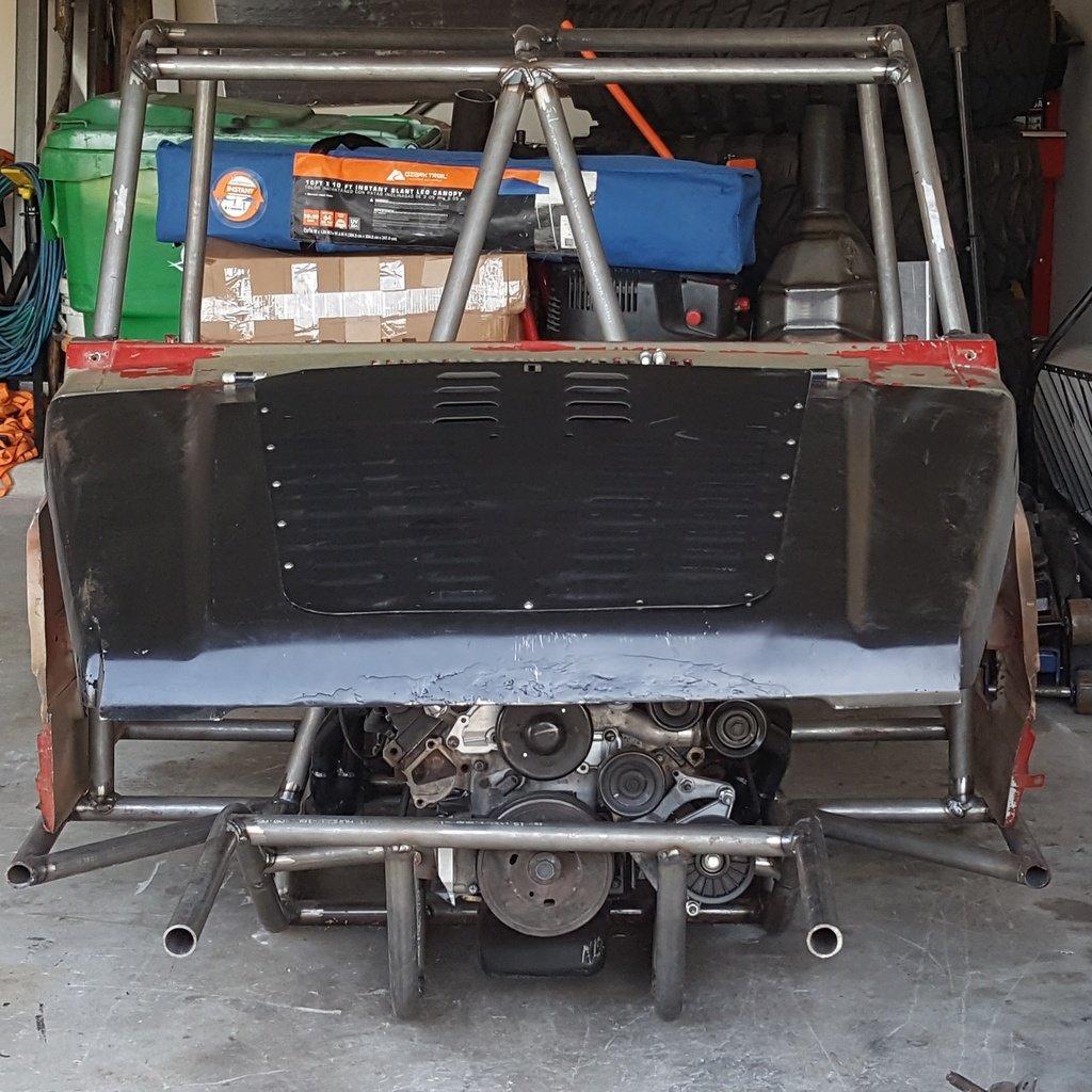

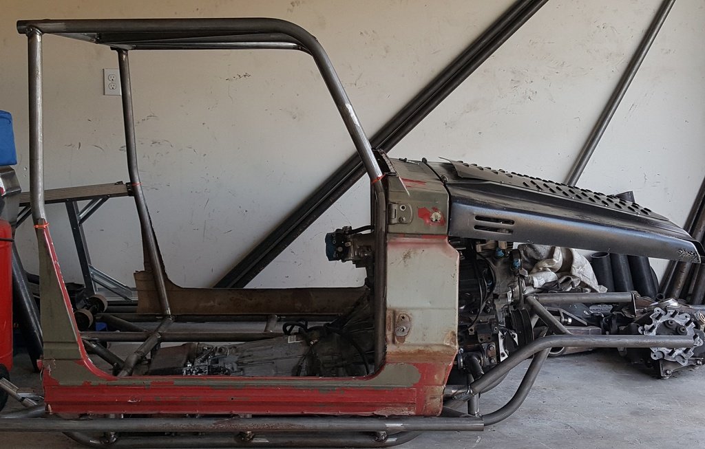

    Keeping the hack job theme, I picked up a hack doved hood. I hate welding sheetmetal, so that part is at least already done. Still needs work, but it's a start.

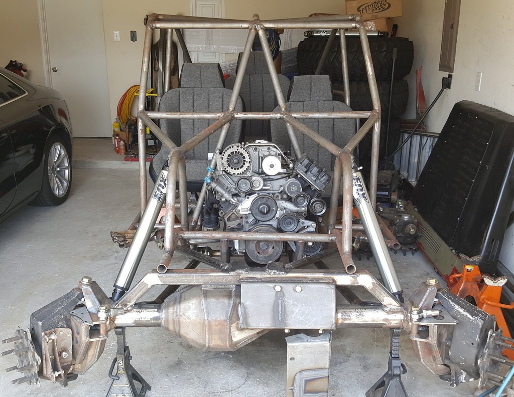

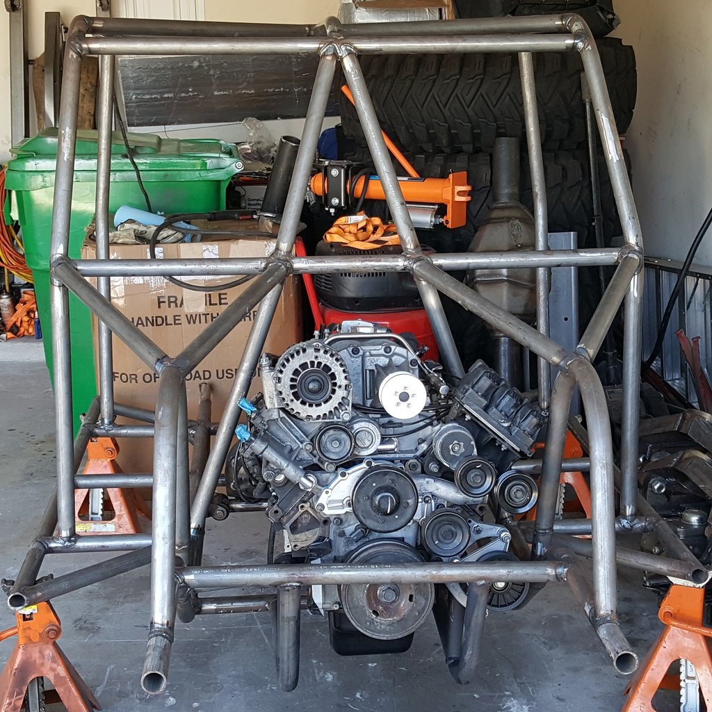

    Got the hoops in this morning. Then my arbor adapter stripped on the notchmaster, so I'm done for the day.

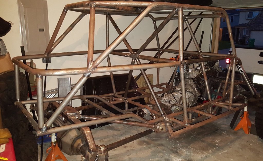

    Fully welded the underside, put Barnes4wd gussets on each frame outrigger, shortened shock hoops 3.5", and added a few more tubes. "Technically" the motor pulls right out of the top. Gotta drill the flexplate, and drop the motor back in. Then rework the headers a smidgen, and get seats mounted in the front, so I can figure out how long to make the stern.
    Permanently mounted drivetrain, swapped Camaro pan, and finished the outer A pillar to shock hoops tie-ins.
    The day wasn't a total loss. I got the Jesse Haines Fabrication Portal Cs on and ready to burn in.
    The front should be ready for links tomorrow.

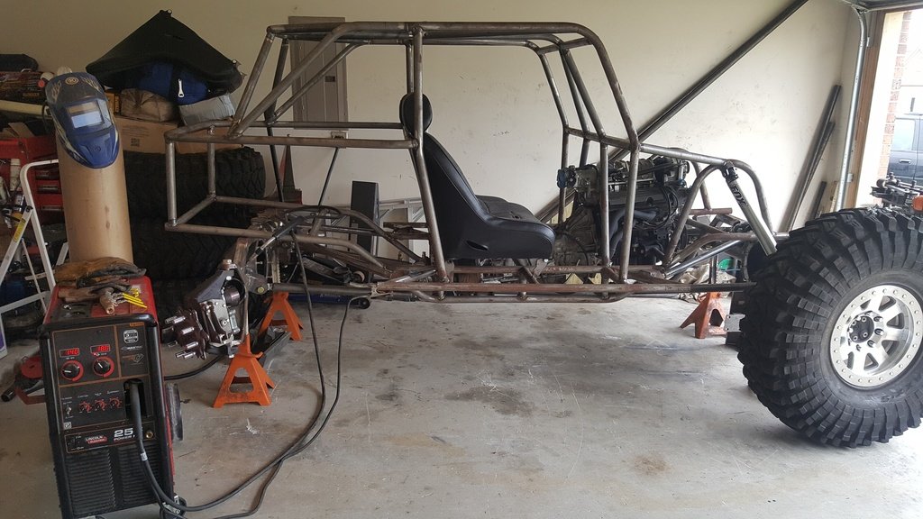

    Front links are in, and the seats are mounted.

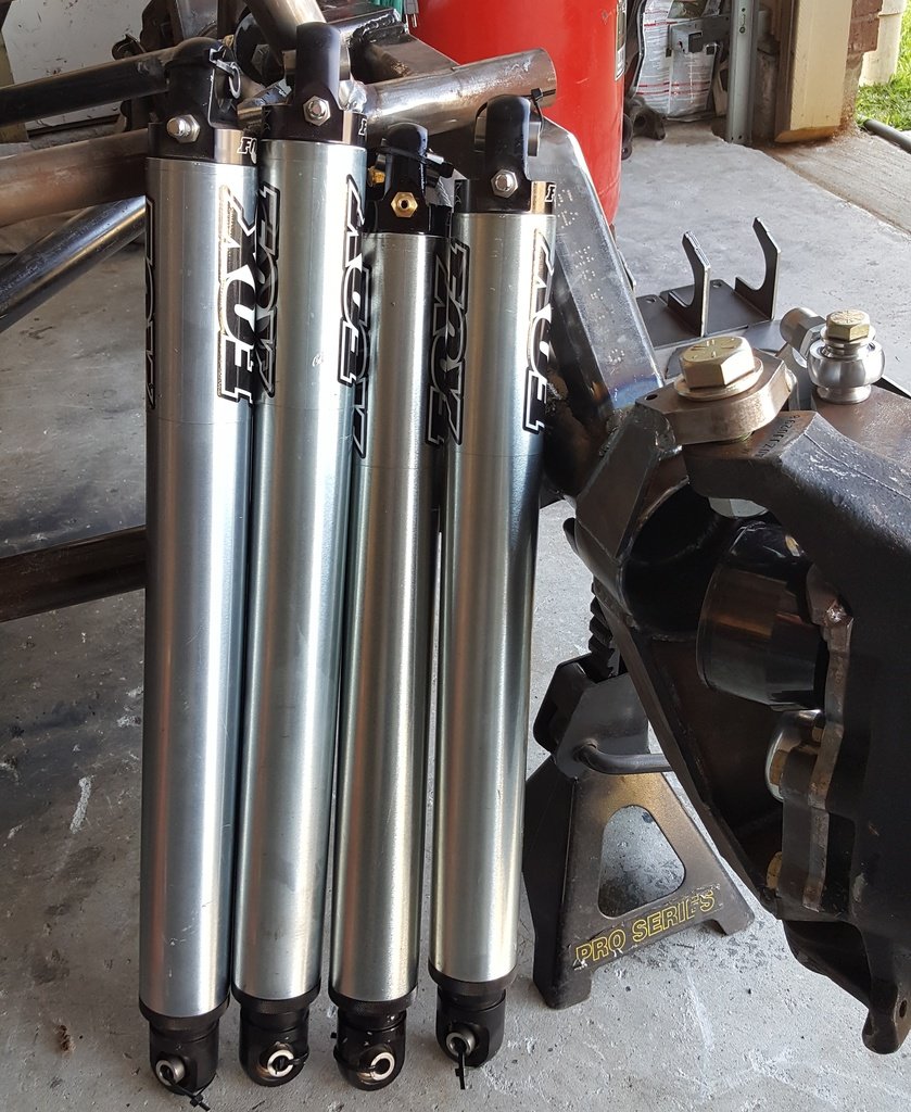

    Picked up some used shocks, and UPS was kind enough to brake another Schrader valve.

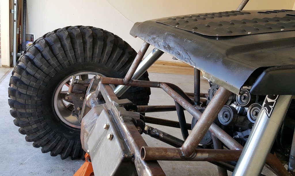

    Got the Goatbuilt ram mount on, and the 2.5 Fox shocks mounted this morning.
    Had to check clearances on the Jesse Haines Fabrication portals, and I'm pretty happy.
    Approach angle at 108" wheelbase.
    18" belly, 24" at the tube, 20" at the diff at bump on 42s.

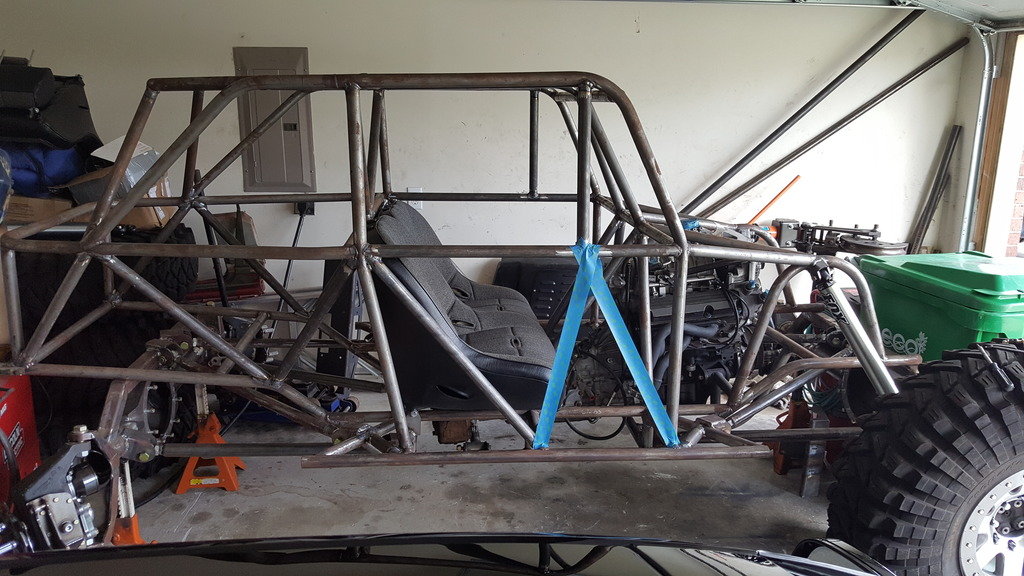

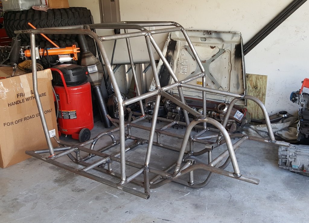

    Knocked out the rest of the rear/ top of the cage and the harness bar. Now I need to figure out the X bracing behind the seats.
    Grabbed a couple valves for the fuel system plumbing.
    Put the X bracing behind the seats, started on the door bars, and tied in the passenger C pillar to the bumper node.

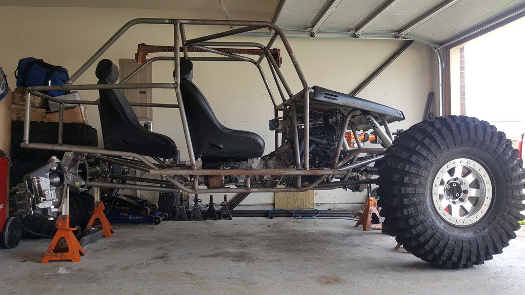

    Side profile shot of the laced up rear.

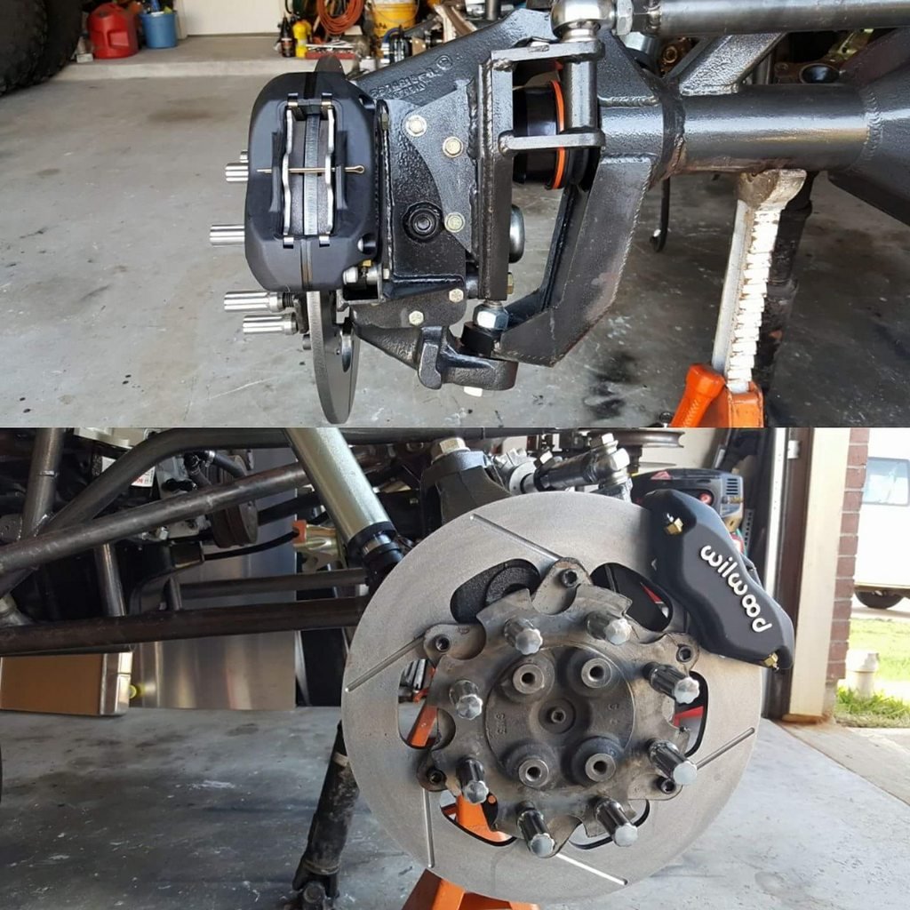

    Brakes came in from Kartek

    Love the caliper coverage with these things, and they don't look too bad for used. They should help narrow things up a good bit.
