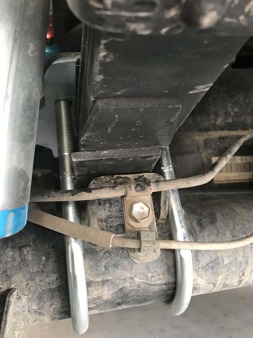

    Dunno if it's installed correctly. Ain't much to it.

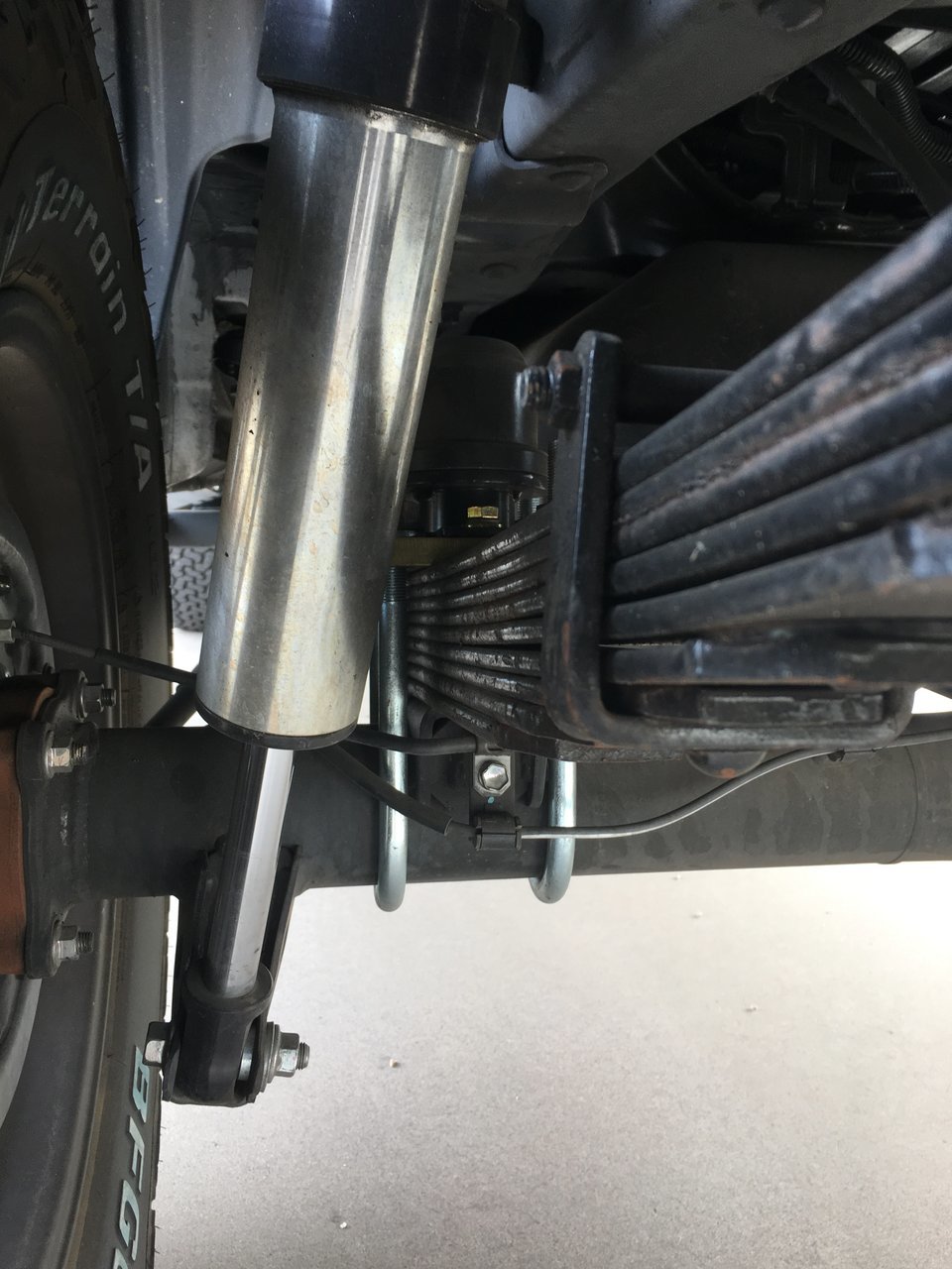

    edited again: After looking at this more and more it looks like your leaf is in backwards, sorry for the edits.
    Yours:
    Others:

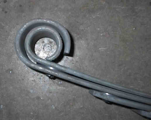

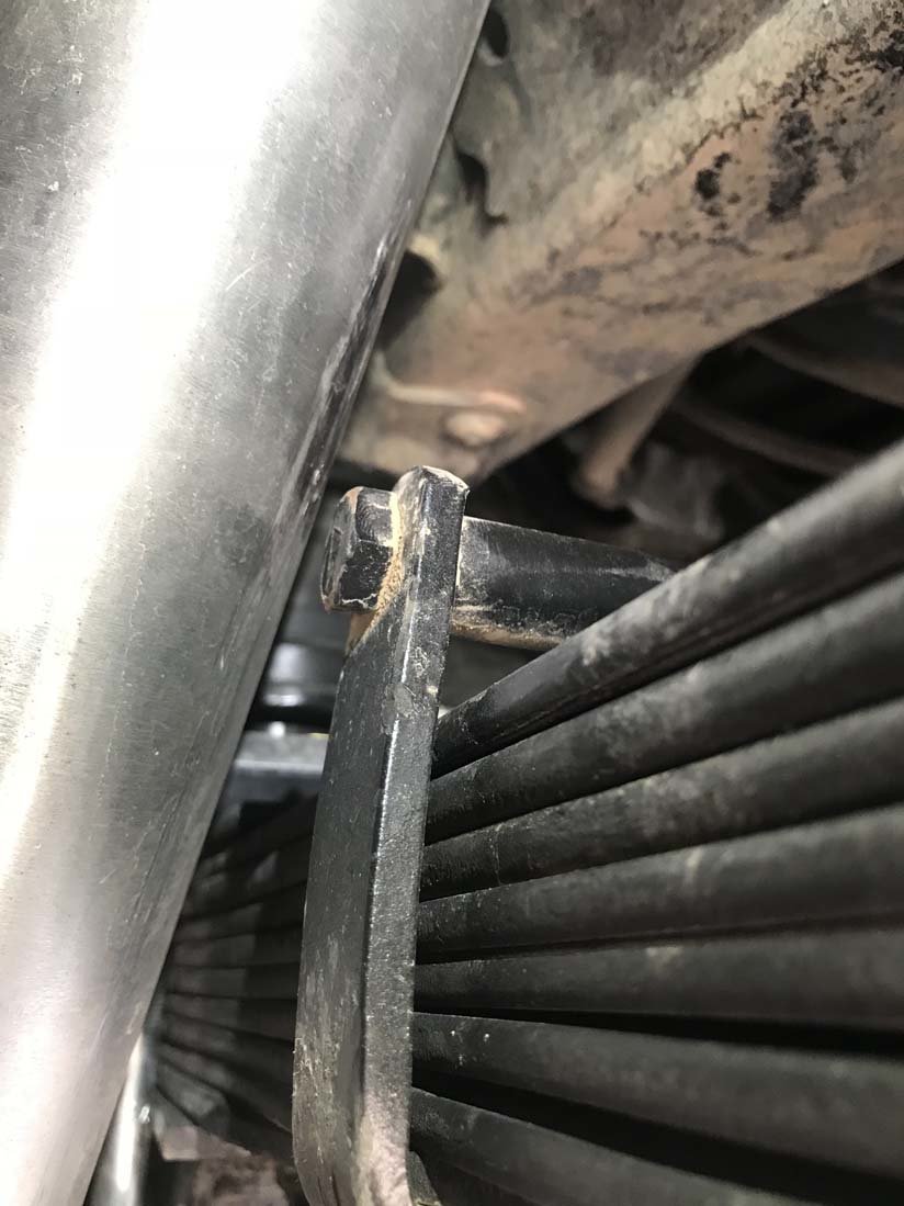

    Thanks. Quite a difference in space between the bumps and springs.
    Per AllPro's instructions:
    Here is my passenger side rear mount. Did I misunderstand what the double wrap end is?

    Not sure why those bottom leaves shifted so much. U-bolt flip or not that shouldnt happen.

    That looks right. The double wrap is like the double coil around the spring eye.

    This side to the front.

    What looks out of place is the third or second leaf from the bottom that had the clamp bolt. It could have been assembled incorrectly from that manufacturer. Spin that sucker to the front and good to go .(I left out that you will have to remove and disassemble the leaf packs)
