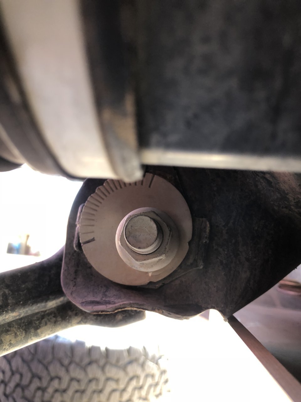

    Well shit, didn’t know rear lift could throw off alignment

    Going to call sdhq to see if they have any of those TC gussets in stock to get them installed and then alignment

    How much does the rear axle have to move in order to push alignment this far off? Something doesn't seem right here.

    Probably not much. Maybe 1/2"-1" is all you would need for the wheel to be off

    :notsure: Went from 1.5 aal to Dakar’s 2.75 lift

    Well I’m assuming my alignment tabs aren’t helping 7B861D01-BD88-4683-811D-B6AD32FC9F02.jpg

    But is the axle centered? U bolts straight? Even with a center pin, you can get the axle to be mounted off center which would throw the alignment off. Measure from your tire to the frame on both sides and see if they are equal. If not, the axle isn't centered and/ or something isn't right.
