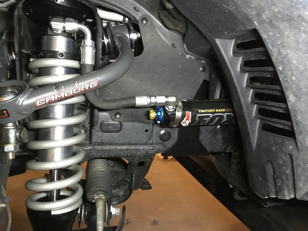

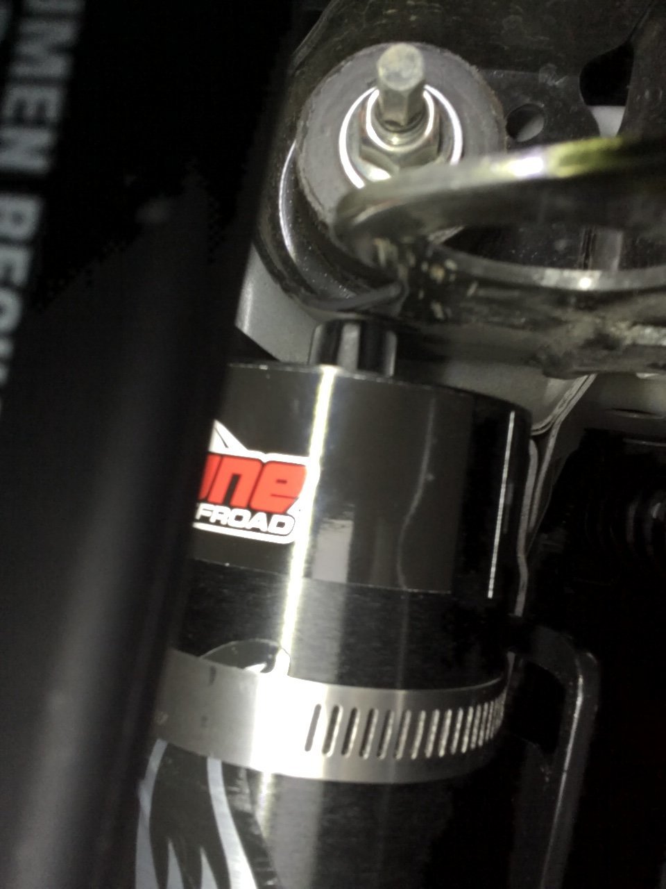

    :anonymous: I'm stuck.
    There's no way for me to mash this resi into position and I dunno WTF is going on... everything installed per instructions.

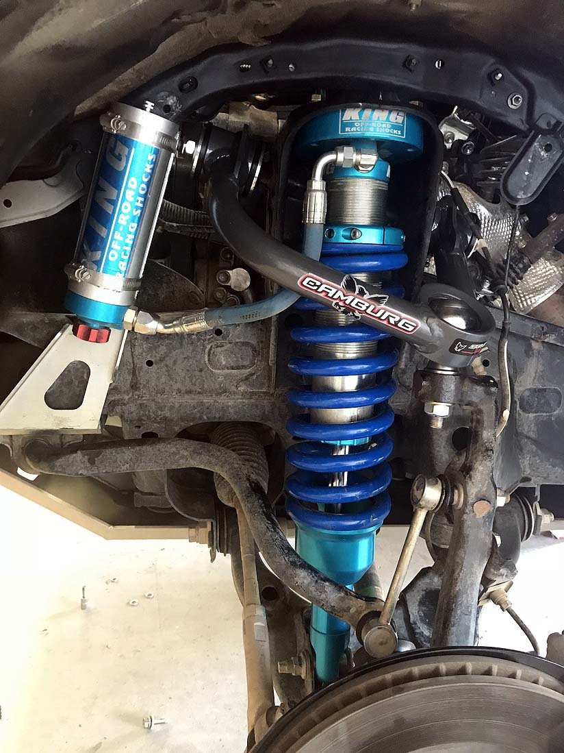

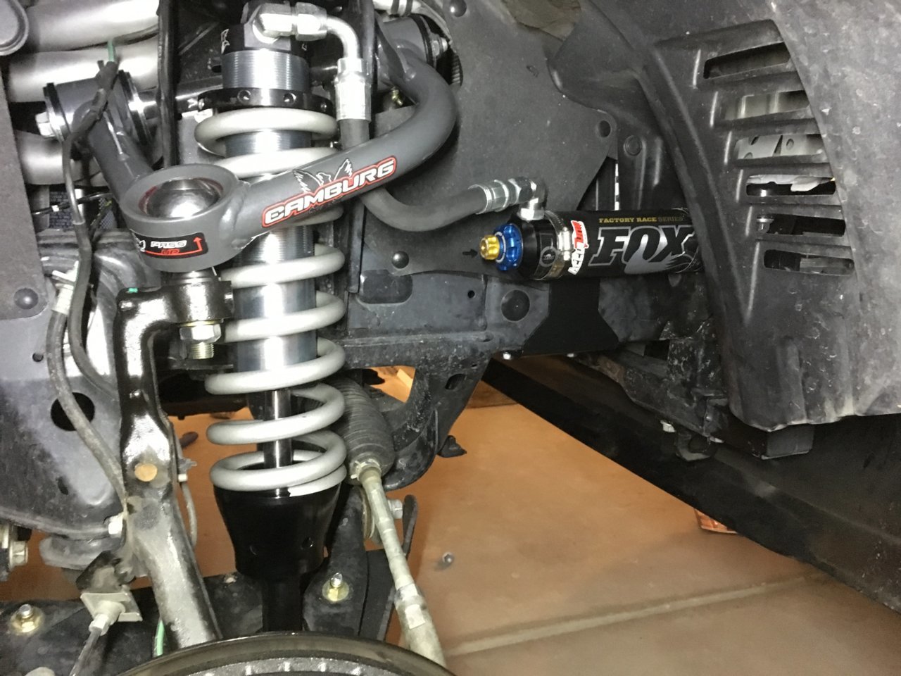

    If it helps tis is how the superior shock reservoirs mount ;)

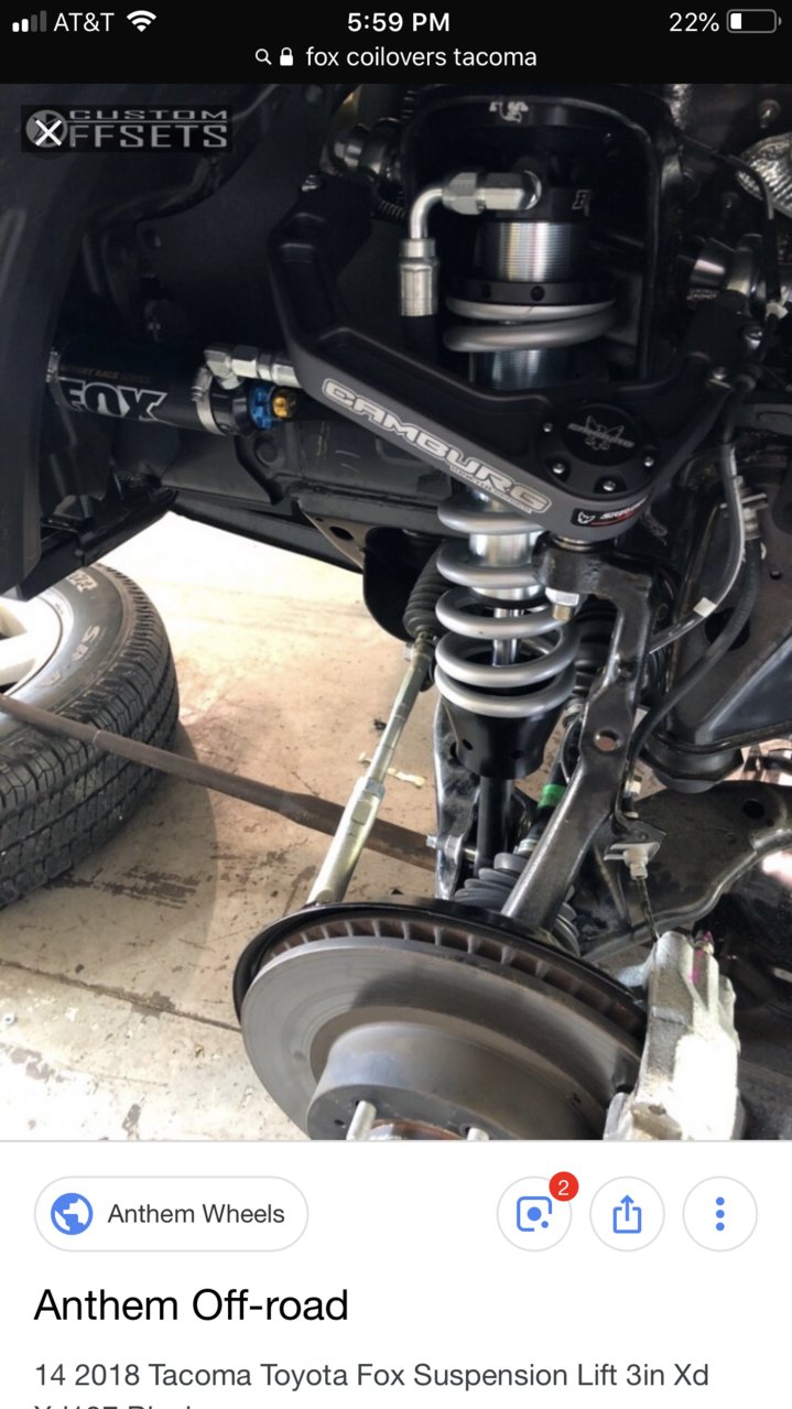

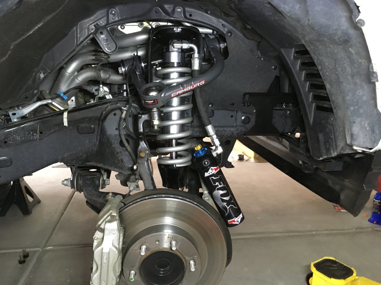

    This ones kinda on a 45, does it even reach the bracket at all?

    The most superior shocks use that style as well:anonymous:5334BAB8-D5D9-45B4-912A-657E699BE9BC.jpg

    Orientation exactly matches the fox pic...
    Gonna go try that after I take a break, just ate tacos lol

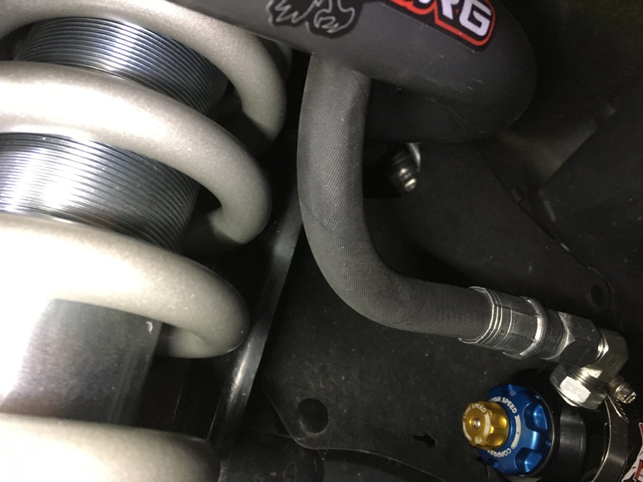

    Might need to crack the hose to rotate fittings to get it to line up. That can make a huge difference. Like 1”+ extra reach.

    I don't like the sound of that but I don't think it will be necessary. The trick was just to get the front into position and get the clamp to tighten, then go ham on the rear pushing upwards to install the clamp. Once one is on, the other is way easier to fiddle with.
    The answer was MOAR STRENGTH :benchpress::muscleflexing:

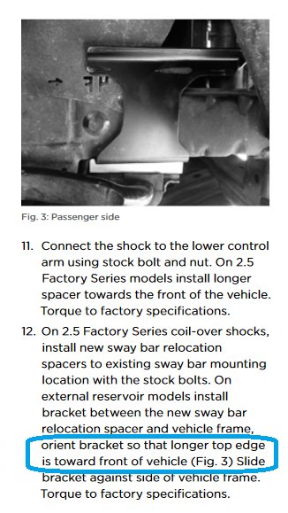

    Clamp is crooked because I realized I had used the clamp the wrong way. I thought the hose clamp was supposed to go thru the holes but it actually just is there to keep the hose clamp from walking.
    From some other Fox install guide:
    That's no big deal, I will run out and do that in just a second.
    Looks like hose and resi clearances are tight but good too:
    Man of Steel TRD and Mike330R like this.

    Someone replied in the Fox thread, looks like I will have to tweak the lines after all to give me just that extra hair of clearance. After that though this side is mostly wrapped up! Only things left are ABS wire clip and adjusting preload.

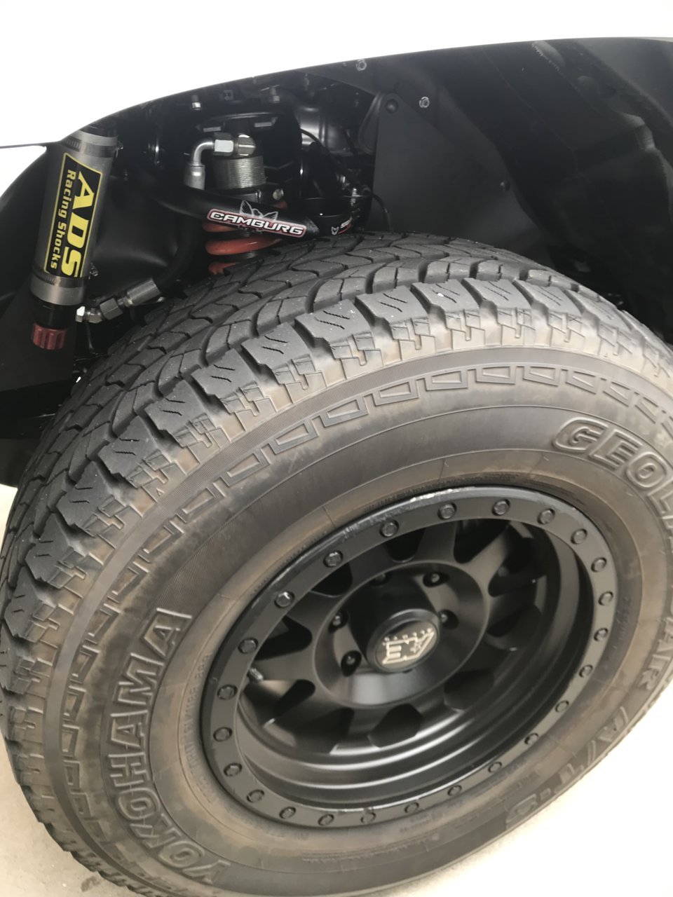

    ^^^^ This. Had to change the angle of the hose on my ADS shocks as well to get them sitting flat on the resi mounts.

    Yeah I see this is pretty much par for the course, I was under the impression the buggers would immediately start leaking and weeping if you loosened them, but I guess I was wrong.
    Still a pucker moment though...

    Yeah since I had never worked on shocks before I was super nervous about cracking the fitting on my ADS shocks and losing pressure but I guess there is some lattitude with the pipe thread as long as you’re not going crazy.
