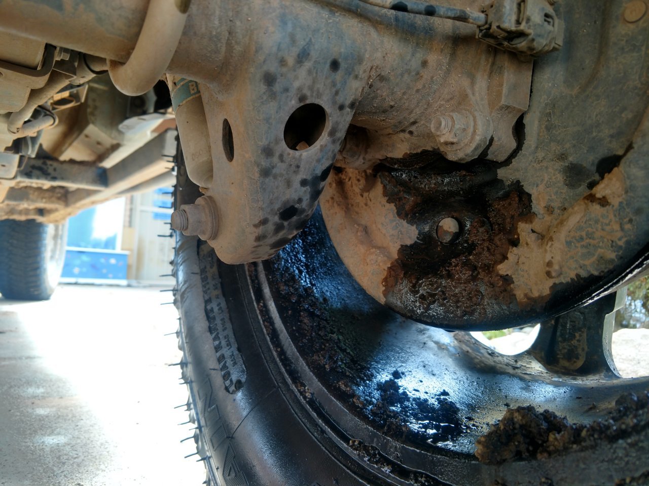

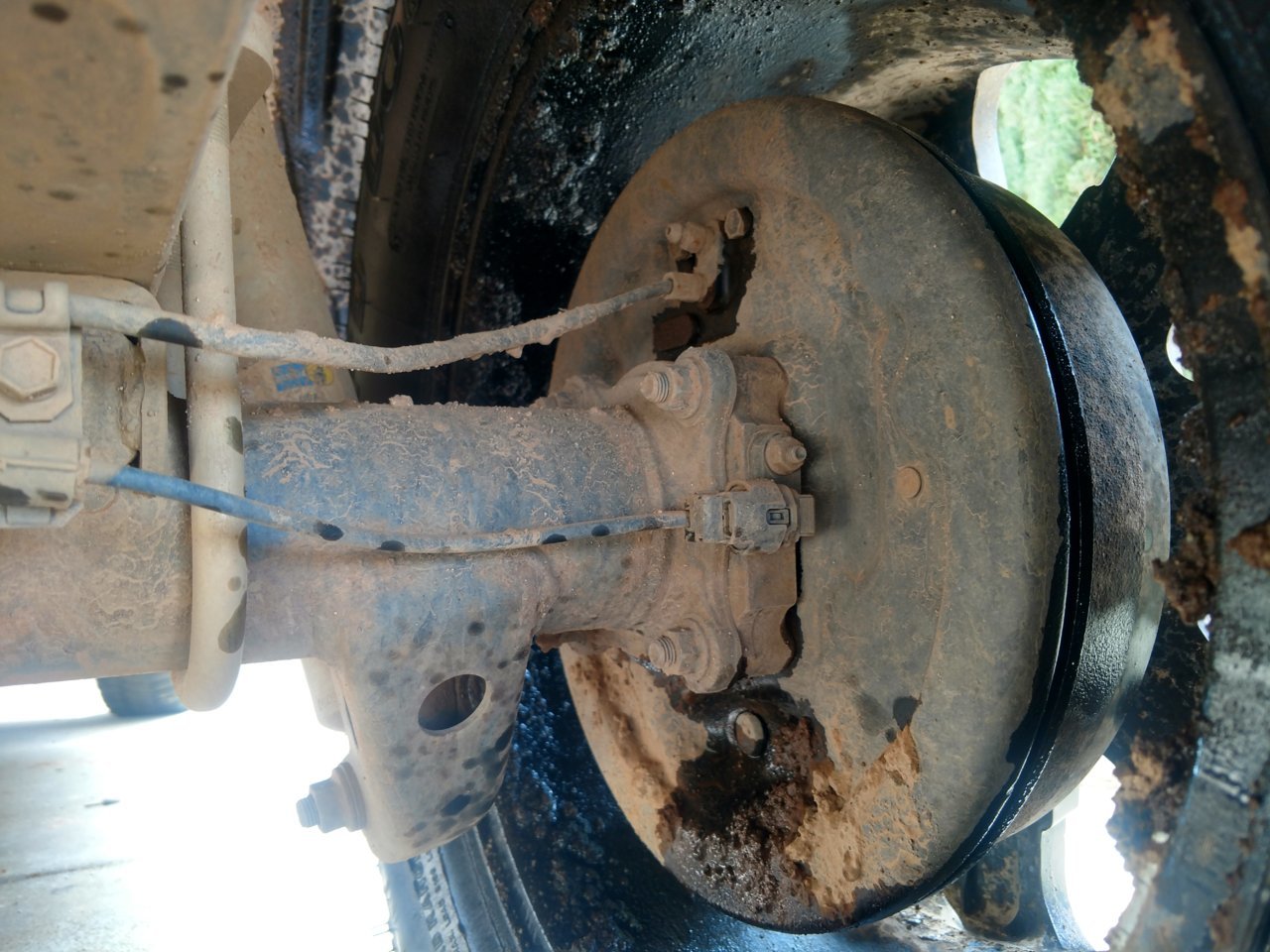

    I lost brake pressure in the burger king drive thru. Pumping them made it worse, like when you have air in the system. Pulled off into a parking spot and shut the truck off. With the truck off, it builds pressure when I pump them. Found the problem on the right rear side. Limped it home and chalked all 4 tires. This is the issue...IMG_20200329_133225723_HDR.jpg IMG_20200329_133232521_HDR.jpg
    Can anybody tell me what's broken? It's hard to tell where the leak is actually coming from. Do the symptoms sound familiar to anyone? Thanks in advance.

    Looks like your cylinder is blown. It's the part inside the drum that pushes on the brake shoes.
    Based on the fact that it's not leaking from the top fitting and then it's dribbling out the bottom of the drum I would bet a seal has let loose.
    Pretty easy fix, and parts are cheap too. I think even OEM it's like $40 for the whole cylinder.

    Nice! Thanks for the quick response. How would I go about making a positive diagnosis for that? Pull the drum apart and see if it blew apart? Also, is this one of those "if one failed the other isn't far behind" type of things?

    Yeah if you take the drum apart and see a cascade of brake fluid from the cylinder (almost guarantee you will based on how the outside looks) that's the issue.
    47550-04030 is the OEM part number from 2005 all the way up to current. $45 OEM, RAYBESTOS WC370183 is $12 on RockAuto.
    I wouldn't say the other one is necessarily far behind, but given how cheap they are and the fact that you're already gonna be bleeding the brakes, I would say take the opportunity for new cylinders (and shoes, for that matter) on both sides.
    Drums are enough of a bother to work on that if you can swing it at this point in time, might as well do a full refresh.
