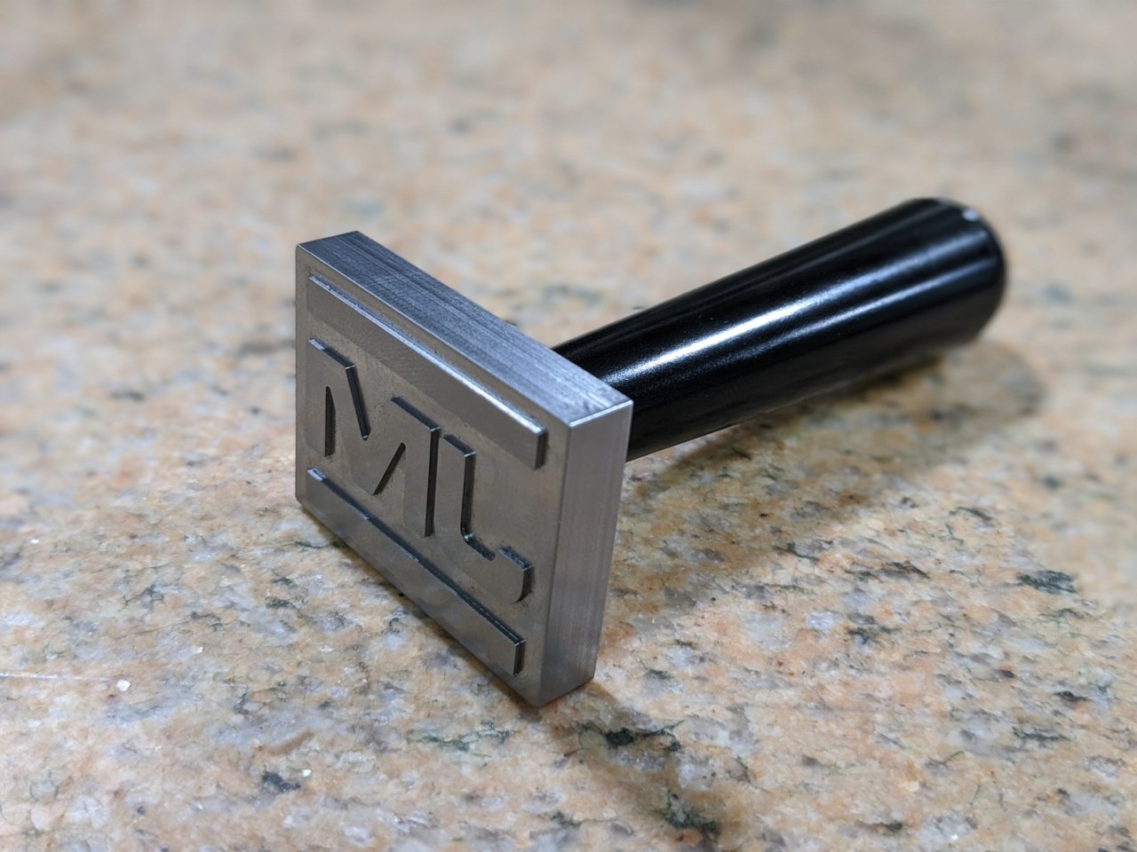

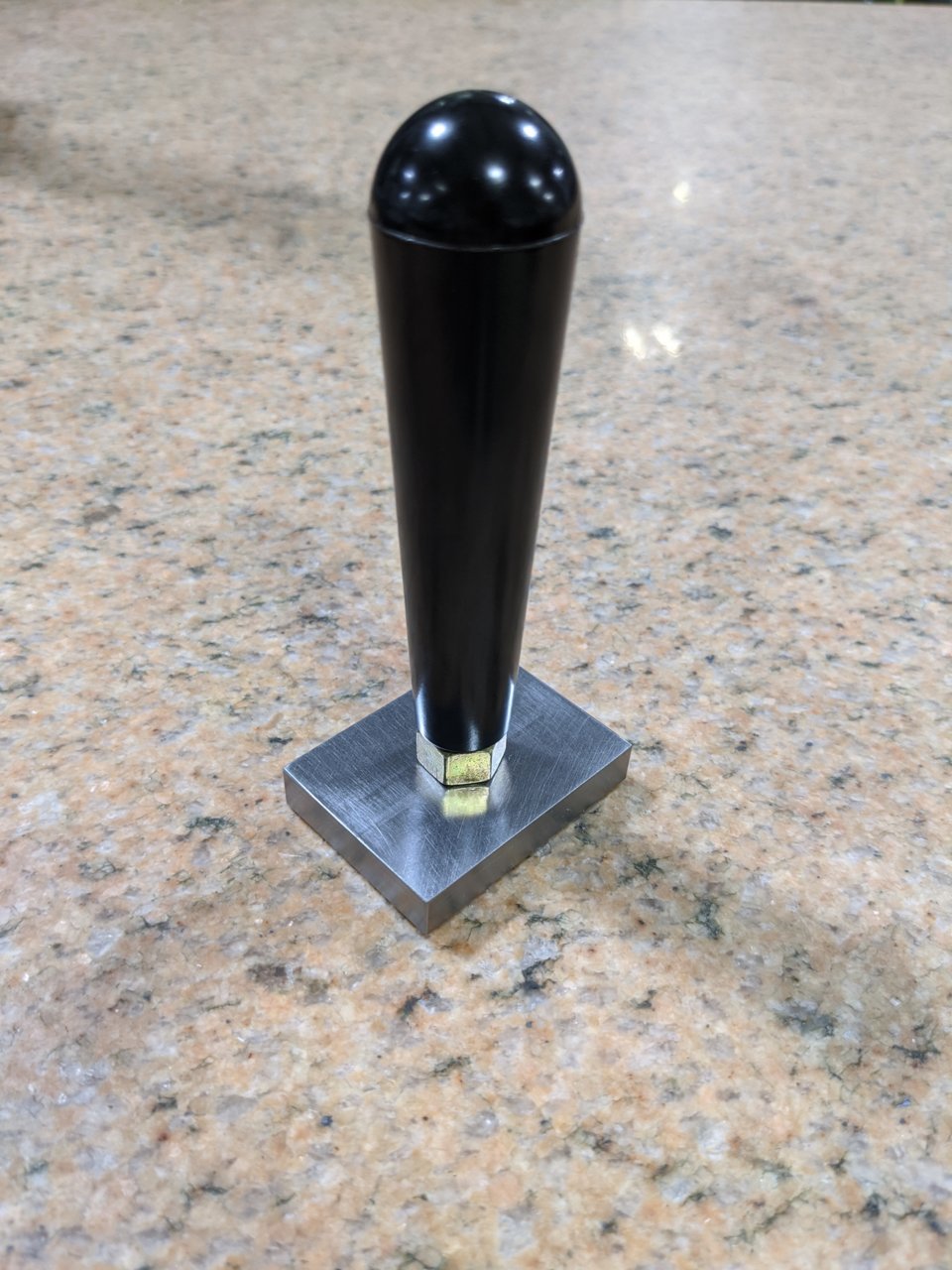

    Finished up this little project today. Woodworking Brand for my Grandpa's birthday this weekend. Finished it off with a Heat Resistant handle from McMaster.

    Probably a dumb question, but wouldn’t that be backwards? Or am I dumb haha

    It’ll be JM I’m assuming

    yeah that’s a j not an l. lol. at first i thought it was backwards too.

    correct. JM when stamped. obviously needs to be backwards. Hopefully it works well! Gonna heat it up and test it later today on some scrap wood... Then brand the box its going in.

    How well does it work? Do you happen to know the height of the raised section, or spacing between characters? My main concern is that its not tall enough, and that the spacing between the J and M is too small, and that both may contribute to some bleeding/heat transfer. If that makes sense.. lol

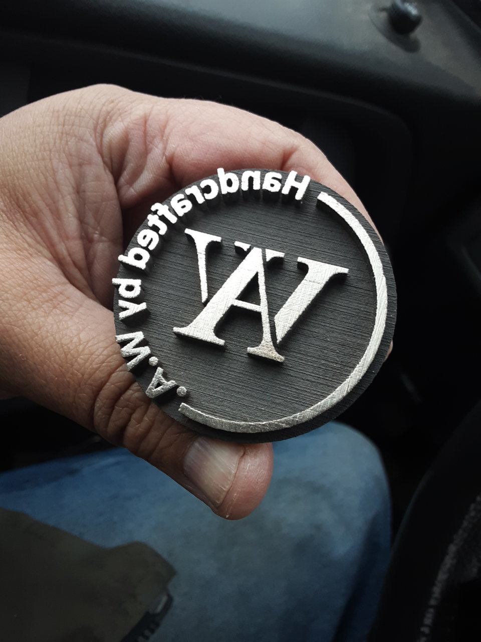

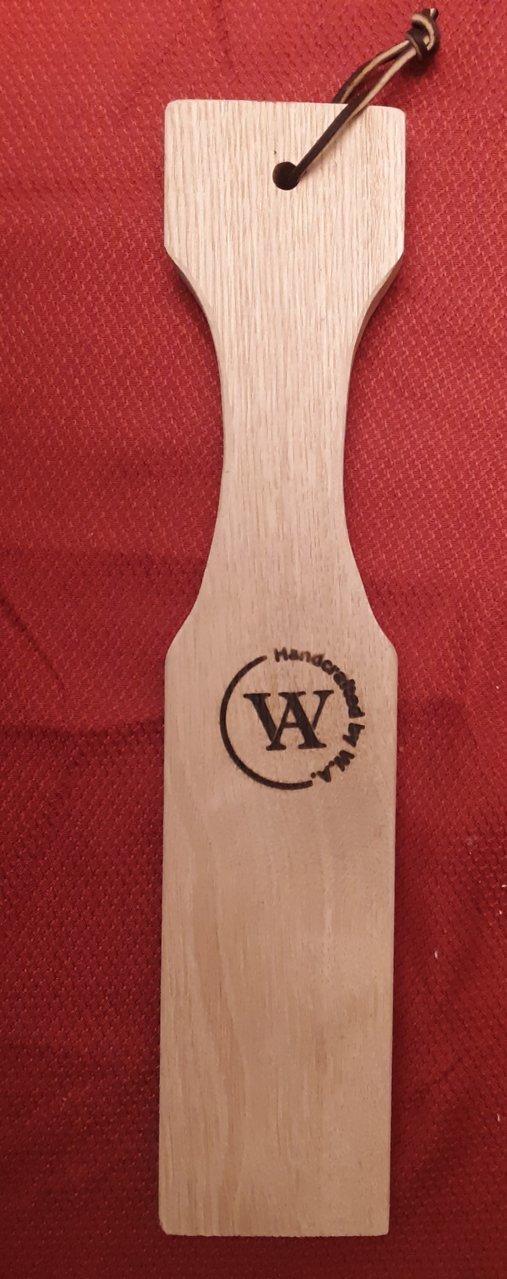

    heres mine. Doesnt need to be tall. Burning brand takes some learning but not bad. Softer wood is harder to brand. 20191115_113805.jpg 20191215_183031.jpg
    azshooter40 likes this.

    Will
    Bourbon state
    You might have an issue with the handle being close to the brand. I put some pressure on mine to get good contact and solid burn brand

    Will
    Bourbon state
    Also some woods stain the surrounding area with heat and smoke, easy fix is to sand down the branded area and it cleans up nice.

    Thanks for the tips! :cheers: that looks great too. I'll just let him try it out, and whatever adjustments need to be made, I'll knock out another one.
