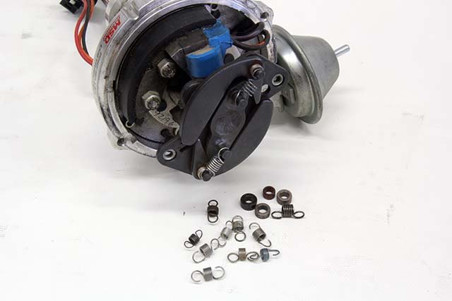

    This is what I had posted on ck5.com and below the picture Ill quote some replies from guys over there.
    "The part that seams to be sticking is the round brass colored valve. When the truck dies this valve is stock in the position you see right now. After it cools off/gets wiggled, I am able to push it in and it slowly retracts. It seems as though its filling with fuel or something. This could be completely wrong but it seems to allow the truck to fire right up when I was able to push the lever/spring into the valve once or twice.
    Also something that was happening this time that didnt happen before is backfiring. Id be cruising along, it would start to stumble if I gave it too much throttle, let off and get back on the throttle and it would shoot a flame out the tailpipe. If I pushed the throttle to the floor eventually it would stall out."
    wilcam47[QUOTED] likes this.
  10. Jun 24, 2020 at 11:04 AM
    wilcam47
    wilcam47 Keep on keeping on!
    Jan 27, 2016
    #176243
    55,272
    Will
    Bourbon state
    You can change those vacuum module. You also have some vacuum line issues. Theres one port on the carb not even plugged. One big one should go from brake booster to a bigger port on the back. The distributor should have a vacuum line go to the base (small line) usually dont see a"T" fitting . One line should go from pvc valve to carb also I believe. One line usually comes off the manifold heater to open or close the choke.
  11. Jun 24, 2020 at 11:12 AM
    wilcam47
    Jan 27, 2016
    #176243
    55,272
    Will
    Bourbon state
    Also theres springs (2ea) in the disributor that control the advance, over time they rust out or get weaker. Could cause problems. If you take off the cap and twist rotor one way shouldnt move then twist the other way and it should move with resistance. Release and should go back to "retarded" position, if it sticks or goes back slowly the springs are worn out.
