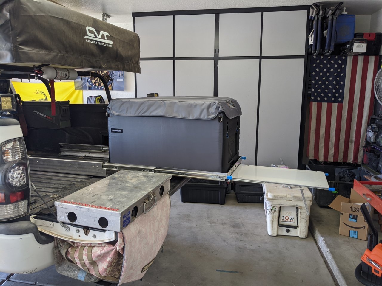

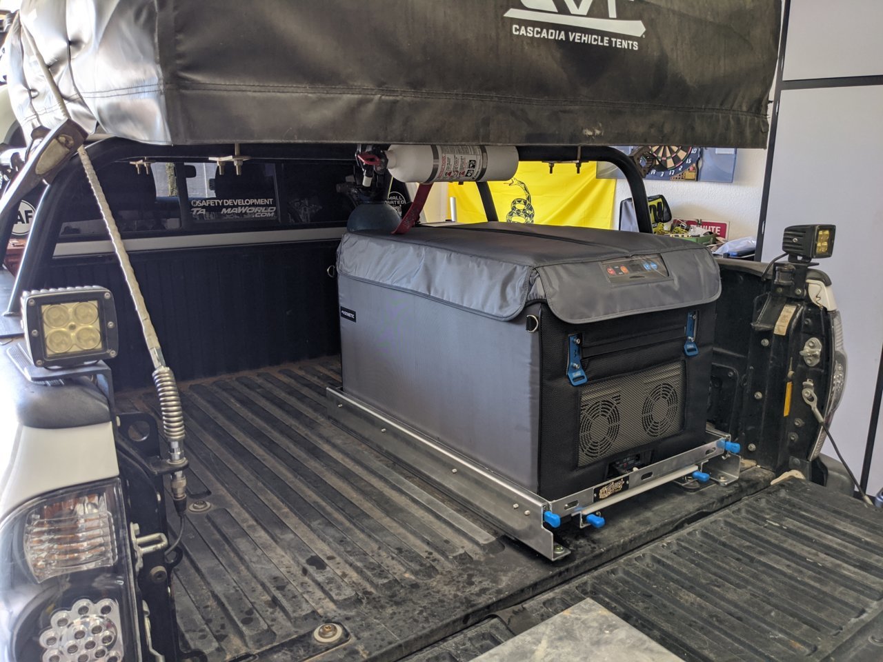

    All mounted up. Just waiting for the MSA straps. Thanks Alex @amaes for the strap mounts. Exactly what I needed. :cheers:

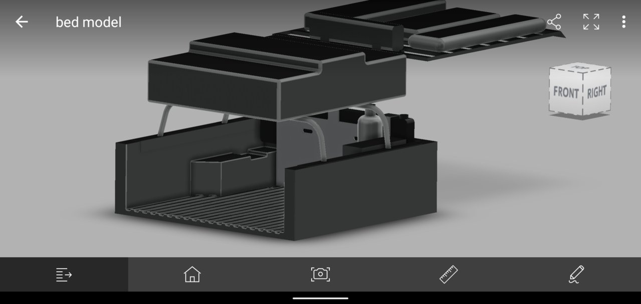

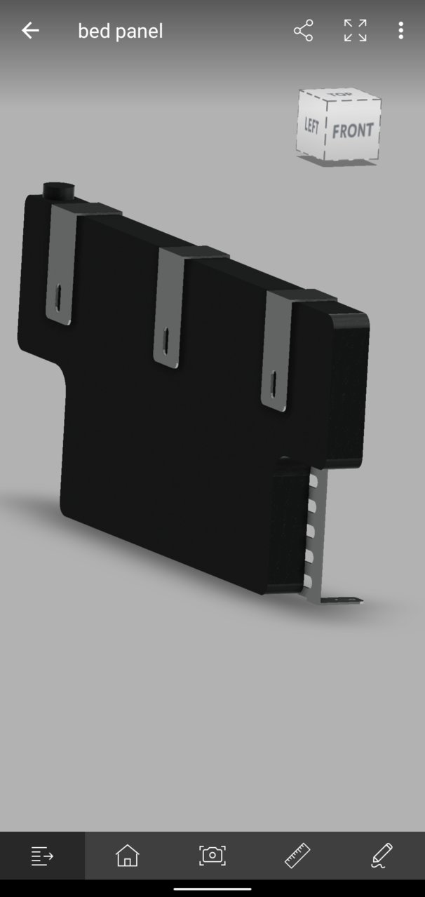

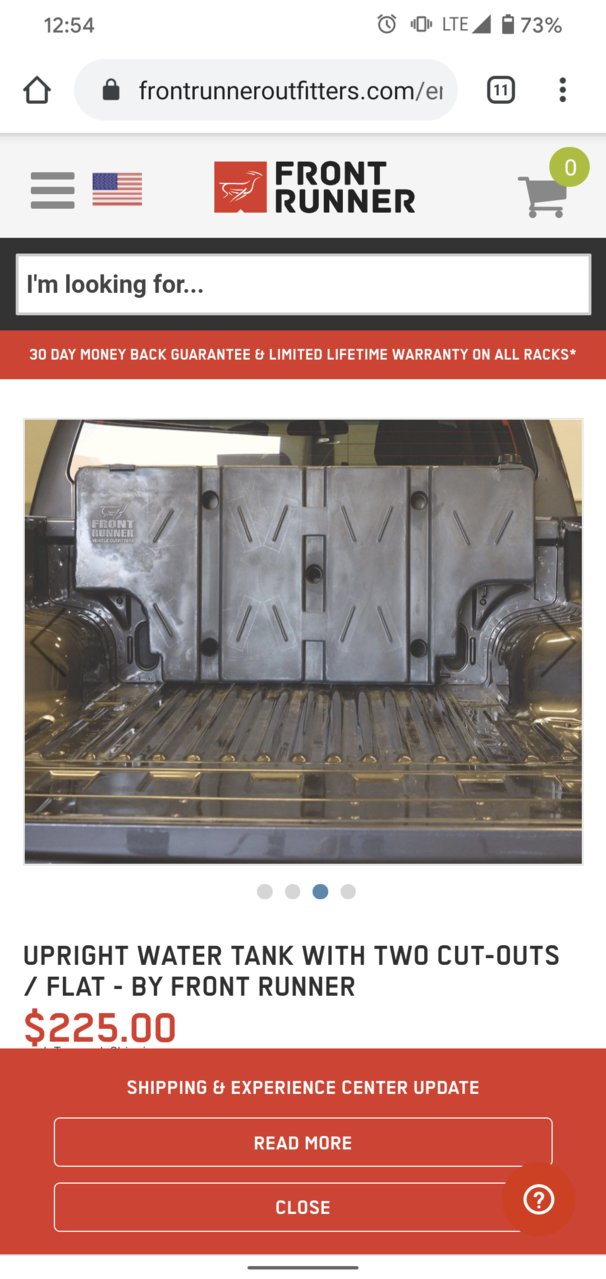

    So I'm in talks with Front Runner regarding their 10.8G flat water tank and how to secure it in the bed.
    I modeled up both the tank and a mount I'm hoping to make and will work for this. At least .190" aluminum. 3 mounts off the bed rail along the back of the cab.. and 2 mounts to the bed bolts. Acts as a mount for the tank, and a load panel for other accessories. Trying to wrap my head around securing the tank tho. Straps. Bolts. They recommend and have used straps in the past. Just not sure how to run them..
    Snaeper, llibrm and azshooter40 like this.

    Similar to the top mounts maybe just have a couple brackets like those for the sides? Just fold over some metal like an L shape to stop it from going side to side? With those 3 top mounts, and doing similar on the sides, if it is a close fit I don't see that tank going anywhere?

    Ahh I see what you mean. Once it's secured to the panel tho, it won't need sideways capture... Maybe. It'll be strapped vertically to the panel. The tank has recessed channels to hold straps.

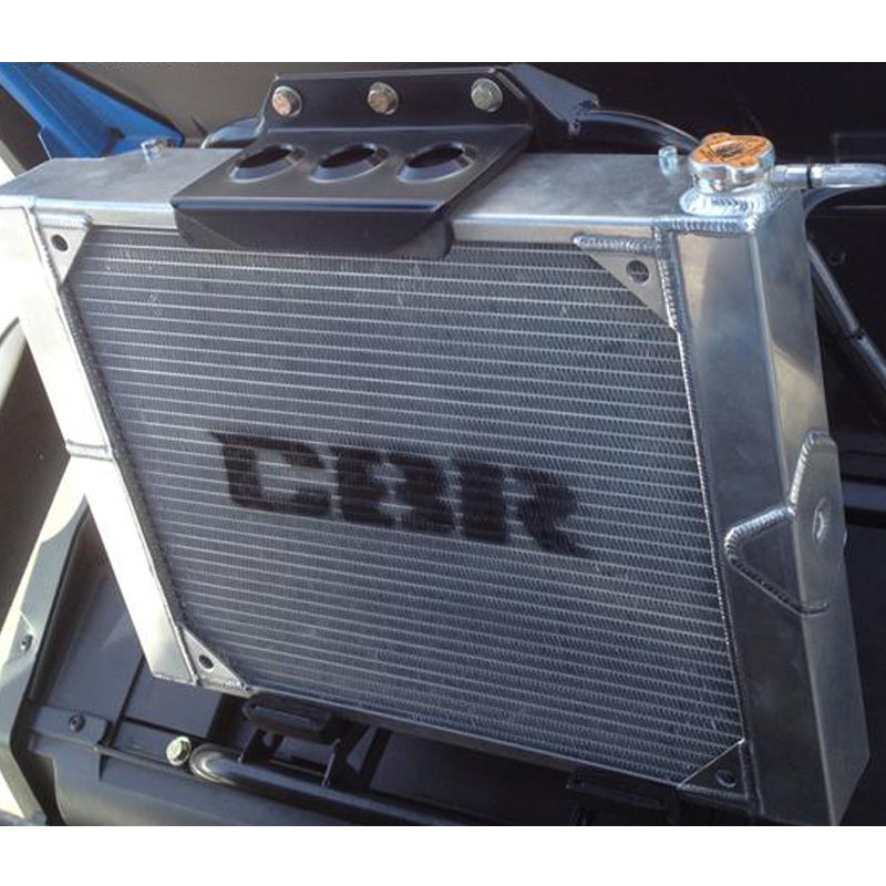

    Cradle on the bottom of the tank that is fixed to the panel, top “hooks” (that bolt to the bed rail) are removable with a bolt on each. If that makes sense.
    Kind of like how they mount radiators in race trucks and stuff.
    have to use your imagination a bit but something like this?
