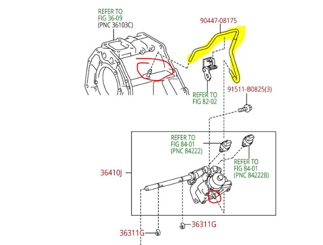

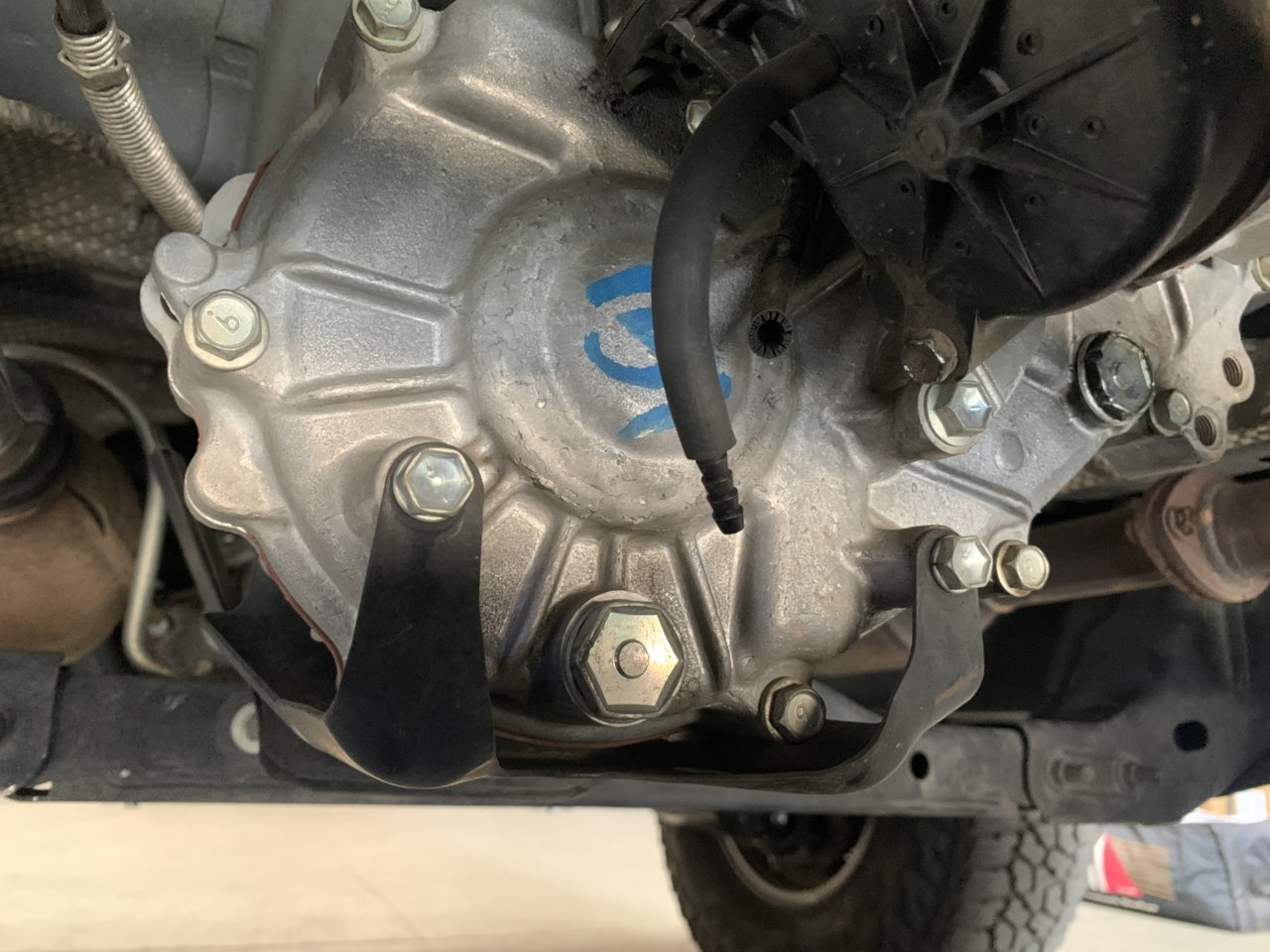

    I just went under truck to get ready to install the modified exhaust route skids. Just noticed this where they did the reroute? Not sure what it is but looks to me like it should be connected. Possibly the muffler guy did it. Anyone confirm it needs to be connected?

    Yep thats the spot. Well atleast I can have some entertainment. I wonder if the have midget dancers yet like I asked?!?! Do you know? Or have you been black balled?

    Yup, not a problem.

    Yes, needs to be connected. Looks like the hose is cracked, Might as well replace all the hose there you can reach while you're at it. That's the breather for the actuator housing.

    There looks like a hose right there plug it
