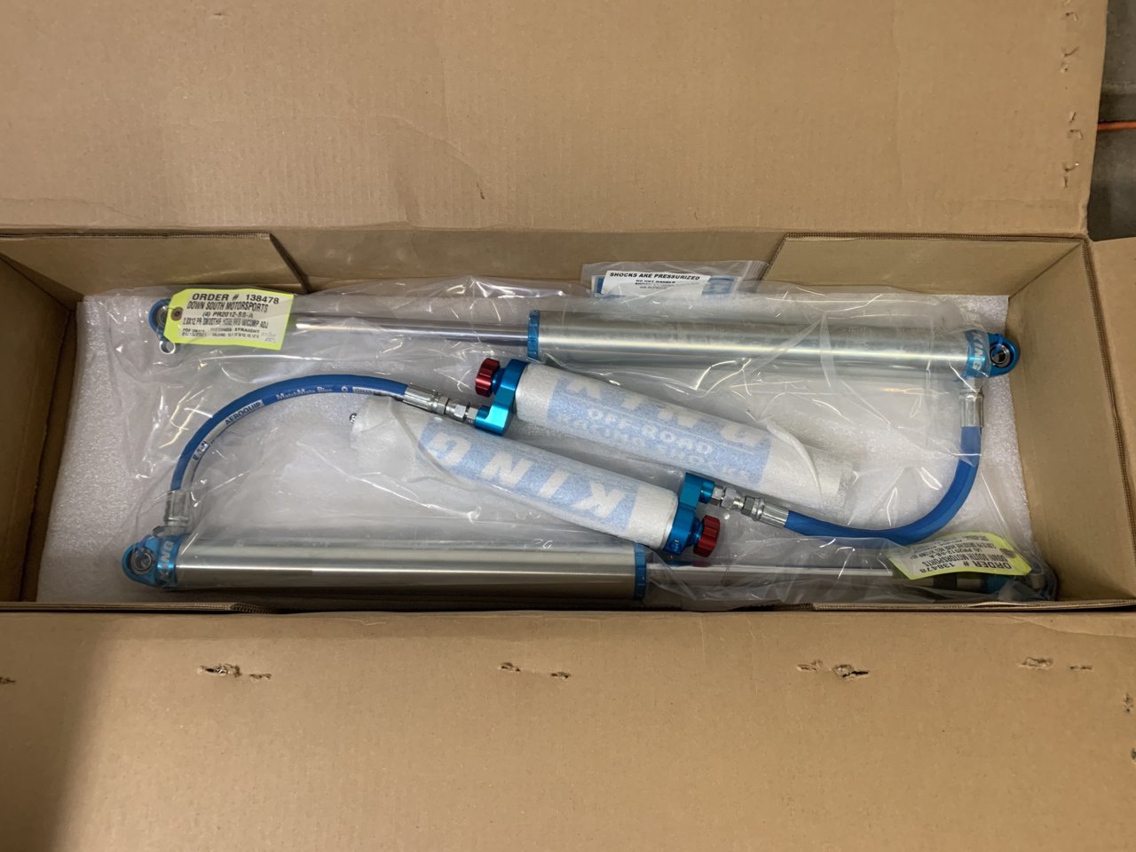

    One more piece of the puzzle showed up today. A month earlier than expected too! Just waiting to the bumper to get here and I can finally start slapping all this stuff on. Finishing up cutting my fenders this weekend.. brakes soon after.

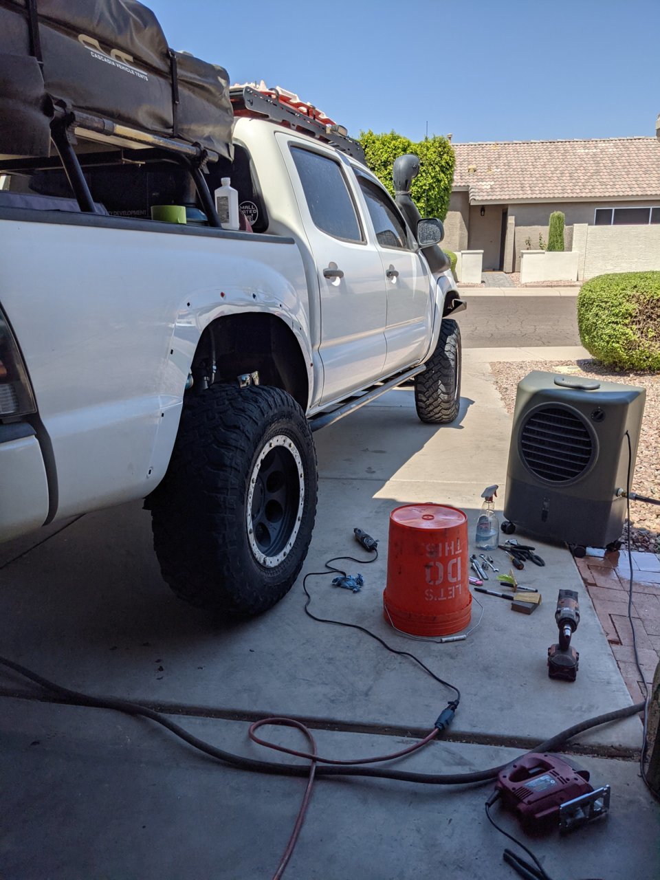

    Knocking out of alignment will mostly happen from tire impact so cam tab coverage doesn't really help that. Not to say it can't happen though.. but the real protection for cam tabs are gussets as well. That way when the tire does blow out the alignment.. it doesn't pull the cam into the tabs and bend them. Then you're forced to rebuild the front end, make shit straight, and burn in gussets after the fact. Ask me how I know.
    I was running RCI LCA skids with my Pelfreybilt skids.. and they covered the cam tabs.. so did it protect them? Idk.. sure.. but again the true protection is the gussets. I've since then swapped to the DK LCAs.. so no need for the LCA skids. My cam tabs are now "exposed".. but the Pelfreybilt skid extends out to "protect" the cam tabs some too. I don't really worry about the cam tabs anymore with the new Lowers, the gussets, and the front skid. I think it's enough. But the tire can and will still knock them out. I have a set of Bison Off-road cam tabs.. buy haven't installed them because even though they may be more solid.. I don't like how your limited with adjustment. I'd rather have a better alignment that may get knocked out vs driving with a half assed alignment. I just know it's a potential.. especially now with 35s. Pick and choose your battles. And no.. these RCI skids won't fit a 4runner. Already tried on my Uncle's 5th gen.
    Just my 2 cents. Excuse the rant.. taking a break from finishing the rear.
