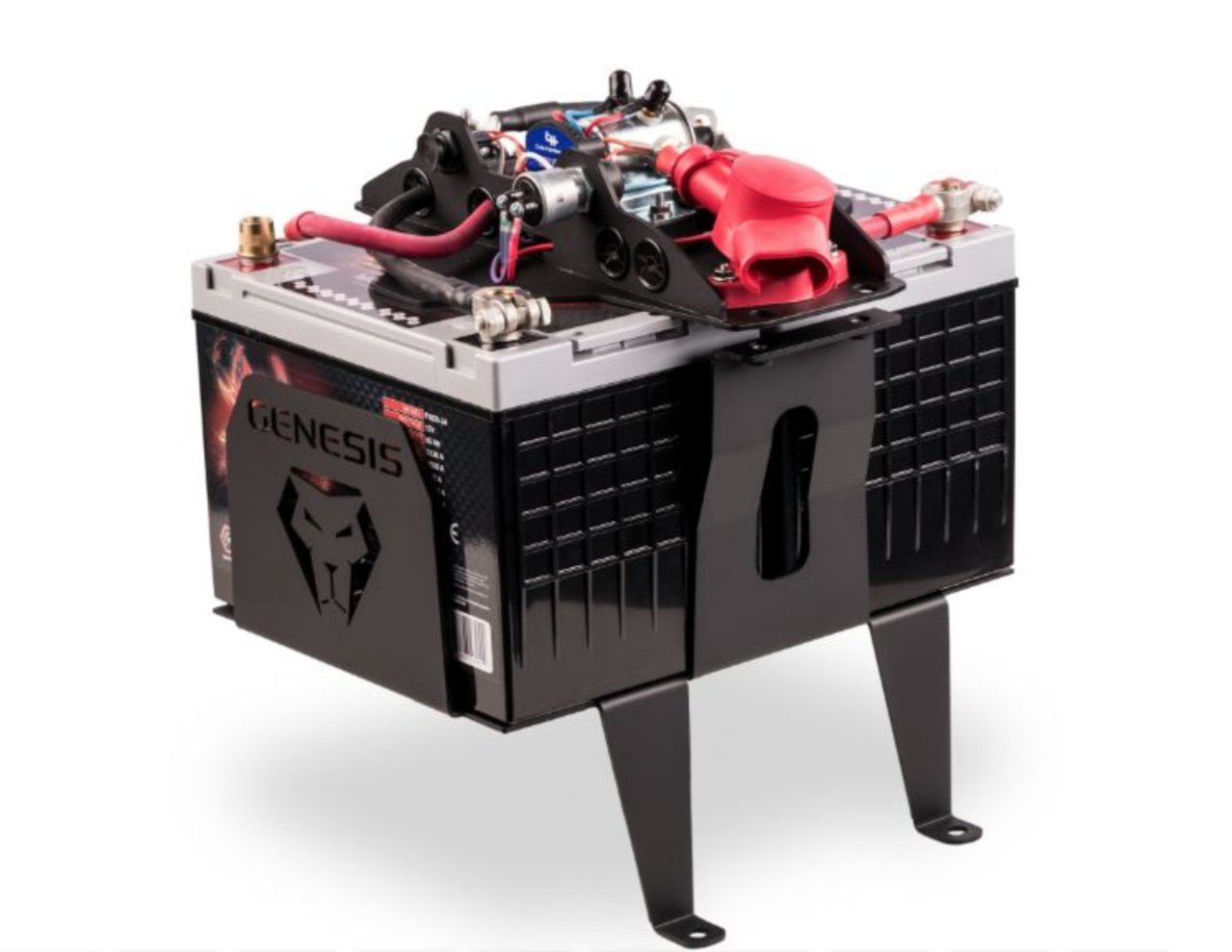

    Damn thats a serious battery.
    I assumed that since its a plug and play 2016+ specific kit with a smart isolator that it would be taken care of. Should I be concerned? It seems based on the website you can use any two batteries that are the same size so the clamp holds them in place but doesn't say they have to be "the same" battery.
    As for batteries Im planning to run two AGMs, most likely the Duracell Ultra Platinum AGMs from Batteries plus. They have a 4 year warranty, 750CCAs, 55AHs and are under $200 each after all the rebates and coupons. They weigh 42lbs each so its 84lbs for 110AHs for ~$400 which I think is a pretty good power/weight/cost ratio.
    XPOTRPR likes this.
  8. Jul 12, 2021 at 5:19 PM
    TailHook
    TailHook You just gotta keep livin' man, L-I-V-I-N
    Jun 23, 2018
    #257280
    2,908
    Alan
    Southern UT
    2018 TRDOR 4X4, 2007 Sequoia 4X4
    Unfortunately, the 3G smart alternator varies the voltage to prevent over charging the start battery, which also means it won't correctly charge AGMs with the needed voltage of >14.2V. While they'll partially charge, they'll never reach full charge/capacity. In "smart isolated" systems (like the Genesis, OGE has a similar variant), both batteries should be the same capacity/chemistry in order to charge correctly. If different, they could potentially have different charge requirements, and both may not charge correctly.
    Potential solutions include:
    1) Tune the alternator charge voltage via Techstream or KDMax (there may be others). @OmegaMan73 has a similar setup with a BlueSea isolator and the KDMax tune solved his issue.
    2) Use a DC/DC charger (like Redarc), which enables disparate size/chemistry
    (#notsponsored:rofl:)
    I went with #2, and since I added solar, the Redarc has a built-in MPPT controller. I use an upgraded wet cell for the start, and an X2 AGM for the house. Advantage/disadvantage is that the two power systems are 100% isolated, so if you need to jump the start battery, you'll need jumper cables (or a jump box).
    I've been deep down this rabbit hole...hope that helps!

    So the easiest solution (#3? ha) would be to run 2 of the same wet battery? I have a KDMax tune but it was done by that traveling guy from socal. Is there someone local that could do this for me or will the KDMax tune work correctly simply because I already have it?
    TailHook[QUOTED] likes this.
  13. Jul 12, 2021 at 5:48 PM
    TailHook
    Jun 23, 2018
    #257280
    2,908
    Alan
    Southern UT
    Potentially two wet cells would work, but you may have the tweaked voltage since you already have the tune...may want to ping who did it to see if it was baked in or if it was a "special" tweak. Think there's a local dude that can do it, too...
    ETA: Yes, local guy is @Edge48
