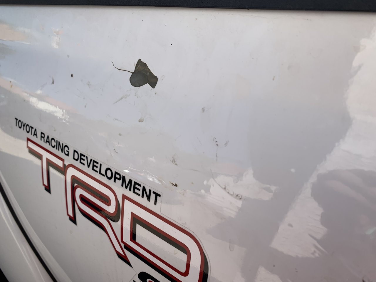

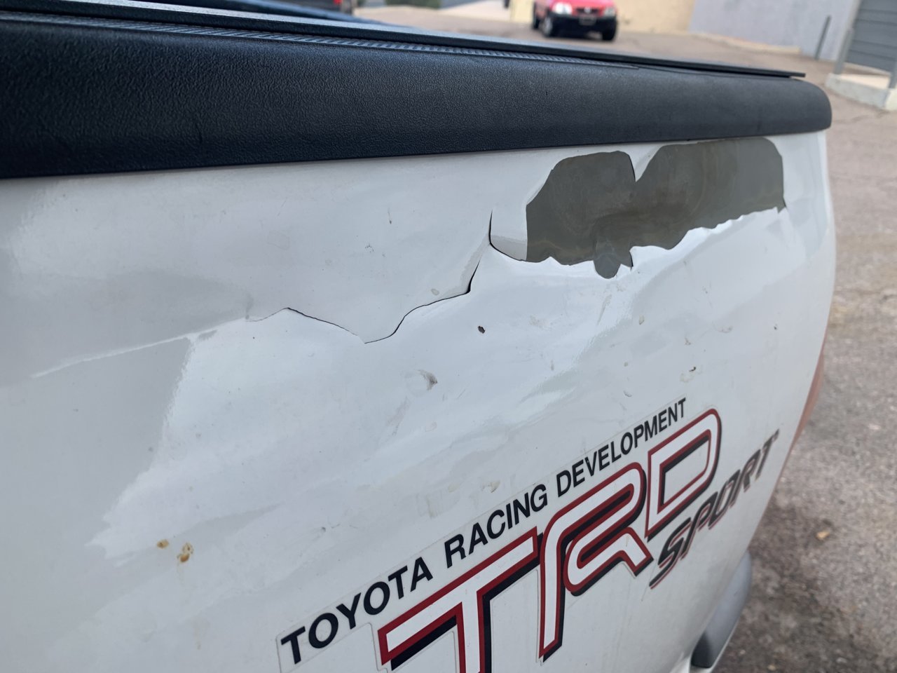

    Anyone know much about paint? I had a little bubble spot on my rear below the bed top. Had a little crack in it and when it rained I guess rain in and expanded. So now I had bigger bubble that is now peeling
    do I let it run its course or do I need to scrub off the loose bubble areas so it doesn’t peel past them?

    Damn! I thought my hood was bad. It's doing the same thing in small spots all over the front of the hood. Rock chips that have spread the same way.
    It's gonna keep going unfortunately. Maybe sand it all and have it repainted.

    Since it’s already not looking good, you could try making sure the area is dry underneath, and then do a few coats of plastidip to essentially seal the area to prevent water from creeping into it to begin with. At least with the plasti dip you can easily remove it when you fee it’s time for a new paint job or different fix.

    HAve you called and set up a claim through toyota about the super white paint yet? They are still collecting claims for the tacoma. So the more of us that do it will eventually get it bumped to get us new paint jobs.

    XPO is right. It ain't gonna be pretty but the only way to stop that is to chip all of it away, sand the edges down, prime, and get it repainted.
    I hadn't heard anything about Super White getting a settlement from Toyota, but I would say that would absolutely qualify as a defective application. That's not lack of maintenance that's a complete breakdown of adhesion to the substrate.
