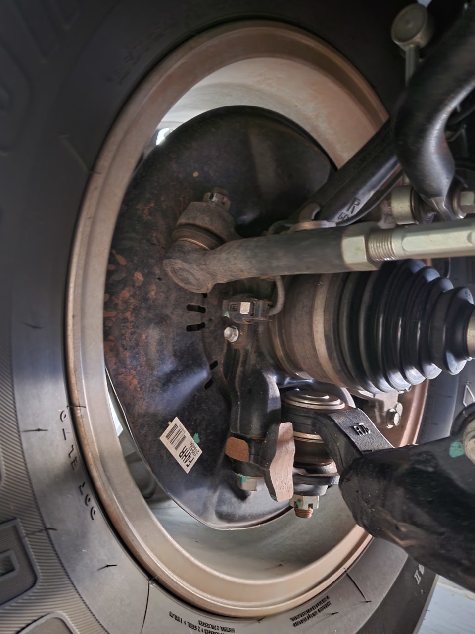

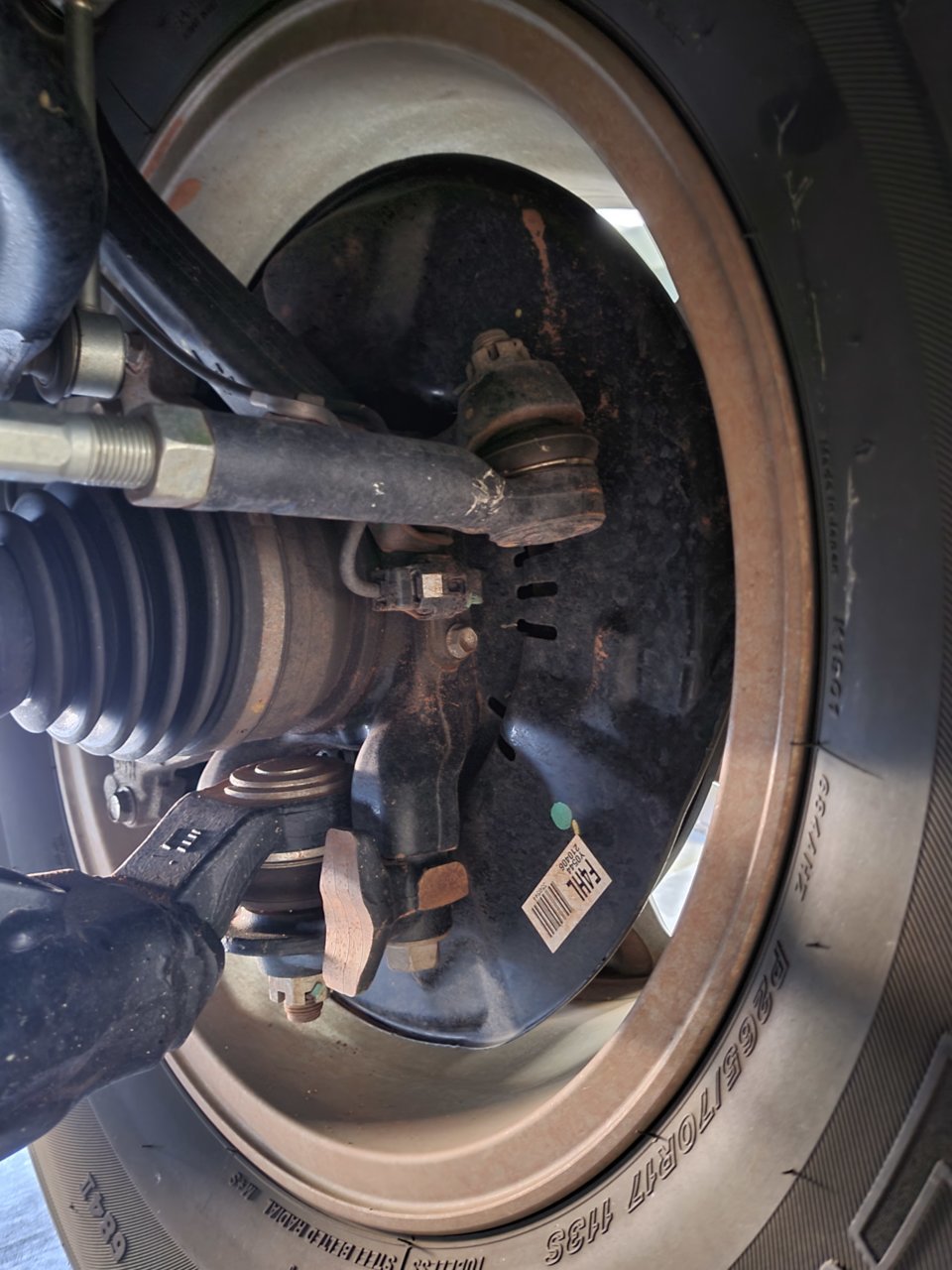

    I think my tie rod might be messed up somehow... I get a slight click when you push and pull the passenger front wheel at the 3 and 9 o clock positions, and it also looks like it's tilted compared to the drivers side.

    On second glance, could it possibly be an inner tie rod?? Would those get beat up from wheeling?
    Outer tie rod looks fine upon getting a mirror in there, doesn't move a bit when the wheel moves. However, the inner tie rod on the right seems like it has the tiniest bit of play to it. It's hard to tell because some of that is the steering wheel actually wiggling back and forth inside the cabin.
    This whole thing came about because I keep getting an odd "POP!" when I make a right turn, and only right turns. Seems like if you unload the passenger's front wheel just enough you get a single pop. Won't happen in the driveway with a jack or wiggling it by jumping up and down. CV boots look fine, ball joint boots all look fine, everything appears totally kosher in there except for that noise.:annoyed:

    Yeah that's probably what I will do. Just hit all the UCA/LCA/Strut bolts to their recommended torque, scrubbed any clods of dirt outta there, and put the wheel back on. Nothing seemed out of place.
    Now that I'm sitting here after getting ready for a Halloween party with my coworkers I realize I didn't take a look at the endlink bolts. :notsure: But that would clunk in either direction because it ties the wheels together, in essence.

    Well that's fascinating... driving off with the gunk still "moist" from being scrubbed = no noise whatsoever, on the way back home from the party after it had plenty of time to dry out, it's back but more creaky than a pop.
    So it's just bullshit crud stuck somewhere in there, I think. I'll have to hose it all down when I do an oil change next weekend.
