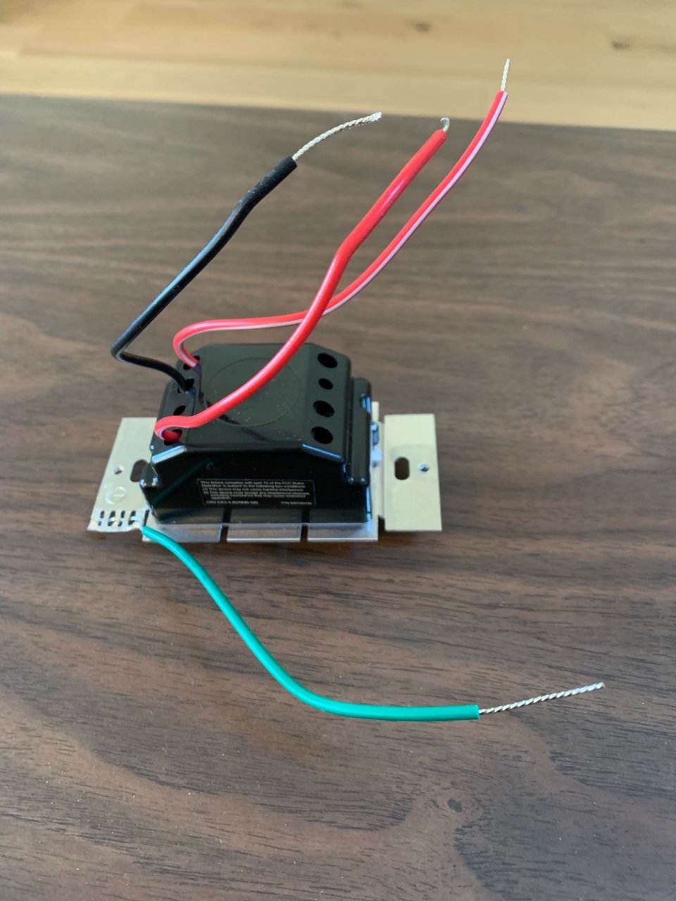

    I need some electrical help. Installed a new light fixture in the kitchen, flipped the switch and it blew the switch. Figured its an old switch that cant handle dimming so I pull it out but it is 4 wire ground/hot/neutral/control. So I buy a new switch, wire it in, flip the switch and POP, blow the new switch. What am I doing incorrectly? Its just 4 wires and I simply matched the colors. Could I have wired the fixture incorrectly?
    The new switch has green/black/red/red+white stripe. I assumed red+white stripe was neutral but maybe thats wrong.

    Switch on a 3-way (i.e. are there two switches that can turn on and off the same light)?
    If not (i.e. just a single switch for the light, as is most common), cap off red/white wire, you do not use that.
    You need to know what wire from the wall is the hot side. That wire goes to the black wire on the switch.
    The black wire in the wall that goes to feed the light attaches to the red wire on the switch.
    The green wire is ground.
    At no point does a white wire attach to this switch.

    That is correct, only this single switch for the light. The old fixture had all 4 wires connected though.

    That's fine that the old fixture had two power wires connected. Someone either didn't know what they were doing, or they didn't take the time to determine which hot wire actually powers the light, so they just connected both. All it means is that that extra wire is hot when the light is turned on, but your house isn't burning down, so it's been capped off appropriately somewhere in your house.
    It being a single switch, do what I typed up and you'll be golden.
