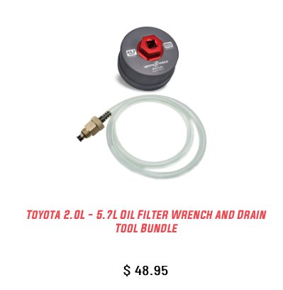

    Fumoto goes on the pan drain...flip it open and do the filter while it drains. MotivX tools for the filter housing drain and element R/R.

    This is what I have, but the older black [cheaper] housing tool...

    Cool, I ordered that wrench and a Fumoto 133.

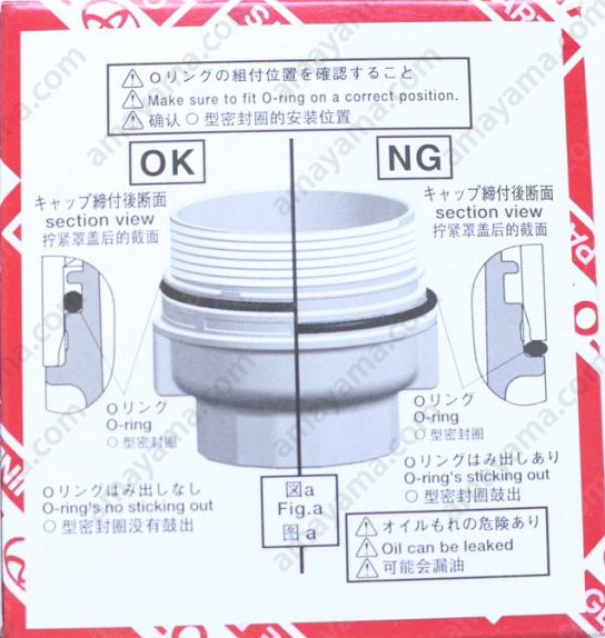

    Another tip...make sure the housing o-ring is in the correct groove when replacing, or you're gonna have a bad time!
