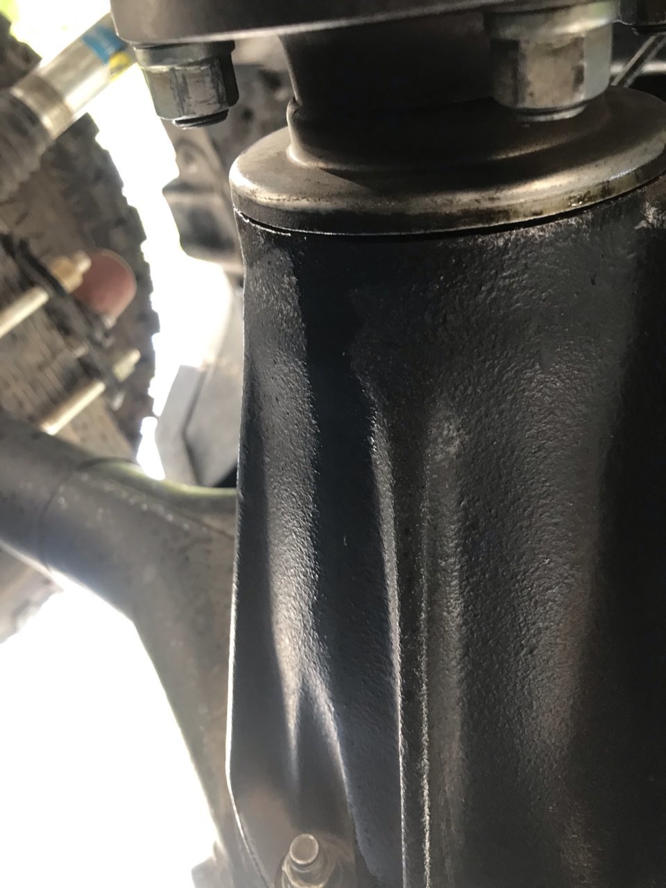

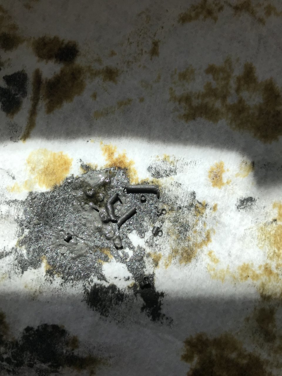

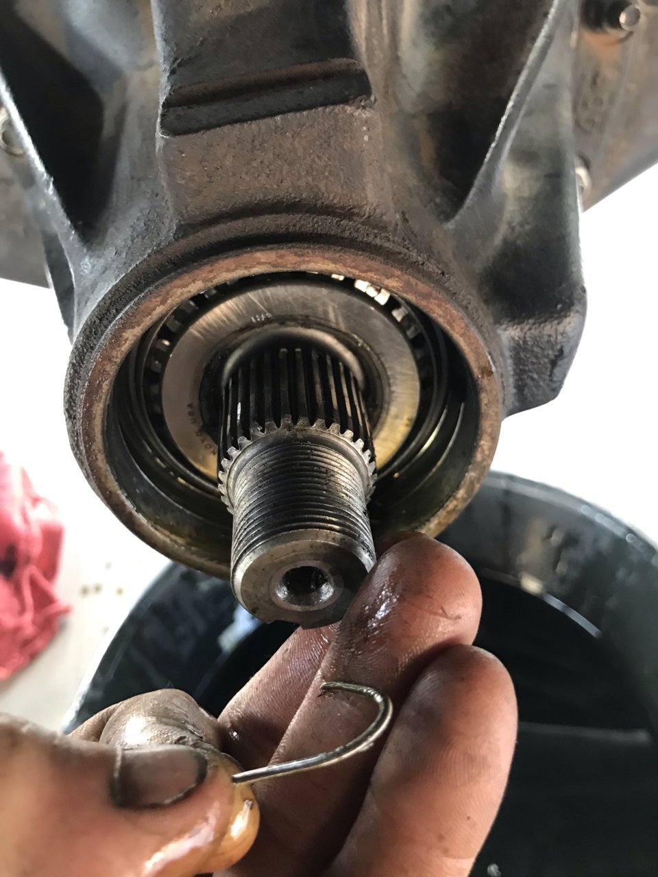

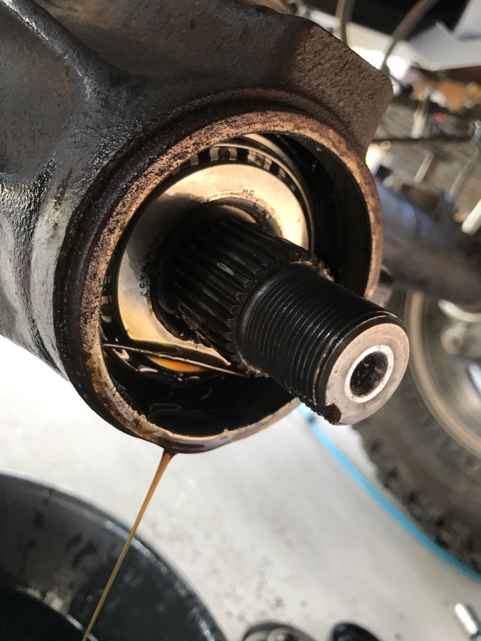

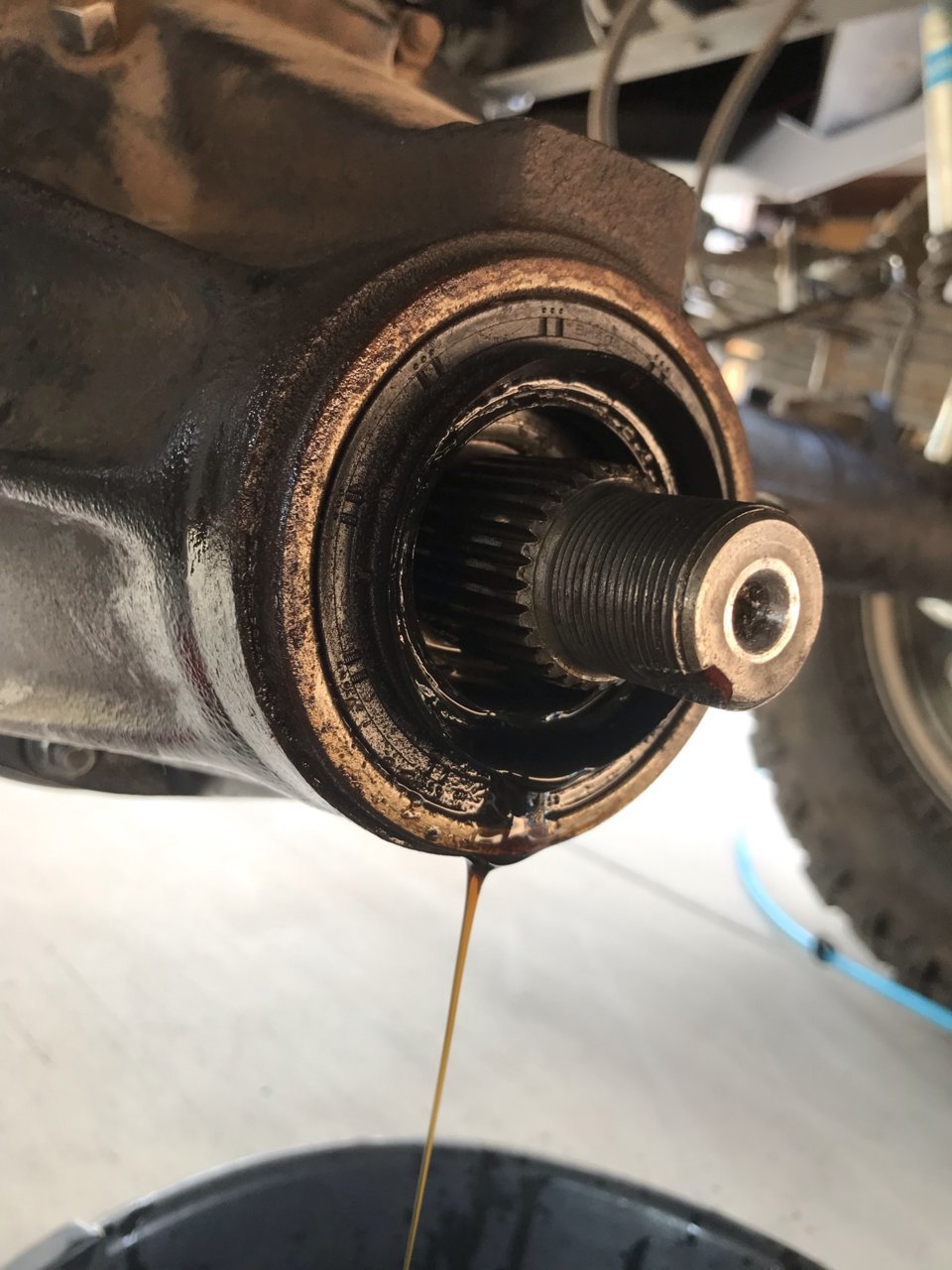

    Findings worth sharing.
    Posted a few days ago about some spring bits attached to my rear diff magnet. I pulled it all apart and called ECGS, they couldn't tell me what they were from only that they were definingly NOT from the ARB locker. Scratched my head and asked around and thought "maybe from the axle seal". They both checked out and I didn't find anymore bits in the tubes or case. I decided to put it back together after a solid flush and cleaning Had a few days passed and I found a new leak on the diff. behind the pinion flange. Ordered the pinion oil seal and pulled it out to replace. To my surprise I found the rest of the missing spring. Never would have thought it would have made it through the bearing. Should be an interesting conversation with Paul at ECGS about the next step.
