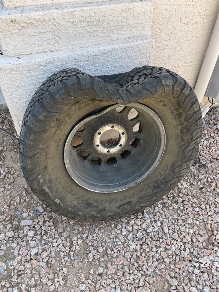

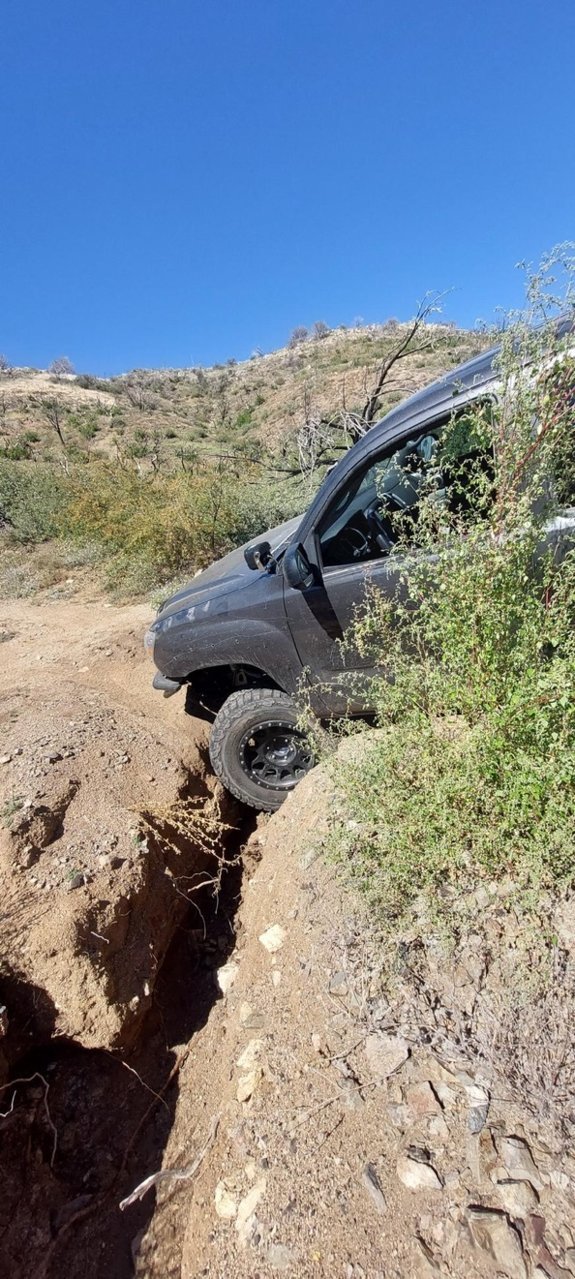

    This is what ate me. The stupid part is I actually drove over it in the other direction earlier in the day and it was totally fine, but I ended up encountering an even gnarlier one further down the trail and turned around. I was rolling up to it fairly gently (I thought), but the ledge kinda gave way and dumped me right into it. Hit a rock or some hard pack hard enough to bend the rim and blow the bead since it was aired down. Limped it out to the road and had it towed home.

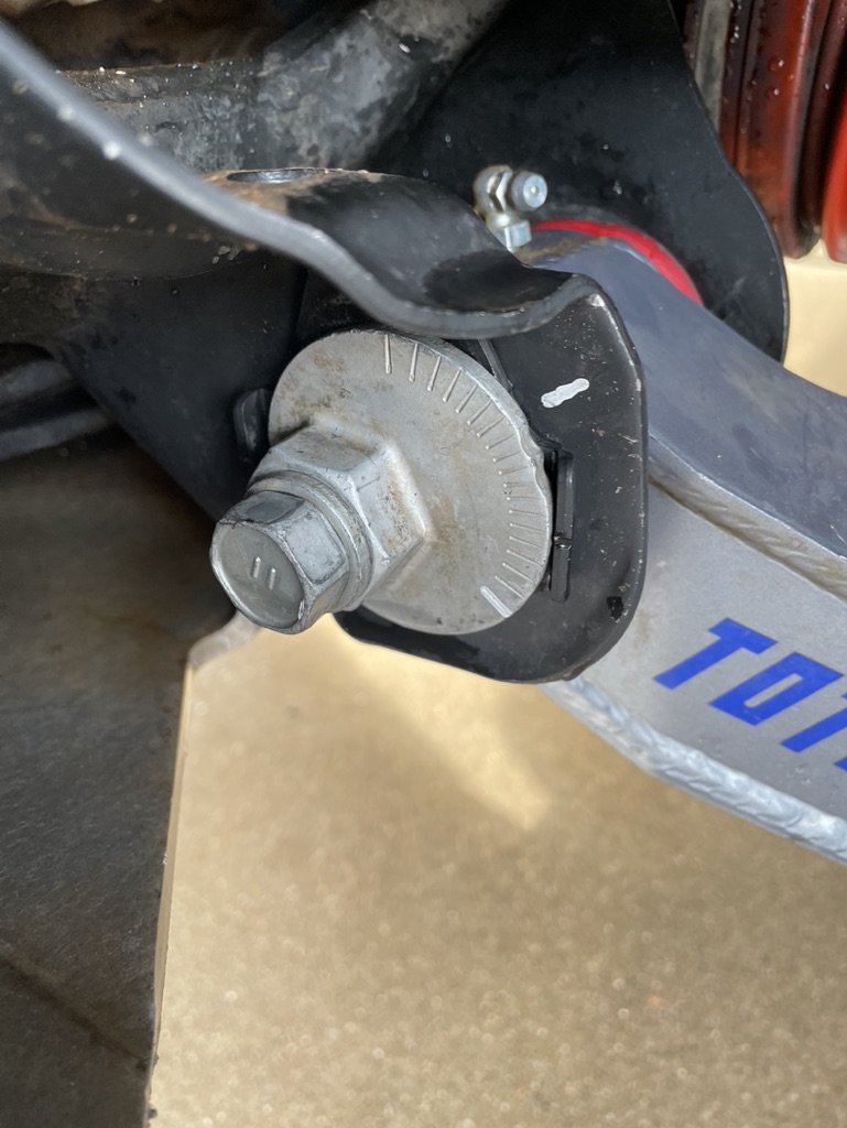

    Tabs on the front mount are pretty bent (ignore the paint pen, that alignment was pre-LCA install)

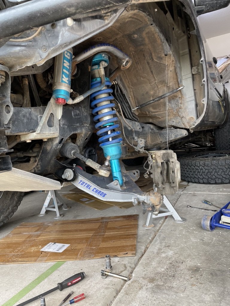

    Got mad at it this morning and just yanked the entire thing apart with the axle still on there, gonna drench it in PB or something and see if gravity will help me out. The last battle (I hope) is going to be the lower shock bolt, I think it's a little tweaked too. Since I just did a bearing on the passenger side last week I'm guessing this one is close to being shot too, so I might just buy a hub assembly and bolt it up to a new spindle, but I still need to get my axle freed up.

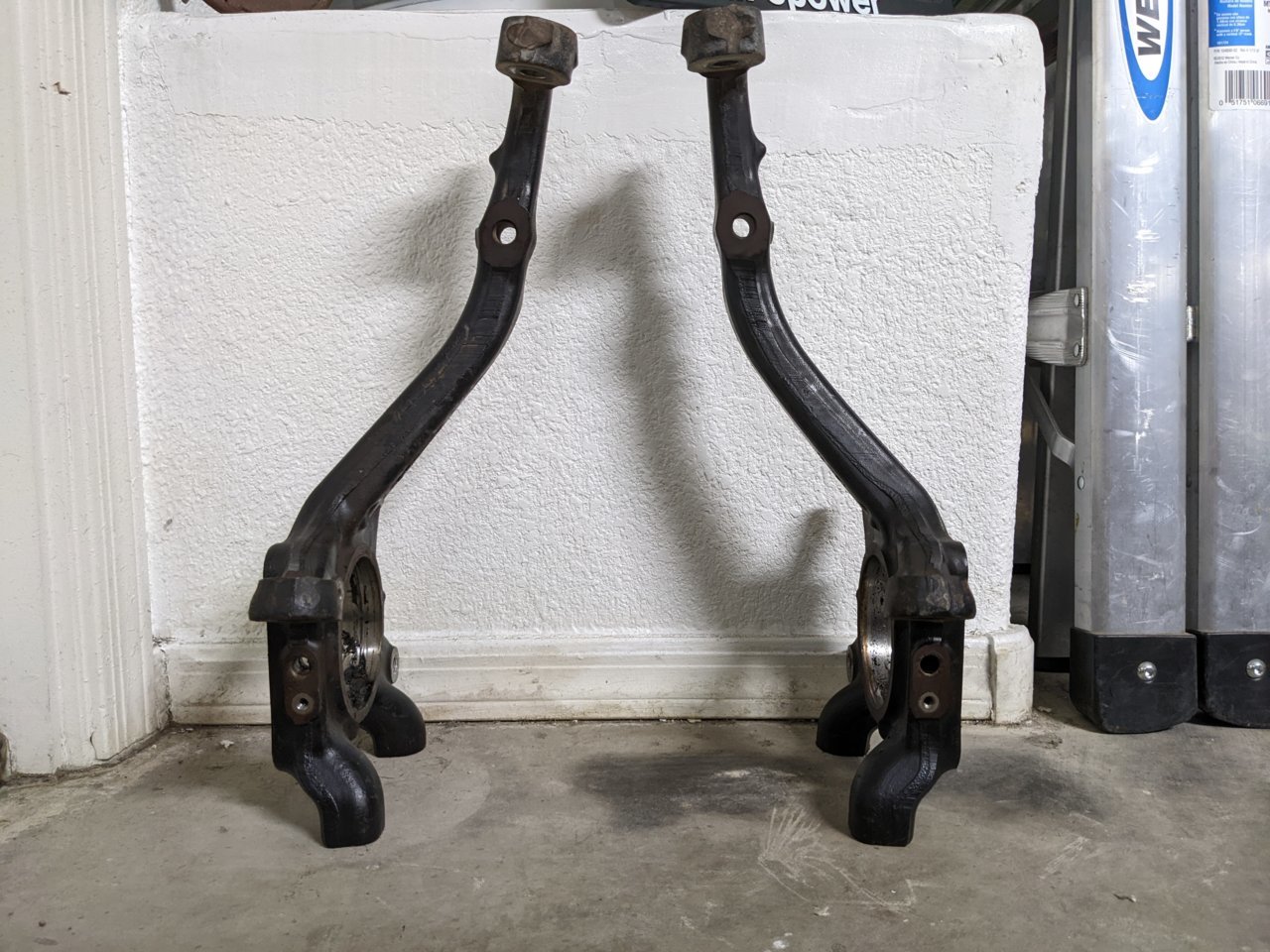

    oof.. Been there unfortunately. That's what made me gusset everything originally. Same thing happened to my Cam Tabs when I blew out the front end the first time. I replaced everything and had gussets added to the Cam Tabs (actually replacement tabs), the coil buckets and spindles. Since then I've been in a couple front end impacts over the years so I've replaced the entire front end, again, twice over (because I like to replace everything/both sides together at the same time when this happens so its all new together) with other/new gusseted spindles and new hubs, etc. I should have a few left over parts, including the spindle(s) from the last few rebuilds.. so I'll see what all I have and put together a list. See what you need/want. I can go through it all tonight and then bring it all by and lend a hand tomorrow after work? I definitely recommend just getting and replacing both hubs with new, assembled hubs. I also have some Bison Cam Tabs you can have if you want. I went with the Poly Taco tabs instead and they have been awesome.

    @azchris Well, I should have marked them originally, but I'll compare them to mine and see which is which.

    Tie rod is on the front side of the spindle
    driver side seems to be the “good” one

    That's why I took the photo in that orientation. I'm pretty sure these are from the very first incident, which was blowing out the passenger side.
