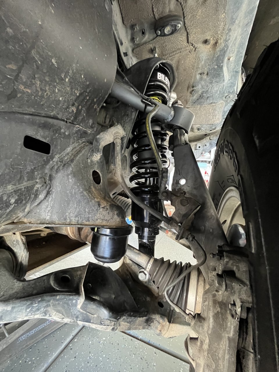

    Just found a snippet from tyler. Is this what you guys are talking about?

    This is the only one I can find now but it has no reference to HD. I'm assuming its the updated part since the PN is the same minus the first letter

    Holy giant bump stops Batman

    They are standard wheelers superbumps with a fisheye lense setting on my camera

    'Accidentally' jumped my Tacoma this past weekend.
    I was very happy that I had my Superbumps. The landing was intense but soft in a way. The only damage was torn/bent cam tab edges thankfully
