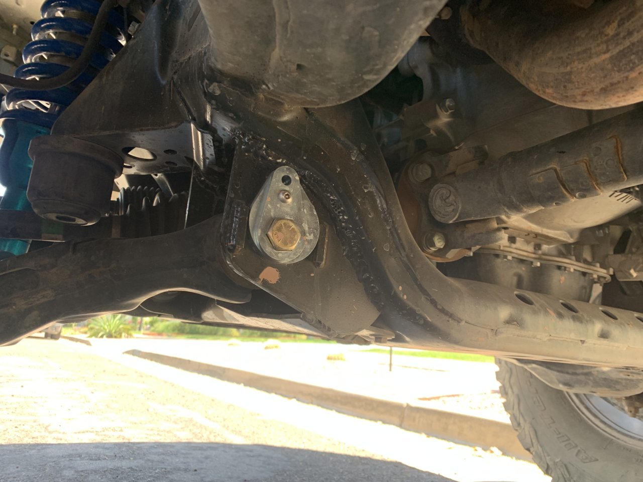

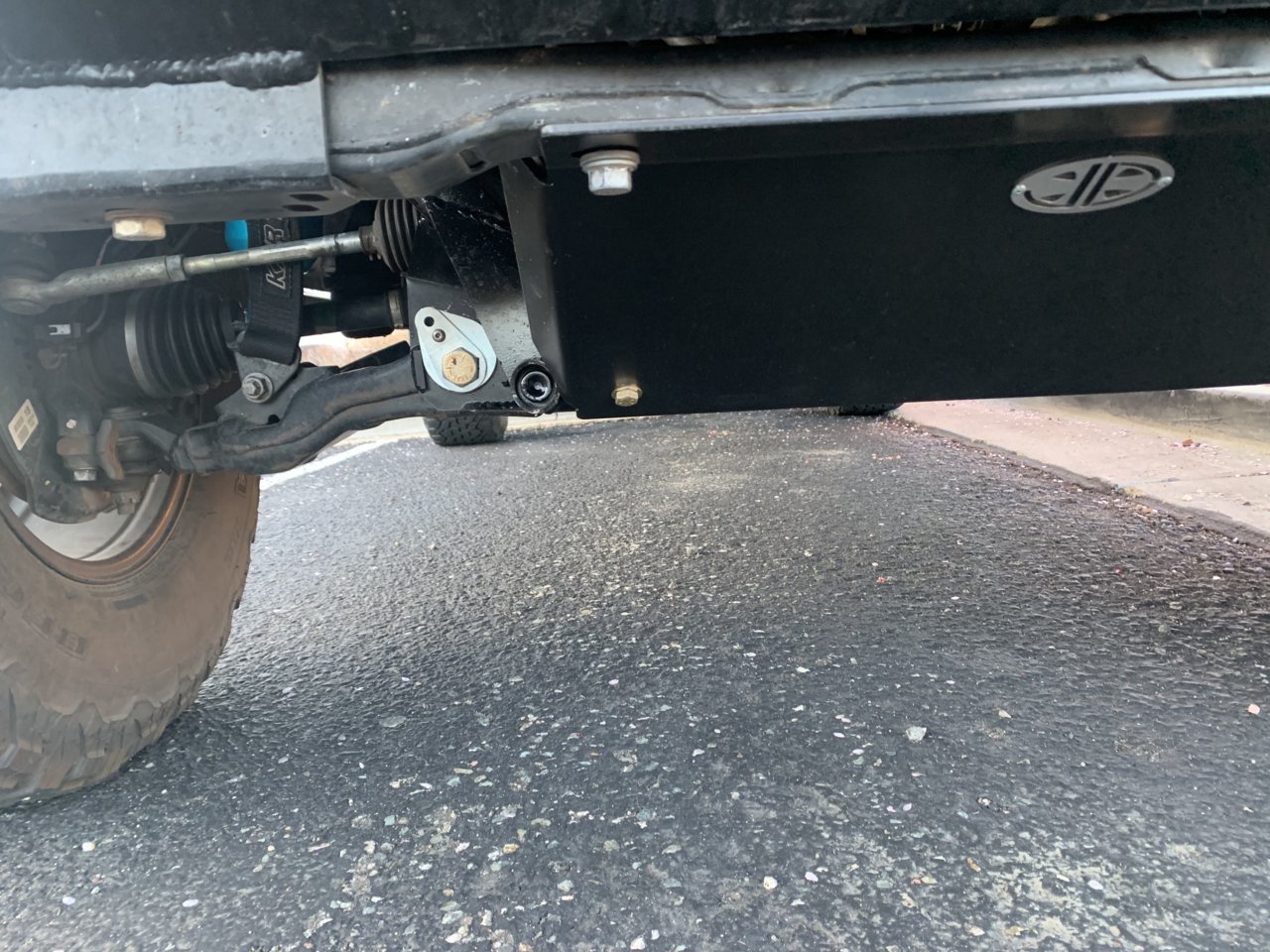

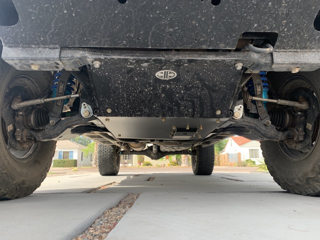

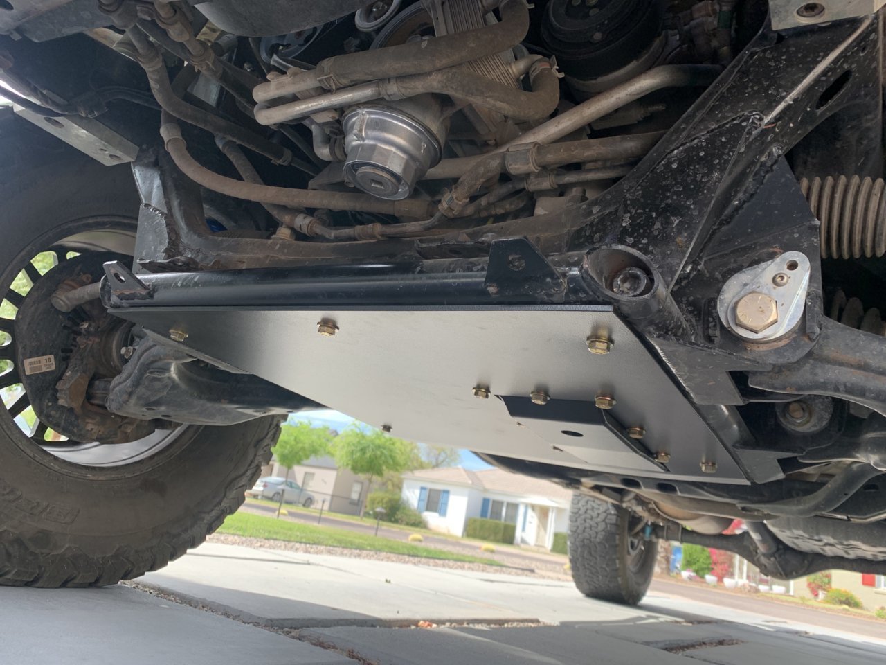

    You cant run taco tabs on this subframe. This unit requires completely cutting off your stock lower control arm mounts. There is nowhere for taco tabs to go and you wouldnt want them anyway. This system is WAY beefier than the stock subframe with taco tabs. You can actually bolt your cams in place with this setup. It uses all new hardware as well, including the cams, nothing stock is retained.

    yea, the only thing left is the cross members. everything else cut off

    I understand the stock mounts get completely removed therefore the new Kit has the new thicker locations. I wouldn't be reusing the TC gusset kit but wouldn't the actual squared off tab be beneficial vs a cam bolt??
    I don't know any different so I only ask the simple questions as I learn. These tabs have been so effing nice retaining my alignment when I beat it up a bit on the trail.
    These are just the questions to be covered, as dive into a new upgrade. I appreciate the info and your knowledge of this.

    There are a number of substantial differences that render taco tabs useless with the JDFab subframe. This explanation will make more sense once you see it in person but Ill try anyway. First, the material of the subframe where the cams go through is twice the thickness of the stock subframe+taco tabs and additionally the "stops" for the cams are like 3/8" thick. Second, the cams can be bolted into place through the subframe. You will rip an entire wheel+brake assembly+spindle completely off of your truck before the cam spins inside its slot in the JDFab subframe.
    Here are some pics to whet your whistle slightly

    To add to @Atl-atl pictures. Those blank holes you see on his tear drop tabs. You drill out and put in 3/8's bolts to keep them in place. Once your for sure, for sure your alignment is done. Then like he said. Your breaking or bending stuff bad to get it outta whack
