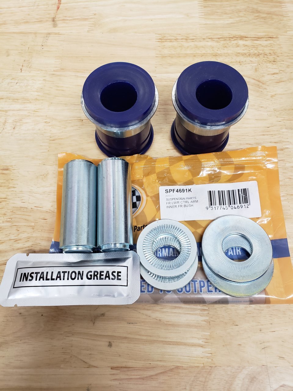

    I was very tempted to buy Solo or BTF fabricated stock length arms to get the lower ball joint pushed forward for better clearance behind the tire. Being a cheapskate, I figured I would try the budget option first. I rebuilt the OEM arms with offset poly bushings and good quality ball joints. I ended up with 5/8" additional clearance at the firewall for about $280.00. They definitely don't have the same appeal as the fabricated arms but have worked well for me so far.

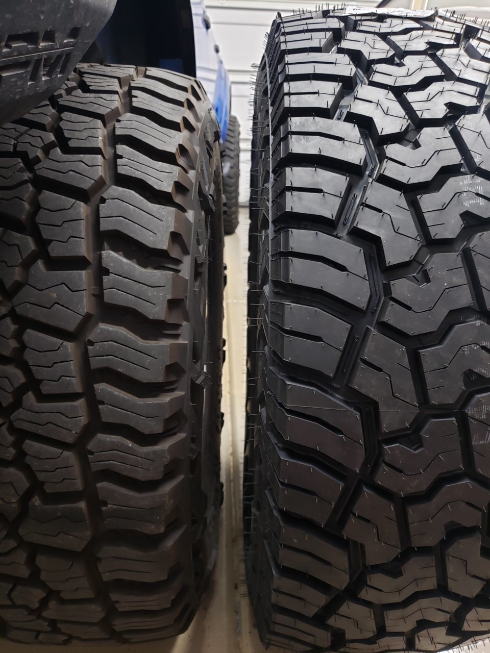

    Lol, I might be needing the extra clearance from the Solo LCAs. These things definitely are true to advertised size unlike some other brands... looking at you BFG :rolleyes:

    @WrecklessAbandon Not really, it is the same process as rebuilding the arms with any other bushing but substituting the offset bushings instead. SuperPro sells offset bushings for the front & rear of the LCAs so you don't have to use the offset ones in both positions if you don't want too. The only trick is making sure that you place the offset in the correct location before you press them in. For max clearance, you want to have the rear bushing offset hole towards the inside and on the front the offset bushing hole would be towards the outside of the truck. This pushes the LBJ forward 5/8" over stock bushings. I also have my LCA cams maxed out and then SPC adjustable arms take care of the alignment. Without the adjustable UCAs I'm not sure that you could have the LCA cams maxed and offset bushings together and still get it in alignment. Wish I would have taken pictures when I rebuilt the LCAs.
    The bushing part numbers are: SPF4347K & SPF4691K. SuperPro also sells complete lower control arms with the bushings already installed as part TRC482. In the picture below it looks like the front bushing needs to be rotated 180 degrees to give max clearance behind the wheel. [​IMG]
