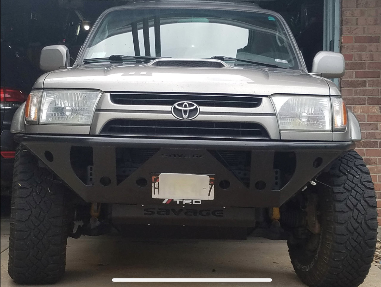

    Looking for some guidance if anyone is familiar. I just bought a Savage Off-Road bumper that came off a 3rd gen 4Runner, like in the picture below. I am reading that the T4R and Taco have differences in the frame rails (and even year vs year in the taco). Does anyone know exactly what I’d need to do to fit this to my 2000 Tacoma? I am reasonably handy (don’t weld though) and not opposed to just tearing it apart to see, but if anyone has experience with this, I’d love to talk through it to create a plan. Thank you!

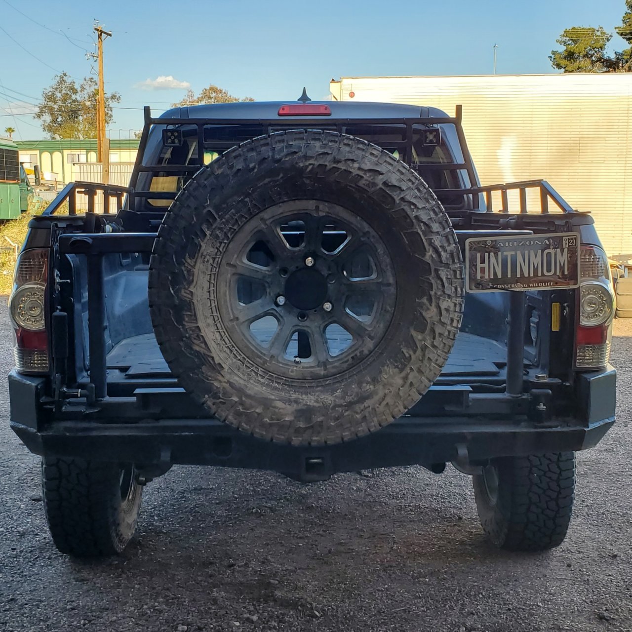

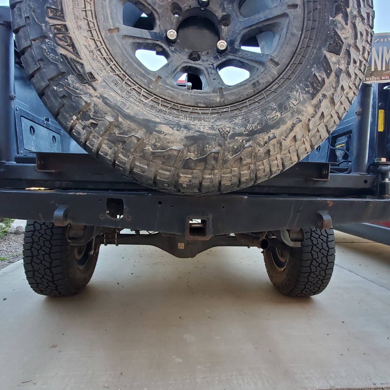

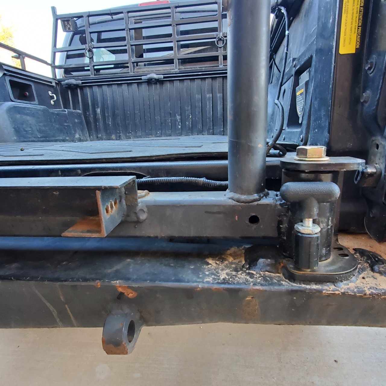

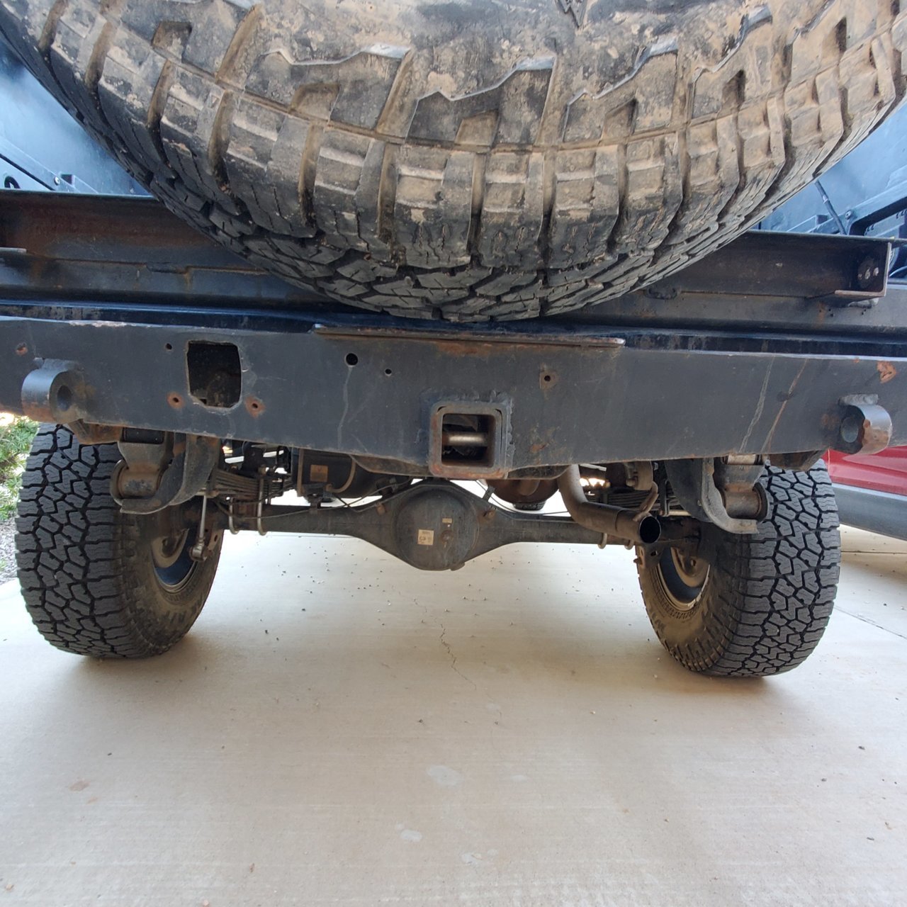

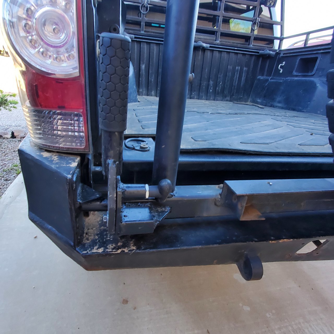

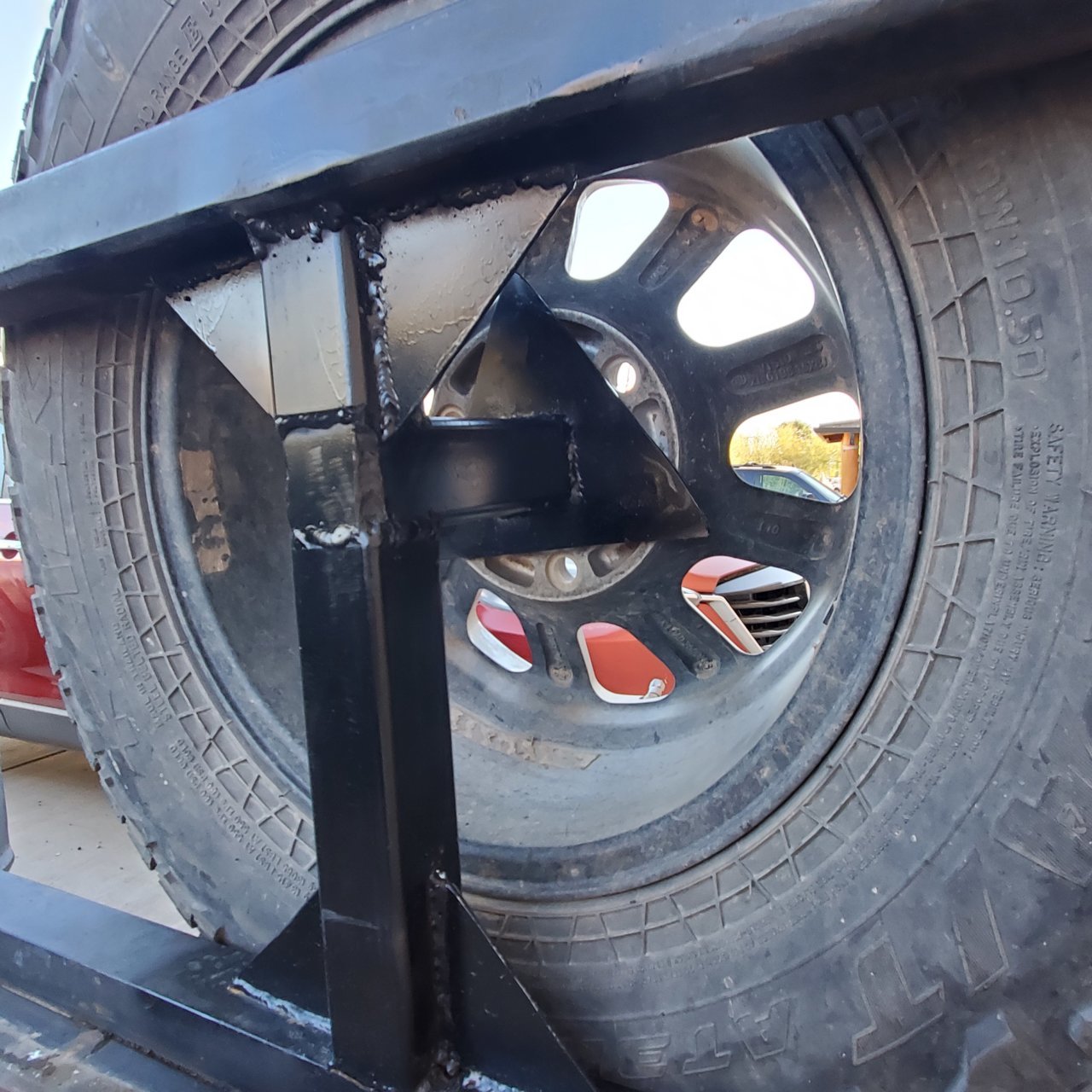

    I've been refurbing a second hand high clearance, swing out drop down rear bumper with friends/welding instructor when I can (rarely) get access to manpower and equipment. Not much room for do-overs. It ain't pretty, but I'm learning as I develop my first build and am thankful for help.
    We've replaced the swing out hinge and latch assemblies with 4x Innovation parts, fabbed a rear tire carrier in the center of the swing out. I'm redesigning the drop down table, looking forward to having the bed closed again so I can put some shit back there. Before I do though-
    1) Cannibalized the OEM rear camera from the OEM tailgate. I'll be welding a bracket to bolt the replacement metal bracket to- OEM plastic shattered. What do I need to know before choosing a location for it, as far as OEM camera function? No love for the blue screen in the rear view mirror. Vertical midline best?
    2) Looking for a way to mount my Amazon track boards to my drop down table, so they ride inside the tailgate during the season, are easily accessible when TG is open, and drop down with the tray. Take off U bolts don't seem to work, not sure I love permanently attached safety hazards, nor randomly drilled holes. Anyway do, or see this before?
    TL;DR Need a grown up to show/tell me where to relocate OEM camera, and seasonal/accessible mount ideas for track boards.
    TIA!

    Get an oem roof rack and some ubolts, I just did that with mine! I can show you sometime, I'm not gonna keep them mounted up there all the time though.

    1. I think location of the camera depends on the video quality. They might make or diy a bracket to mount it center of your new spare location I have a camera above my license plate on the PS. As long as I can see the cars behind me, I'm good.
    2. Good spot to tuck them boards. Again diy and start with mounting the boards together a light frame then weld the frame to the inside square of the TG. I recall the swing out and I'm happy you got the shop time to fix it up!
    Sounds like your in the right direction, hope you took some pics to share:thumbsup:

    @PilotBoy352 The ubolts don't fit the boards, I did play with your idea. I could plasma cut 'em though.
    @Yacob_D I have the bracket we cut off, and a spendy new one I fixed up to actually fit. I might catch up with you to look at yours. I'm concerned about ripping off parts when gravity helps the spare down. It's the back-up camera- don't want to squish a kid.
    I'm going to weld up a new drop down tray out of heavy 1in square tube.

    I know that one of these companies has a camera replacement for exactly this application. I just don’t remember who it was. The traction boards could be mounted vertically behind the tire if that’s an option for you, or you can weld in a hitch receiver type add on to fit inside the hub of the spare wheel, and fab up a simple frame that plugs in and the boards mount to that. Completely modular and easy to remove/install on the fly…
    Edit: I have scrap receiver tubing if you need some and can send you a rough sketch on my idea of that helps clarify it lol

    If you’re still thinking inside you could space the table out away from the tailgate just enough to mount the boards horizontally behind the spare, kind of sandwiched between the spare tire support and the drop down table.
