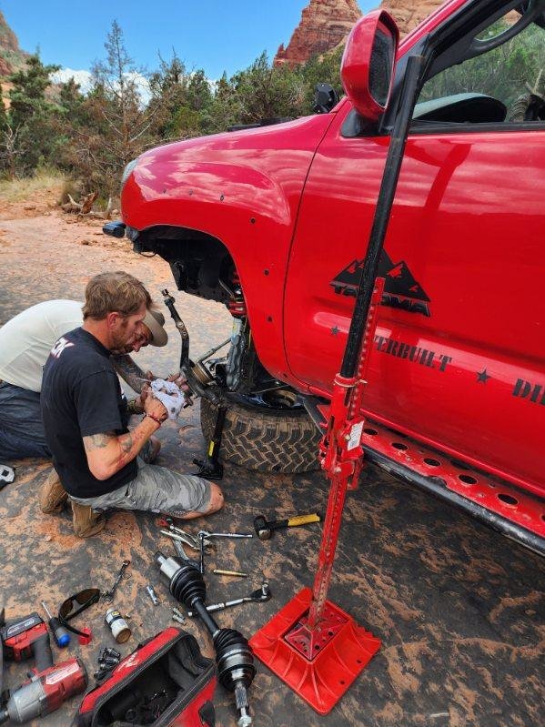

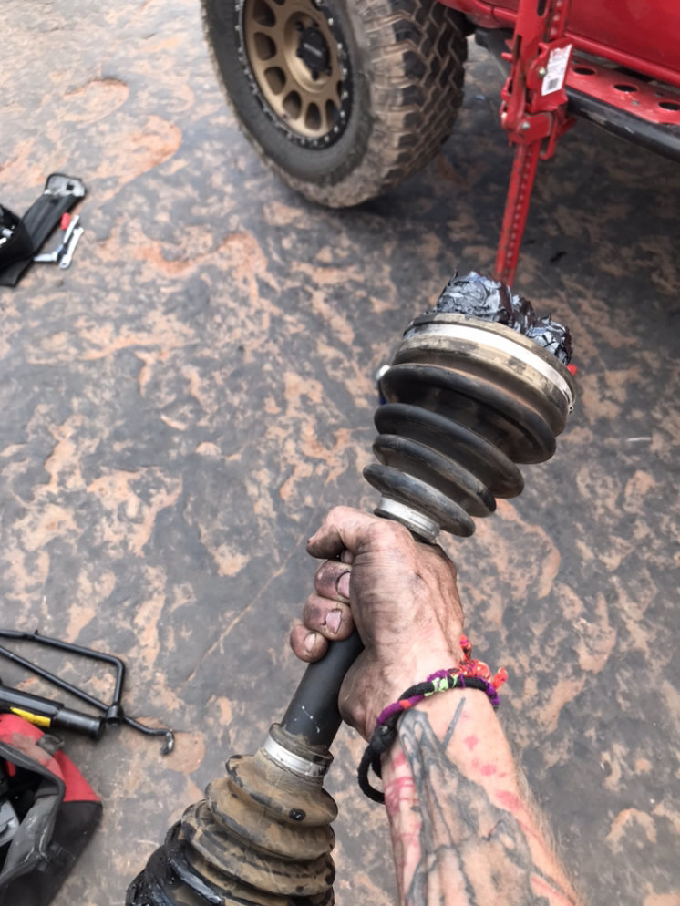

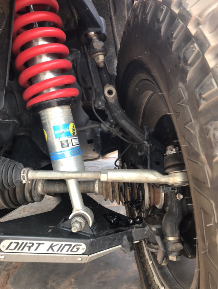

    Weekend in Sedona was fun! Rented a place in Chapel, got a few miles on the mountain bikes around Broken Arrow trail. Didn't take many photos but learned a new lesson in wheelin as a new driver:censored:. After a great start on Broken Arrow trail and creeping up to Submarine rock for some views, we then made our way to Mushroom rock and driving up the next obstacle. 4lw with too much grippy and no slippy with get you every time. I should have known better but I'll play the rookie mistake card and just leave this as a reminder! CV is a weak link, wasn't even doing cool shit when it snapped. Tight turn going slow in 4lw on red rock..:facepalm:

    Great spot to get to do a trail repair tho.

    Absolutely! Weather, location, and company was pretty much the best. Helped calm the panic so I could focus on the solution.

    Was the solution to simply remove the axle?
    EDIT: just looked at the photos closer, did you have a spare axle?

    If you destroy a CV then yes, you want to remove the busted one and then put a new one in there. You do not want to drive without one, as the CV is one of the things that keeps the oil in your front diff.
    As mentioned below, if you don't have a spare you need to butcher the busted CV and leave the one end of the CV in the front diff. The downside of this is that you disable 4wd in your truck.

    Yep! I had a spare on hand if needed 4x to get home. This round I left both end in the diff and hub and drove out.
    Edit for info
    You need the shaft on the hub end to keep it all together and attached to the spindle. I left the diff shaft in to keep from loosing oil. Diff side has a retaining clip on the shaft. As a PITA itself it stayed.
