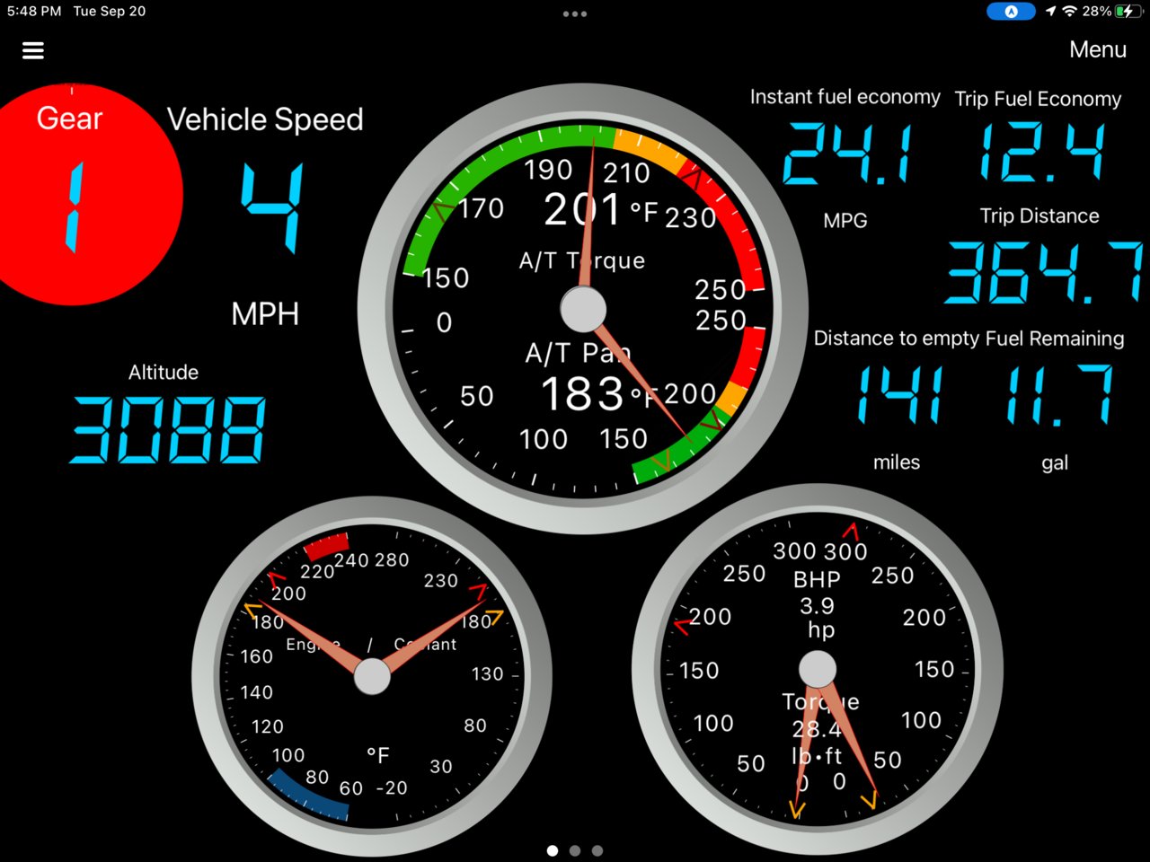

    Here’s my usual towing dashboard. The red circle top left behind the current gear turns green when the TC is locked.

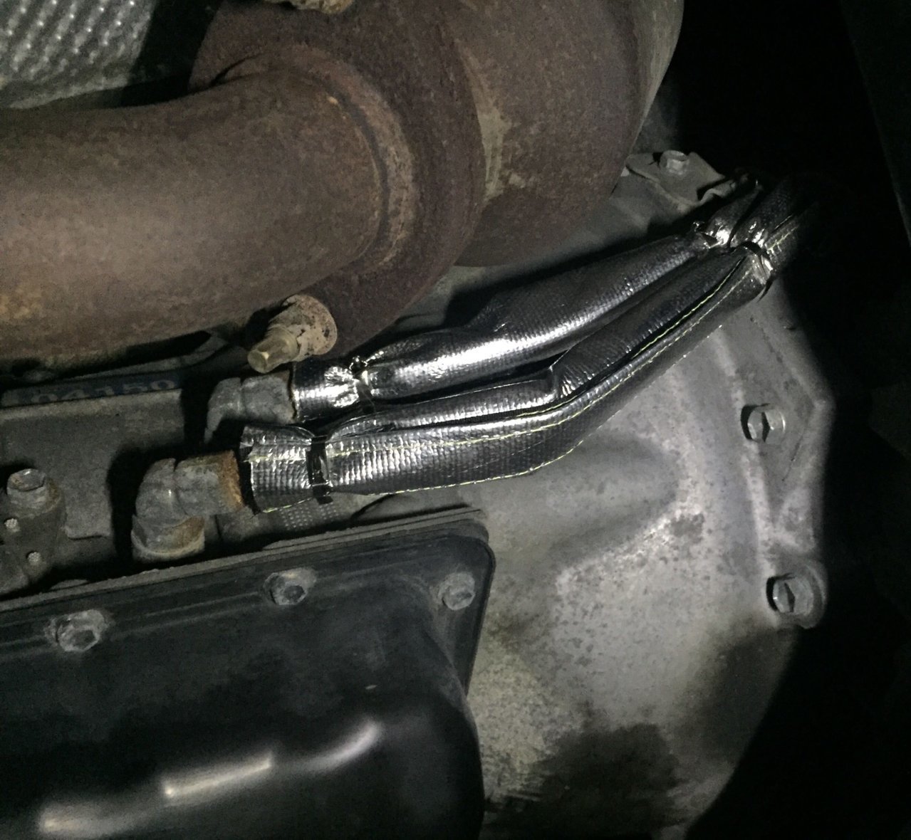

    I can’t find the thread, but there are two hard lines coming off of the trans that route up to the cooler. They run right next to the cat, and cats run hot as fuck. Wrap the hard lines in some appropriate heat insulation and it will drop your trans temps.
    If I can find the thread with actual testing and numbers I’ll post it here.

    2017 4Runner

    I had thought about making a shroud for my 2020 a/t radiator but I ended up raising it 1.5” from its oem position so it gets better air flow.
    I’ll look at possibly insulation the lines near the exhaust if it’s relevant for the 3rd gen. But tbh I find the trans temps are pretty well kept in check as is, even when towing a 5klb brick up mountains.

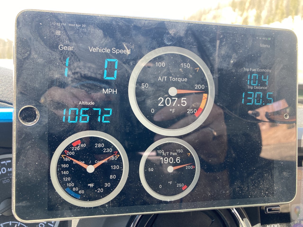

    I had the opposite when pulling a 5klb TT over Wolf Creek Pass (10,800ft elev). My transmission pan temps were steadily climbing when I was in 3rd at 50mph, got to 199 and tc temp to 210’, I dropped to 2nd gear and 45 mph and pan temps dropped to 195’ and tc stayed steady at 207’ for the last mile or so and pan temp got to 190’ at the top. I contributed that to having more fluid running through the radiator extracting more heat.
    My rule of thumb is if things are heating up get the fluid moving quicker and keep air flow happening. Pulling over and stopping is potentially the worst thing you can do.

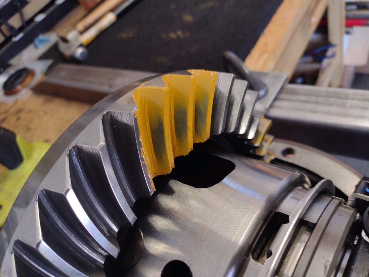

    Zuk provides play by play via text. Rear is done.

    Strawberry Az
    yes he does, aint it cool? looks like you popped extra for REM,,, nice, seems like it makes a difference.

    REM and Cryo. Only thing I couldn’t afford was going with a front E-Locker…for now.
    MR E30 and llibrm like this.
