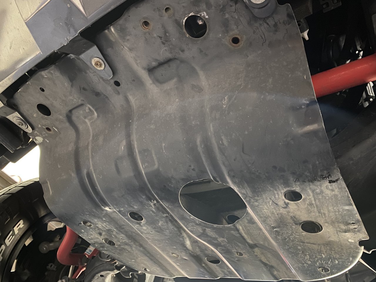

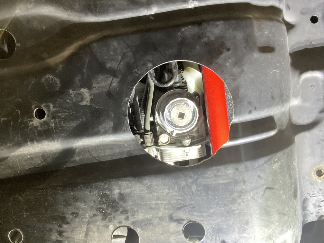

    These two things, a fumoto, the Toyota aluminum oil filter housing, and cutting a hole in your skid plate for filter access helps a lot too. Certainly not mess free but pretty close.
    https://www.amazon.com/dp/B08YDBV844
    https://www.amazon.com/dp/B088LX23ZC
