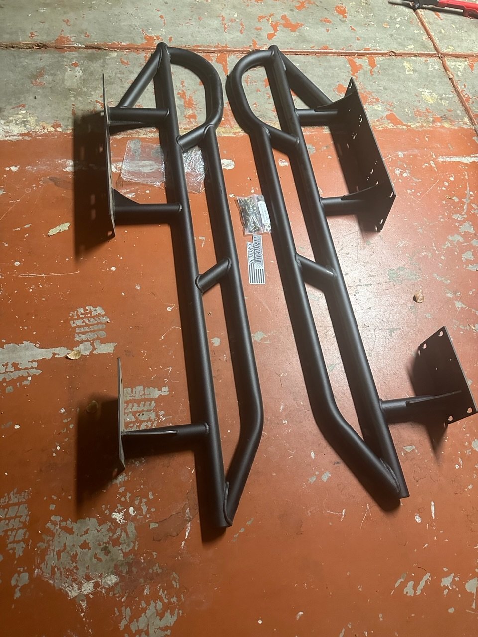

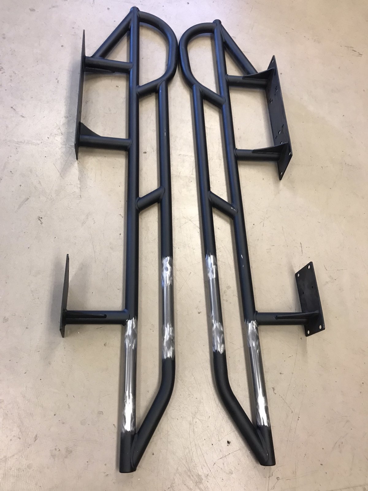

    Another project off the list! Extended these 9" and sleeved the joints. I'll worry about an added attachment point after we get them fit up. Shouldn't need it, they are pretty solid and will be welded on.

    I would add a little leg between the the inner and outer main tubes

    Hell ya man, they look fantastic! Can’t wait to get them on and get you started on the next project :D

    Would probably help, they are .120 wall, I ran the sleeve the full length of the addition with 3" over each side (15" sleeve 9" add). Wouldn't hurt :welder:

    Gonna help with them trying to twist on each other.

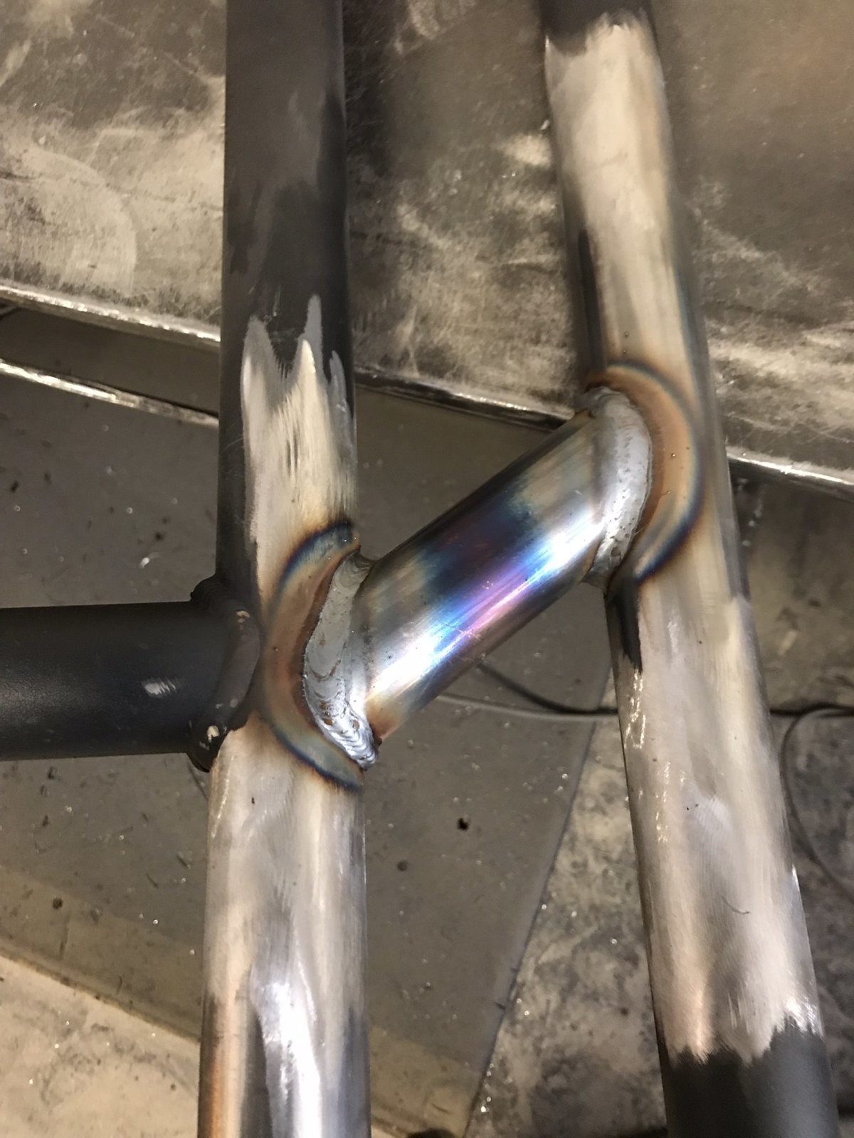

    Makes sense, added it this morning.

    Lookin good :benchpress: I’m excited to smash em in to something!

    Mmmmm, BUTTAH. Welds look great man.
