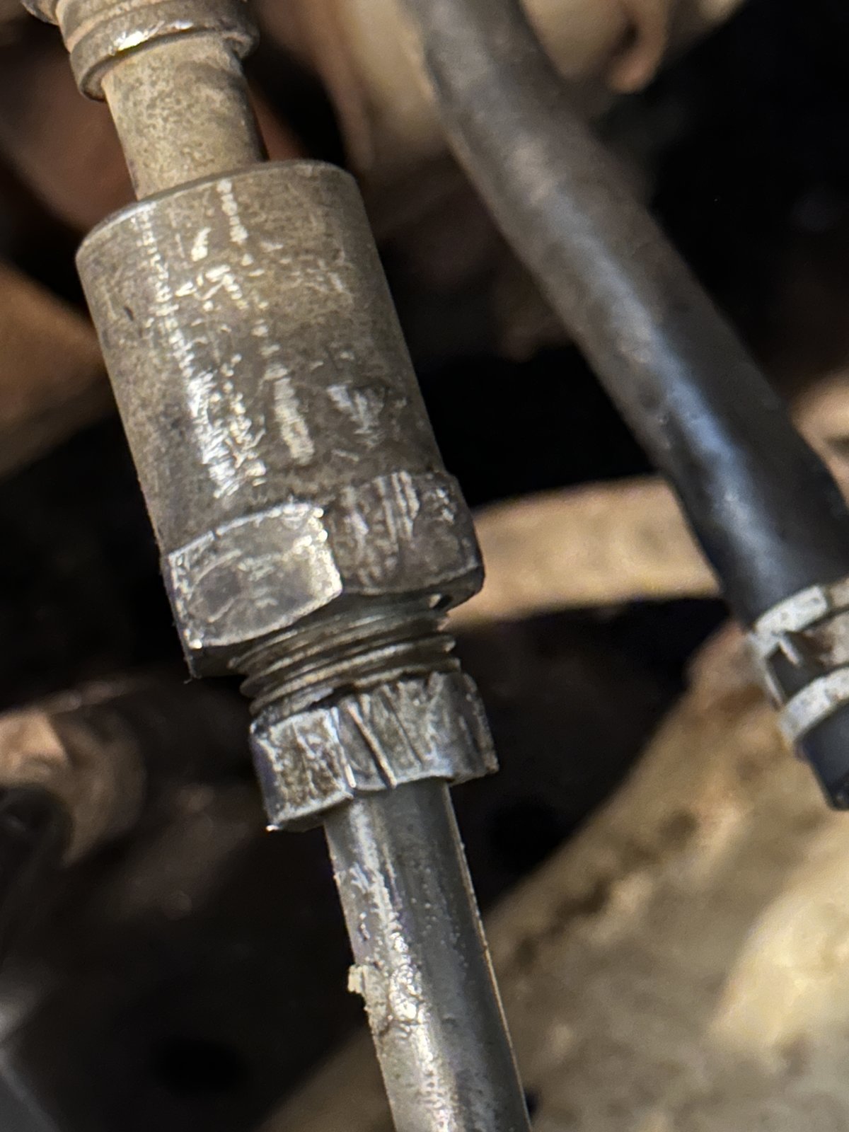

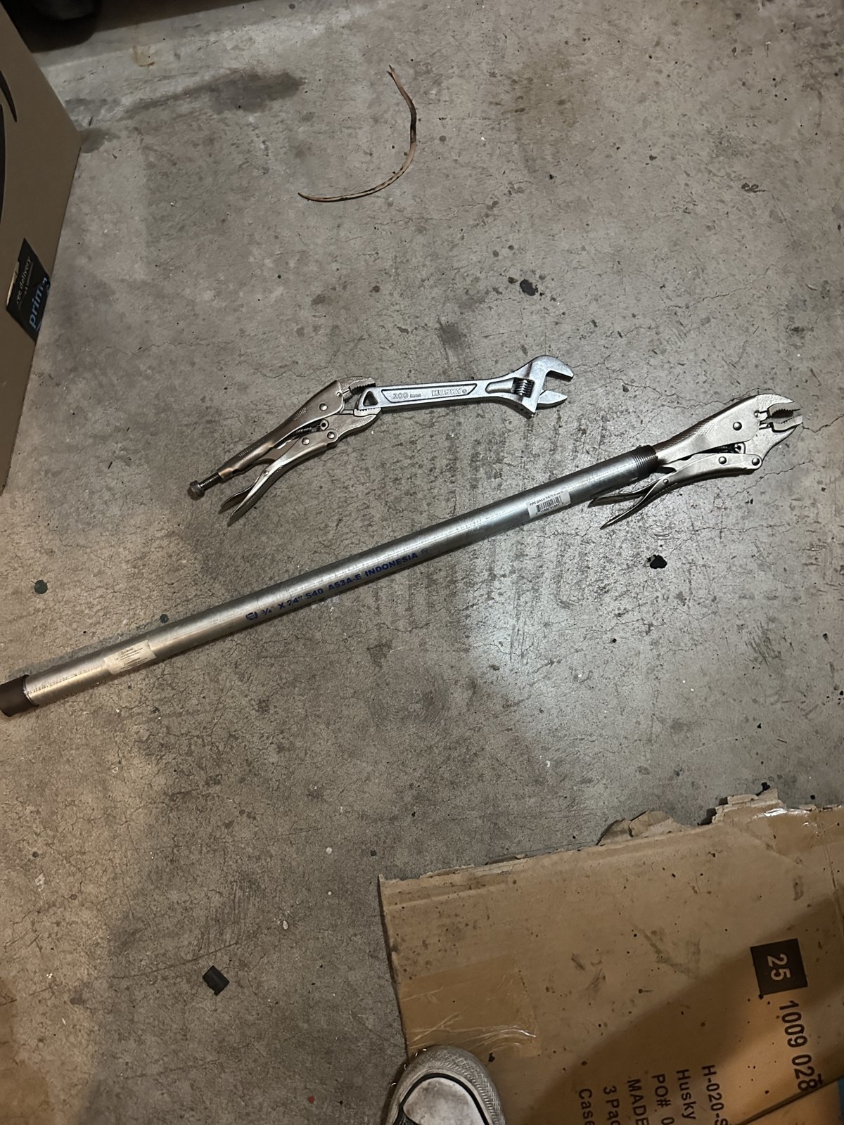

    Big ass vice grips were the answer.. not exactly what I’m going to do when I go to put the truck back together, but thats future me’s problem

    My first thought was pb blaster, let is soak, then hit it with some heat, but then I reread your post.
    I dig the "f - it" bar

    Torque = Force X <length of application arm>
    MFing-Torque = Force X 3-ft-of-application-arm

    have you tried heat?

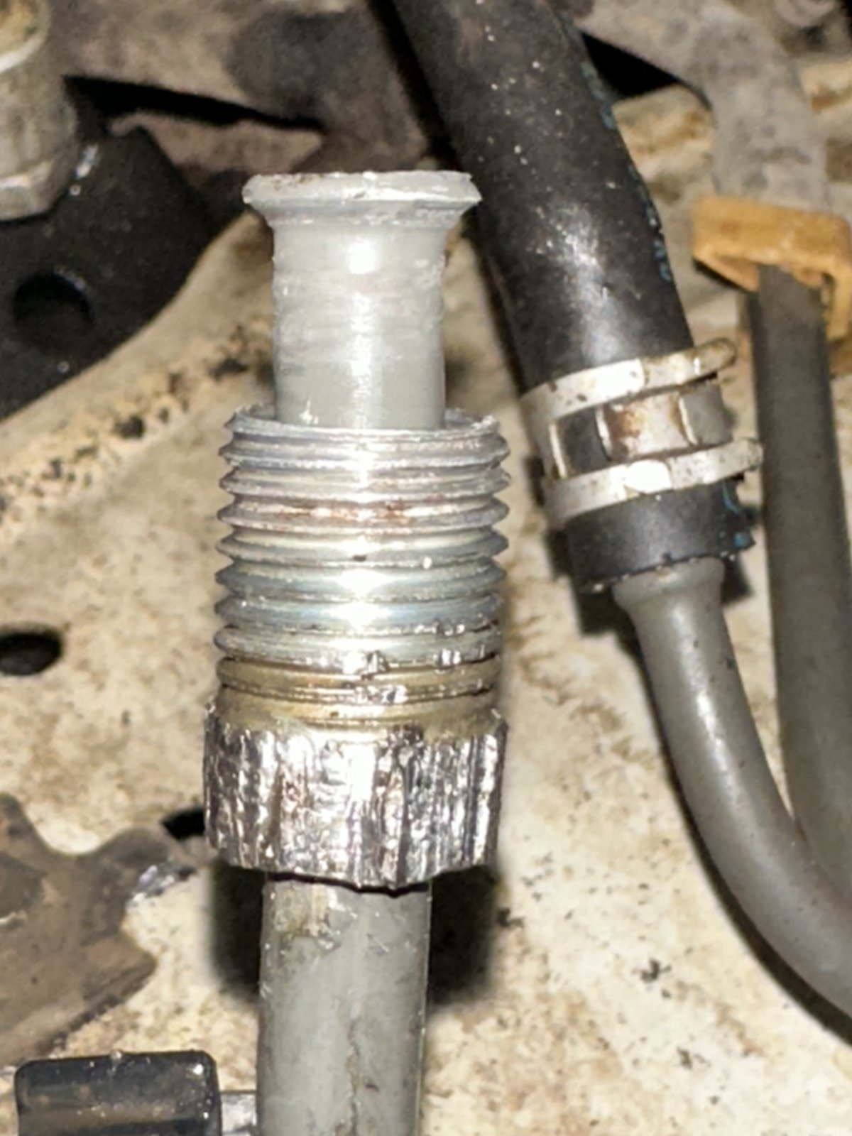

    I had to cut out and splice in a new section of hardline for my rear brakes years ago. Ended up needing the last like 4" (flared end and nut just like in your photo). I used a compression fitting to splice in a new flared end onto the line and haven't had a single issue with it. Just in case you do end up needing to cut/replace..
