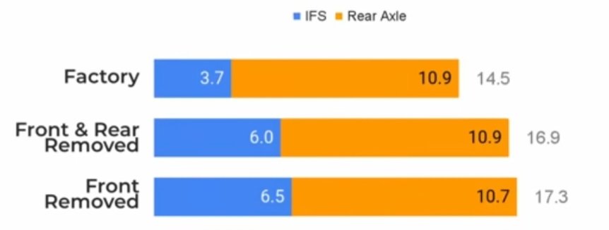

    Bizarrely it looks like the best combo on the runner is no front sway and leaving the stock sway bar in the rear. The slight amount of flex you lose in the rear is made up for by more flex up front because it keeps the vehicle more level.
    There's a YouTube channel that tested this with travel ramps and everything.
    The IFS up front is basically the same as the Taco.
    This all depends on how I feel the car handles when I ditch the front bar, really. With my OEM suspension on the Taco it was sketchy, with the Fox 2.5s I had it was exciting but gravy.

    Oh man, is it this guy? I haven't seen the video yet, but have seen some of his others. I love how he approaches his experiments and how well he articulates his process and results to his audience.
    https://www.youtube.com/watch?v=gcgKbUTQJy8

    Yup that's the exact video I clipped from.

    That's a great video, I just finished it. I was doing something similar on my truck, where I had 500 lb coils on my long travel front but slightly stiffer leafs than necessary in the back to try and give it some balance. That other FJ in the video with the custom rear sway bar is pretty killer.
