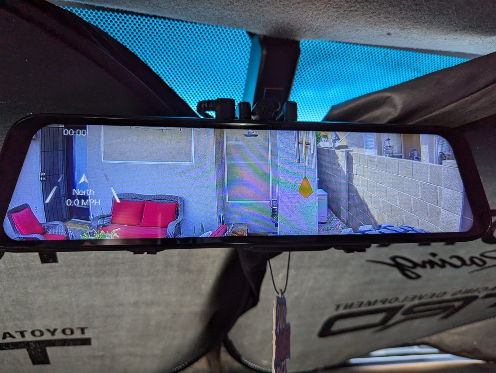

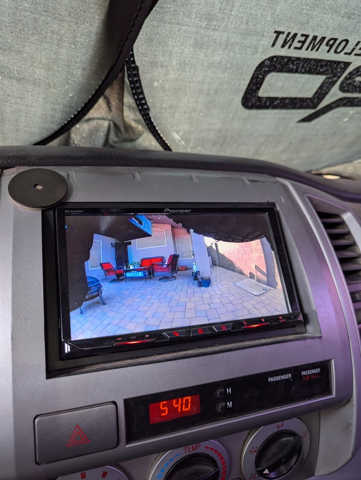

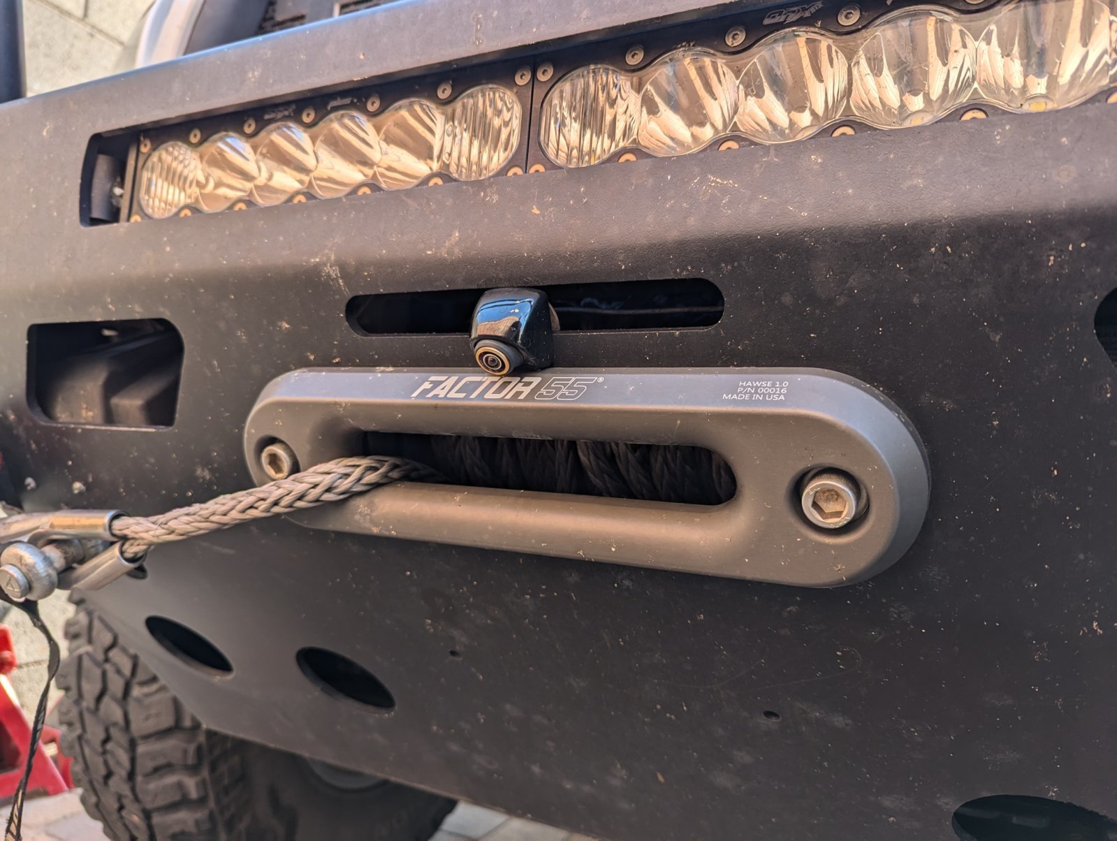

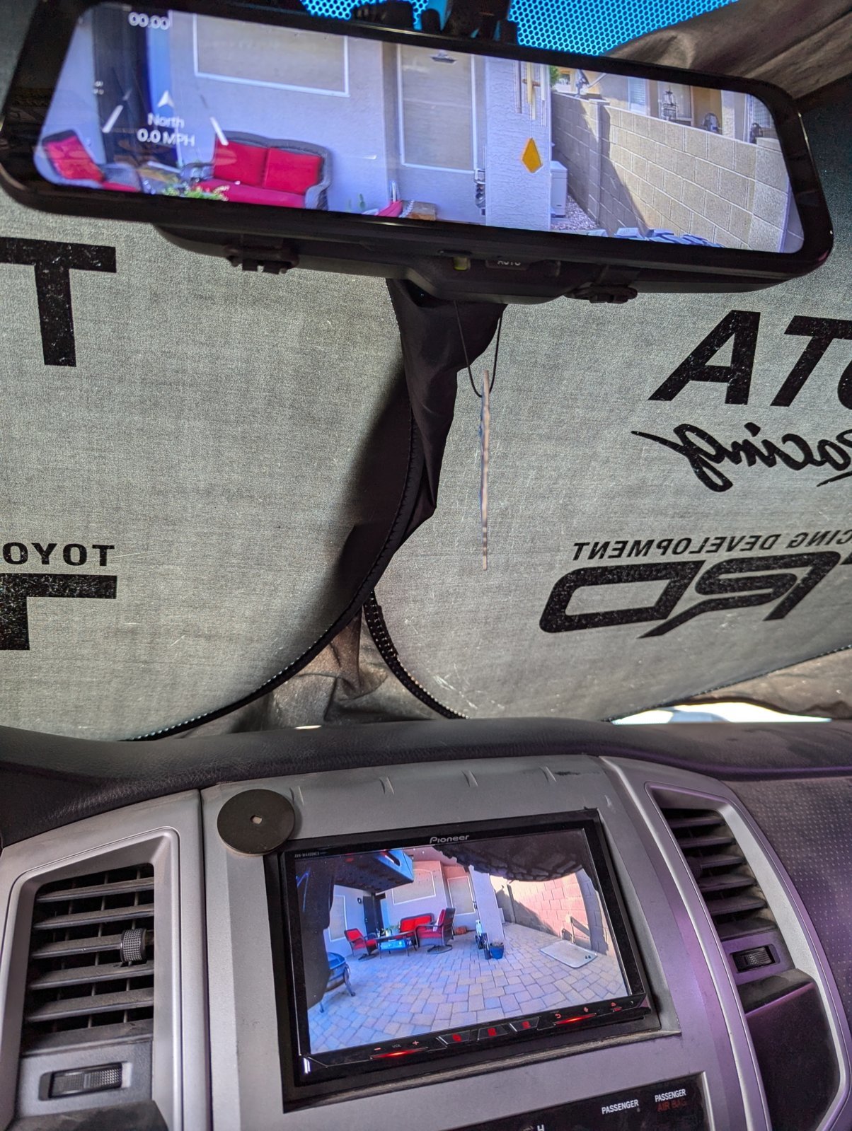

    @shaggy135 I'll snag a couple pics when I get home. I have my rearview camera for the wolfbox mirror mounted high, up on my camper/3rd brake light for an overall/down the road view behind me + I have my factory backup camera relocated to my bumper and re-wired to display on my headunit when triggered by reverse signal. So, now I have a fulltime digital rear view/display to mimic the standard rearview mirror characteristics, plus a 2nd, better view for reverse. With both views being displayed at the same time on 2 different screens, it pretty much covers everything. The wolfbox also has its front facing built-in "dashcam" pointing forward.. and then I added another front facing camera to my bumper for a trail cam. So, 2 cameras facing forward (one in mirror, one in headunit) and 2 cameras facing backwards (one in mirror, one in headunit).

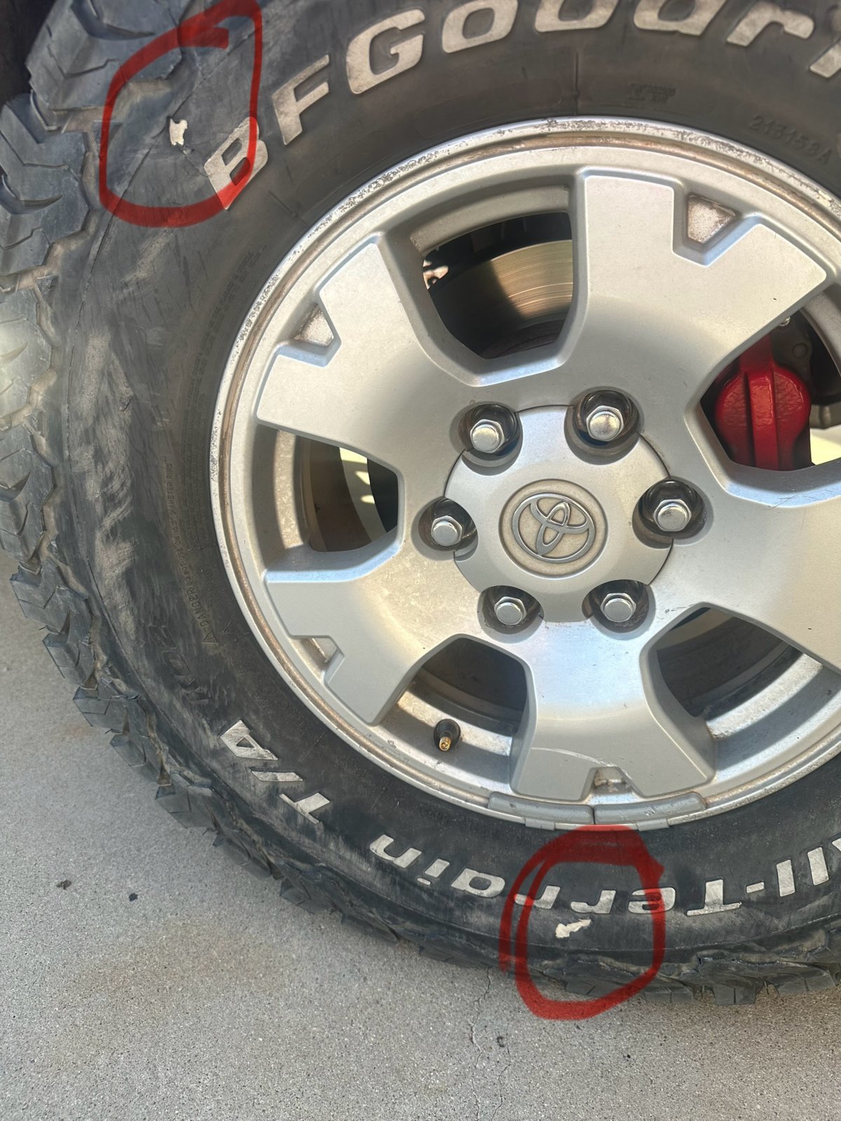

    Seeking guidance on tire damage. Have a few of these sidewall gouges on both front tires where rubber is gone and whatever the next layer is, is exposed. New tires are on the menu anyways but want to understand if this is a “replace before next big trip” situation, “replace before next trip to the grocery store,” or no big deal?
    For context tires are ~3 years old and only have ~8k miles on them, but plenty of off-road use and truck gets parked outside in the sun.

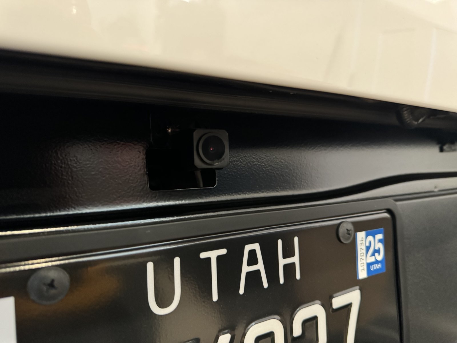

    Still running my rearview camera in the spare tire hole, and it works perfect on and off road...needing my spare is a last resort, but the camera just rotates up out of the way if I do.

    Not the greatest example since it's parked in the backyard right now.. but..
    Wolfbox cam (display is adjustable Up/Down and set to JUST see the spare tire and JUST above the horizon/down the road)
    Backup cam (bottom/aftermarket one, the top one is factory just relocated, all are separate from each other)
    Both (reverse trigger)
    Front camera

    I don't do strap-ons, so was happy to find a mirror replacement that actually works and has a vertical adjustment...bonus it has a forward facing dash cam, too
