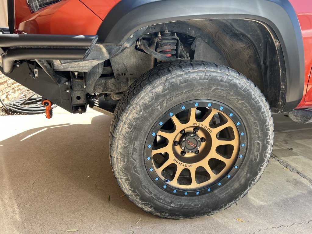

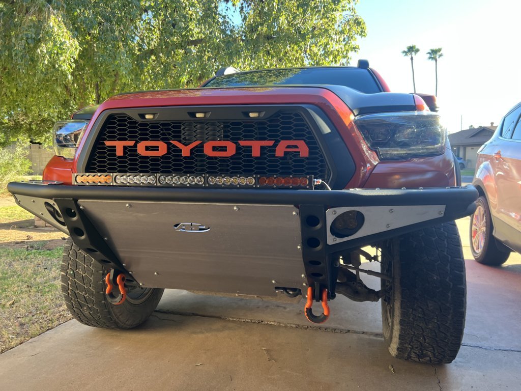

    that looks great
    it seems pretty light weight , did you sag at all ?

    Just my .02… get a bumper that’s 3/16 not 1/8 like the new RR. Lots of good companies to choose from.

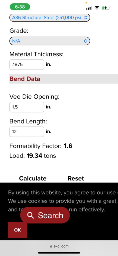

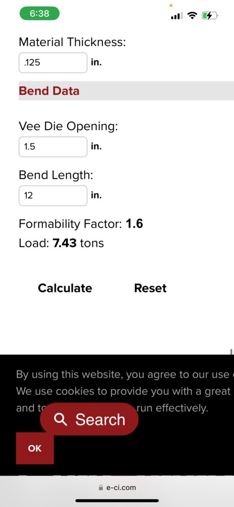

    Interesting point.
    Does that extra 1/16 of an inch make a big difference?
    I am trying to balance cost, weight and durability

    It makes a pretty big difference. Here’s a photo of the tonnage required to bend it in the same size die.IMG_3692.png IMG_3693.png

    that’s wild

    They claim 80lbs. With a floor jack and some creative use of my knees I was able to install it by myself. I honestly couldn’t tell you on the sag. I changed up the suspension same time.
