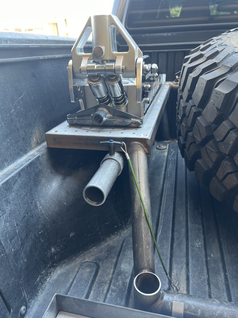

    Spring load mount is done. Tried uploading a video… not sure how to do that though lol. Works good though.
